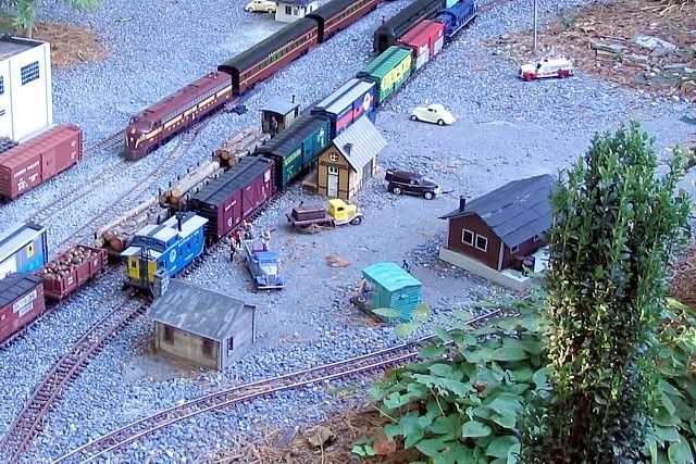

Don"t do it. Polymeric sand has a metallic component to it and is attracted to magnets. Just a little bit of it in a motor could chew it up in no time. You can buy the organic binder separately. I do use it for roads/paths mixed about 50/50 with stonedust as seen in the work yard area here -
(http://i113.photobucket.com/albums/n214/altterrain/forums/workyard.jpg)
-Brian
