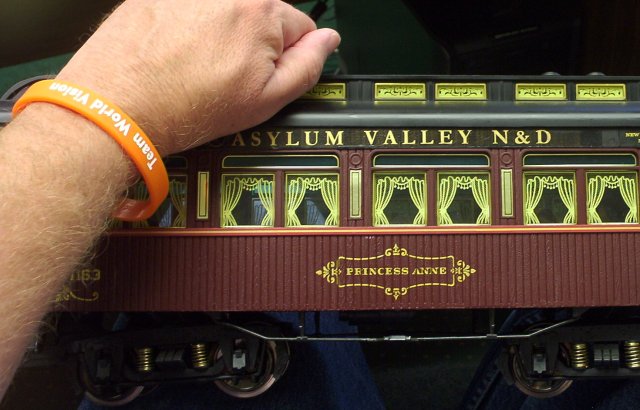

I did the same over gold on my coaches. Just use word to print “White on Black” and print onto clear decal paper. I’ve got a photo somewhere…
(http://www.outsidetrains.com/mls/twv.jpg)
