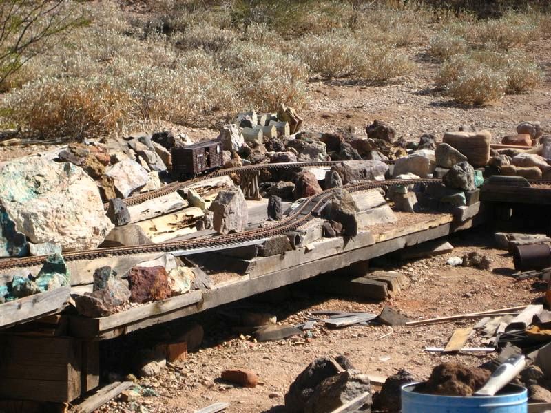

Rocks on the move …
A little ballast changes how everything looks … the rocks must stop their advance until I get the bridges built and this is my last way out!

Rocks on the move, upward bound!
Above I added ‘shore’ boards and larger rocks are lining the high line. The lake here may be done with the blue stained rocks … but the washes are going to dirt.
Above added more profile planks and a floor … The High Line rises a mighty .75 inches above the lowly Narrows line.
I mounted the back board on a 60* angle so there is plenty of room for my rocks… the dark area in the fore ground will be rocked in.

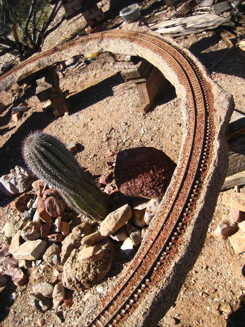

Until I can build 16’ of bridge, I settled on a floating fill.
Mix; large dollops of TB III, water and fine skreeded dirty gravel. Slop on wet with trowels like tools…
The corners will be covered with recycled cribbing to make them look purpose built. Like platforms on trestles.

I’ve not used an indoor technique outdoors before. Last night was a good test, it rained most of the night. Only the fill was glued with dilute TiteBond III, the ballast is loose. The mine donated the Shale for ballast, so the price was right, if the ‘rock’ wasn’t.
I built up lips of fill to contain the ballast.

I used the drywall knife as my shovel and the thin flex blade as my spreader oner. I worked from the top down while spreading from the bottom up. About 3 apps per. The base is slanted so each section stands on it’s own and the top is feathered into the above section. No sections sloughed off! (https://www.largescalecentral.com/externals/tinymce/plugins/emoticons/img/smiley-laughing.gif)
