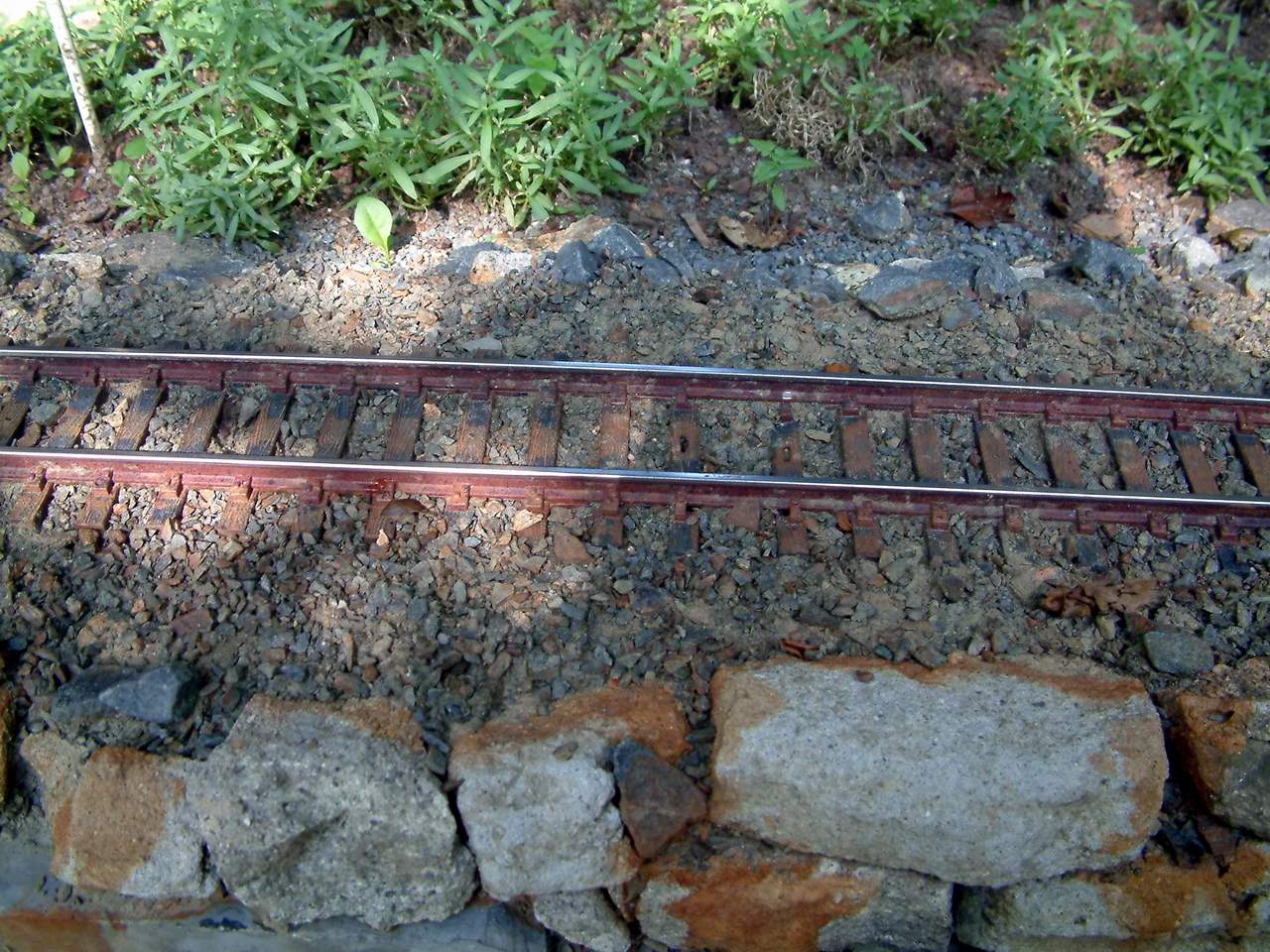

I paint my SS track using a variation of method Marty Cozad posted several years ago. I use a mix of Krylon Ruddy Brown primer and spatter it with flat back to darken it a bit. I documented the whole process on my website, but here are some selected pics. [url=

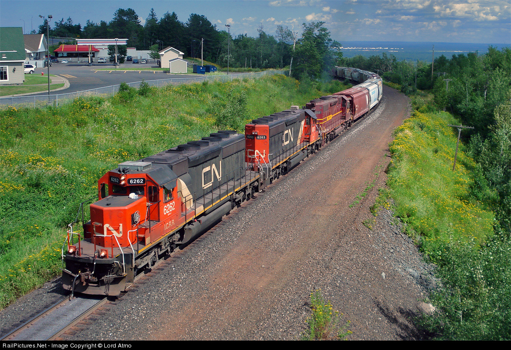

I appreciate the input, but the color is still too red for my taste. The era I am trying to model is the late steam/early dismal era. Back then, there was a lot of oil on the track, giving it a grimy black, sometimes spotted with green from all the oil that dripped off the journals. That is the track I remember from my youth. Even today, track is not rust colored, unless abandoned. Go take a look at the nearest mainline, or even branchline. You won’t fine rust colored rails. Both from www.railpictures.net
(http://www.railpictures.net/images/d1/8/5/8/8858.1218174665.jpg)
(http://www.railpictures.net/images/d1/8/5/2/8852.1218175214.jpg)
Note in the first pic, how the sides of the rail are grimy black, and in the second, the rail is almost gray in color.

Steve - I respect your color opinion, but consider the differences in color film from the late 40’s and early 50’s compared to film and digital today. No doubt in the yards and station areas, the all sides were nearly black from oil, but out on the main I would think it would be a bit less. I was born in the early 50’s and didn’t start hanging around railroad tracks until the late 60’s, and that was on barely used branch lines - so what do I know :smiley: In your modern photo the color is a combination of the red/orange rust color and dirt that is toning it down. I think Richard has it nailed as far as color goes, but I’m lazy and don’t want to spray that many colors. I used an old spike for a color guide when darkening the red primer. Like Richard suggests, my colors wary due to the amount of black over spray I add… [url=
