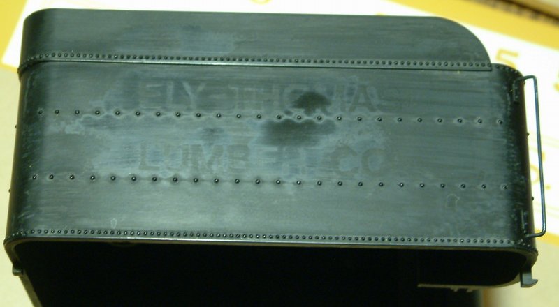

I’ve used the 91% on a Bachmann Shay tender tank. It didn’t take much work to remove the lettering and most of the paint ; there was some ghosting of the letters in the plastic, but that disappeared under paint.
