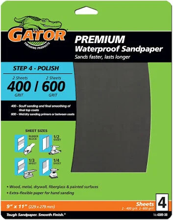

No need to strip the whole car but if you are talking about the CSX boxcar, the logo will very likely be seen through the new paint. Get some 91% Isopropyl alcohol and 600 grit waterproof sandpaper. Puddle the alcohol on a portion of the CSX logo, wait a few mins, wet the sandpaper with more IPA then sand to feather the edges. With a bit of work you can remove all the graphics in this manner.
