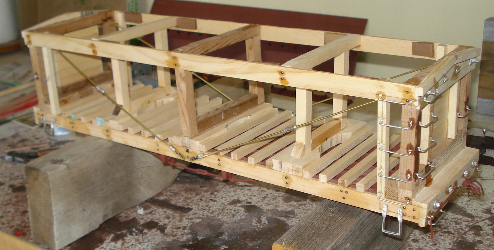

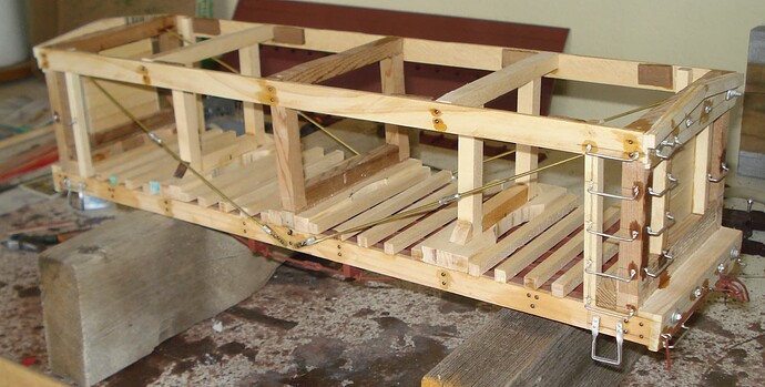

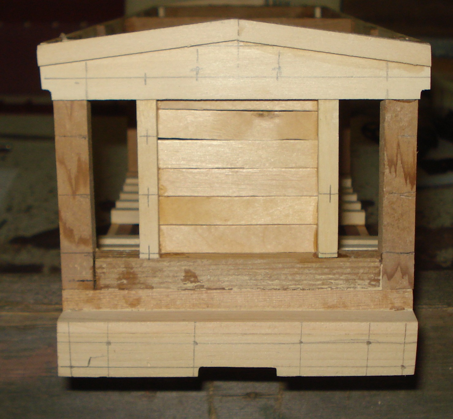

Once I got to looking at the car body I decided it needed one more change. I partially covered the open ends. I could not find a picture of this on any of the prototype cars but it is fairly common on other models.
pick 47

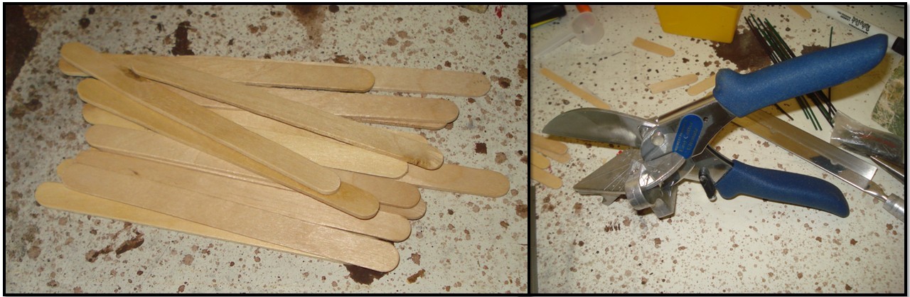

I cut some Popsicle sticks to length using an Easy-Cut tool. First time I have used it. Worked great on the soft craft wood. Its a Boomer build, you knew Popsicle sticks were going to be involved at some point. Glued the pieces on the inside frame and sanded the ends smooth.

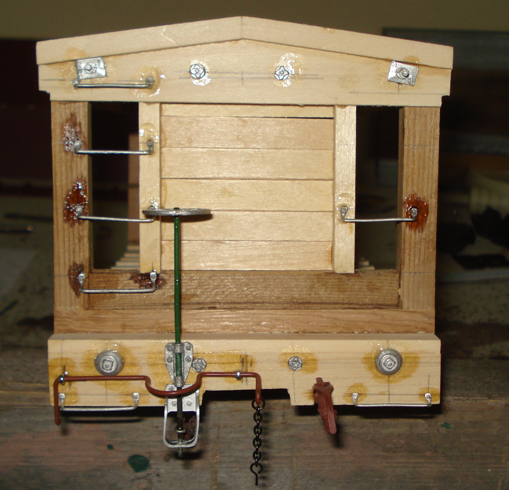

While the glue dried I sorted and prepared the metal details for the ends. I think these are Ozark miniatures but I have had them so long I cannot be sure where they came from. Some measurements and marks were made on both ends of the car.
A lot of pin-vise drilling to get the holes ready. Finally the pieces were glued in place using Locktite super glue. I am not crazy about the pewter castings for the grab irons. I will have to tweek them to get them straight. Not sure how well they will hold up either. It takes very little pressure to bend them. May have to replace them with brass rod.
I will hit the end with some clear acrylic to blend in where the super glue bled out. Now onto the sides.

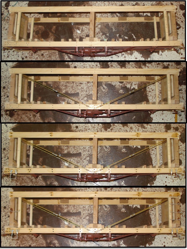

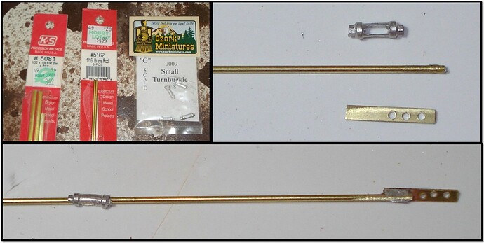

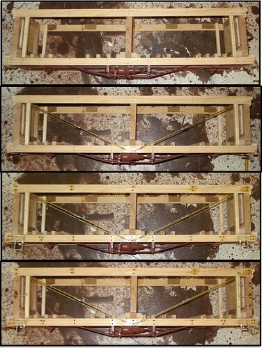

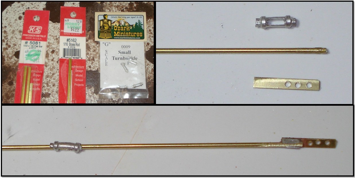

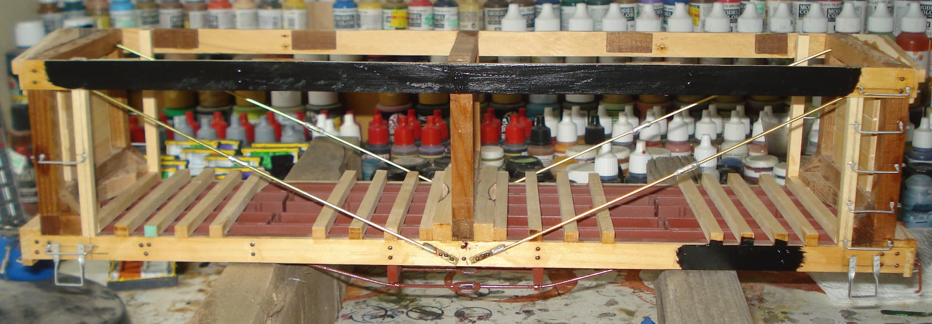

Time to do some soldering. I am using brass stock for the tension rods. These will be similar to the ones shown on the Hyman car.
These extend from the center diagonally up and through the end cross member of the frame. They are tightened using a turnbuckle in the middle of the rod.
Three holes are drilled in the brass stock. That end is cut off at 3/4 of an inch. Brass rod 1/16th is soldered to it. The turnbuckles have to be drilled out as the ends are solid cast. They are then slid on and glued in place. In real life these would be threaded holding two separate rod sections together. I am going to paint the center section of the rod black to hide it. Keeping it in one section will make it stronger and straighter.
The car sides are all marked and holes drilled.
The tension rods go on first. They are inserted into the holes on the backside of the NBW plates on the end.
All the carriage bolts (HO track spikes) are glued in. Most of these had to be cut in half so they did not protrude out the other side.
Finally the stirrup steps and grab irons are added.
I am still not sold on the grab irons but I am going to go with them. I did try drilling out the ends for possible use with track spikes. It went okay but the leftover NBW was hard to file smooth. It’s just to much work for the result.
I was able to gently pick the car up from the table without them breaking off. Guess that will do.
Looks like the car body is ready for paint.

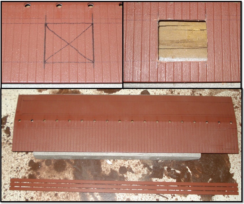

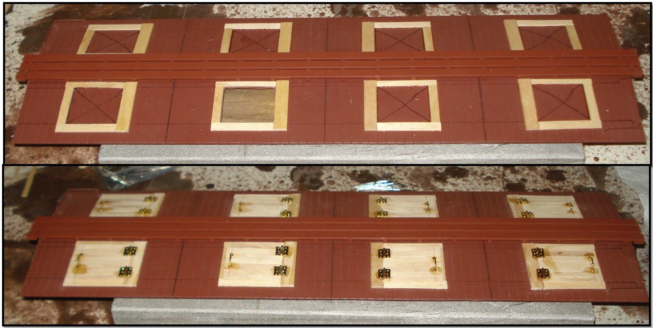

These last couple of days have been all about the roof.
First to go was a 1/4" off each end. Several of the prototype pictures show the roof being shorter than the body. I guess because the supporting cross members sit a few inches inboard from the end sills and it would make climbing on the roof difficult. I shortened the walkway to match.
15781789_1172394582856934_1680974148193492350_n

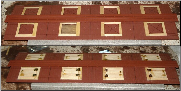

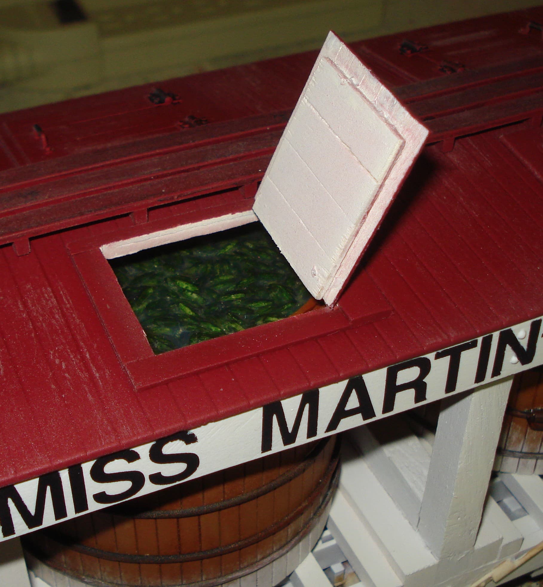

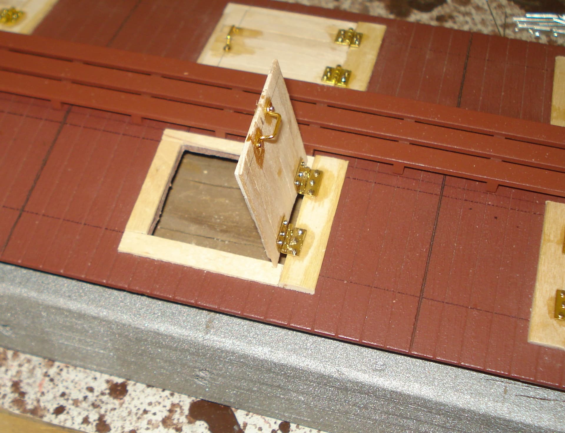

After marking it up for the hatch positions I started cutting the hole for the one operating hatch. A little patient hacksaw work did the job.
Frames and doors added. After some finish sanding I was ready for the hardware. These are dollhouse items. Cabinet butt hinges and window handles. The bolts are straight pins. They have a slightly smaller head than the HO track spikes and I am hoping it will make them look like smaller bolts. More drilling fun. 110. Not as bad as the triple dome but It was a lot of small work.
At first I tried to mark and drill the holes, then add glue and insert the pins. Way to fussy for caveman fingers. I found it was easier to glue the brass parts on then drill the holes through the openings. A lot of tiny work with needle nose pliers to get those pins in place. Once they were ready I dropped a little more super glue on top to hold them firm.
My operating hatch had to be babied to keep glue out of the hinge area. Now I can look at my pickles at will. And I will look at my pickles. Because they are my pickles. No one can stop me! NO ONE I SAY!MWAHAHAHAHA!
A little clean up and it will be ready for paint.

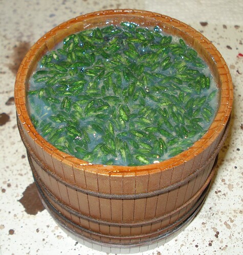

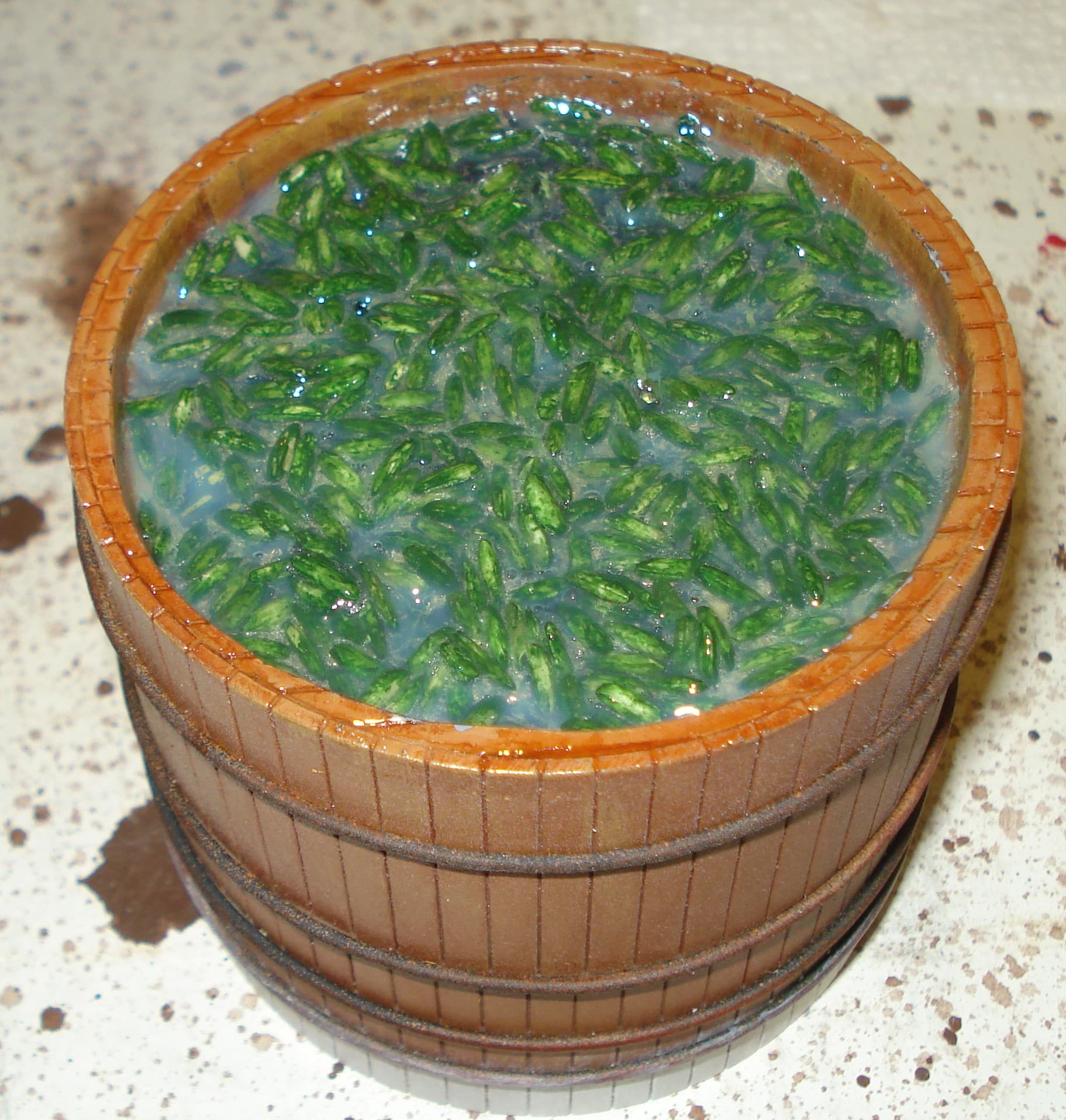

Pickle tank finally has enough varnish in it and no bubbles.

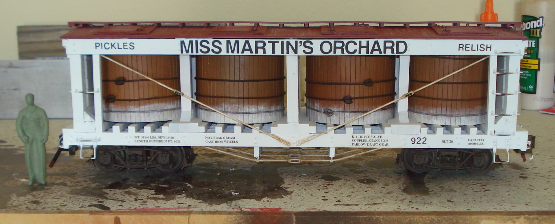

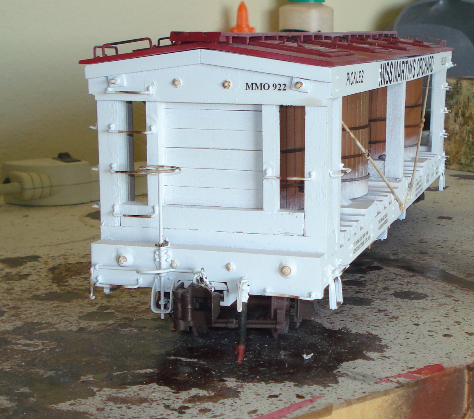

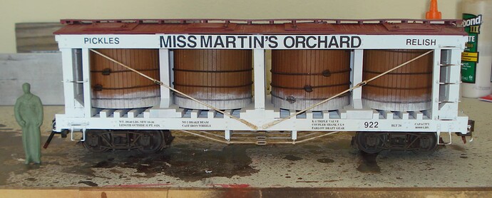

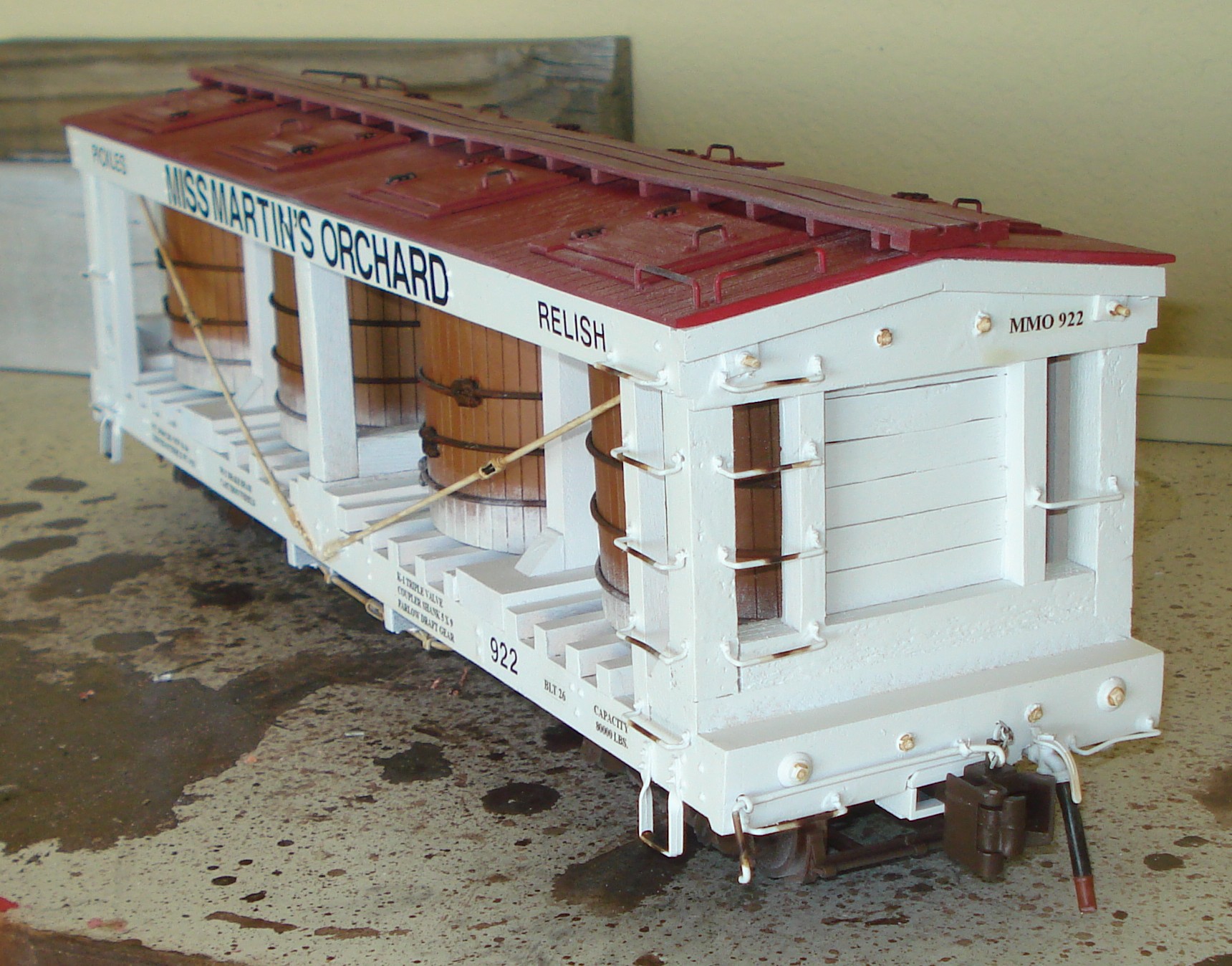

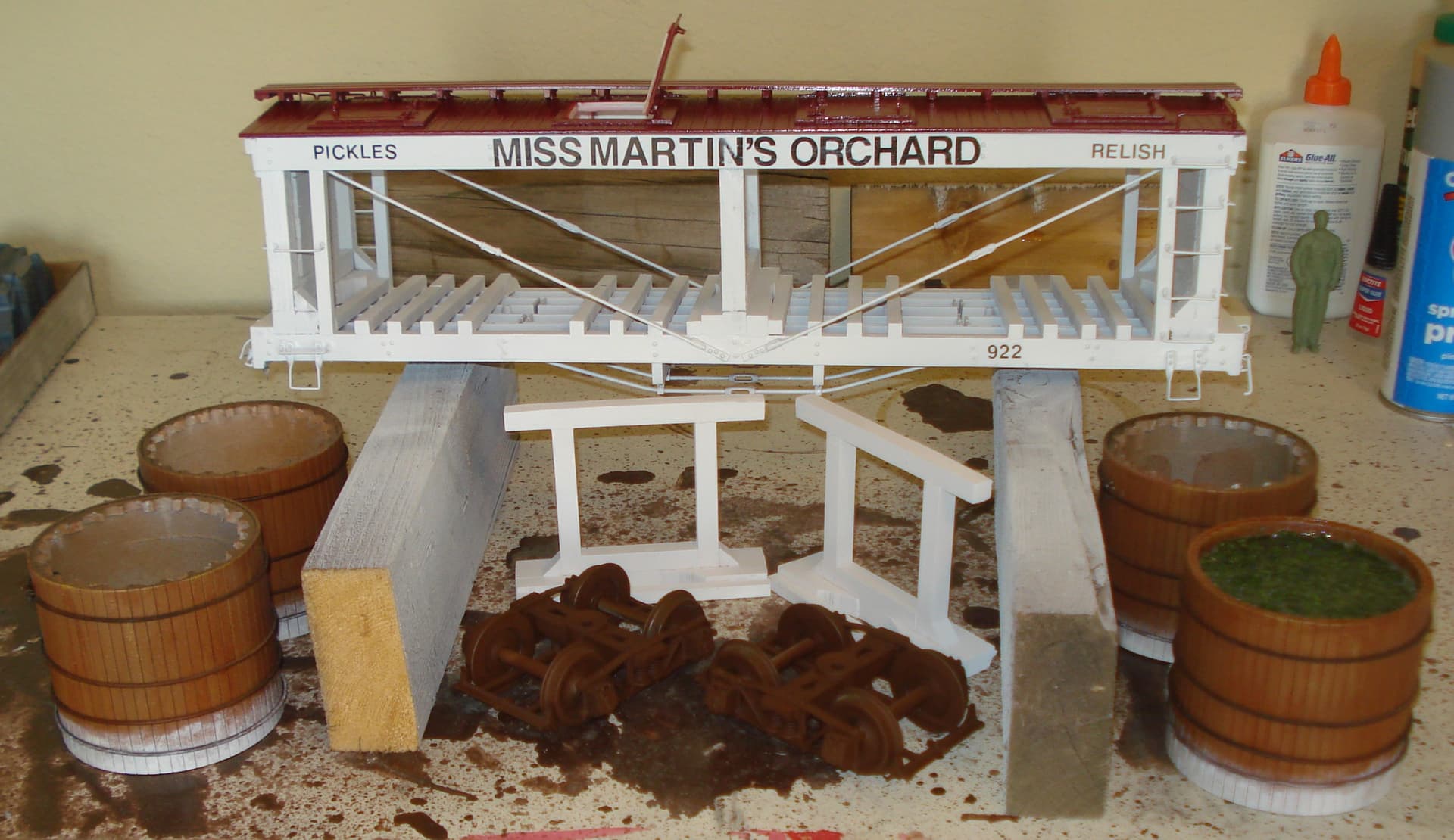

Decals applied, modest weathering complete, ready for reassembly.
Pickles are ready to go.
The tanks are held in place by a screw from underneath. The roof is glued on with Elmer’s white glue in-case I ever have to remove it. Right now the opening hatch is still popping up a little. I figure it will lay flat with a little use.
The car is surprisingly heavy. Not sure why.
This is as close as I have come to a full scratch build. I don’t see myself making another car body. Gonna stick to kit-bashing.
All in all it is a cool car. Glad I finally finished it.
