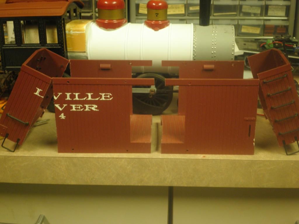

First off, the foreman grabbed the power saw and jumped in, the following injuries incured

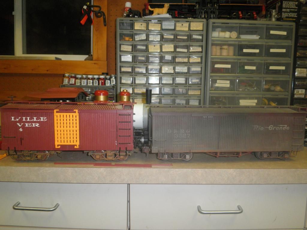

They were in such a hurry to get it started that they didn’t even notice the missing trucks or lack of doors!! A quick search of the yard found a pair of LGB Disconnects, so while the foremans back was turned, they were quickly brought into the shop to substitute, and a pair of old cattle car doors were also found, thought they are fighting hard to get the smell out of that wood! After an hour of surgery, the car was back on its feet!
And here it is with its Bachmann brother, a standard boxcar

Love it! The disconnects make right nice looking trucks.
What’s the story on the loco in the background of the first photo? The Bellpaire firebox is reminiscent of Newport & Sherman’s Valley #7.

That reminds me of the D&RGW early fruit and veggie cars. Short box car with Cattle Car door for ventilation, with Air Scopes on the roof in the corners.
What size in feet does it measure out to now?
I’ll try to dig up a pic to show you the vents. Would also help with the heat thing if the vents really worked.
Thanks Kevin, the disconnects work great, and with the original undercarriage removed the box sits perfectly on the log bunks without modification.
Love that locomotive Kevin, I think I may see a future kitbash project! Never seen a Bellpaire firebox on a narrow guager before :smiley:
The loco in the background is turning into standard guage Illinois Central #382, it is being built on an Aristocraft Pacific drive, more on this project soon :smiley:
Dave, while I was building it I kept thinking of the similarities with the early fruit cars of the Rio Grande.

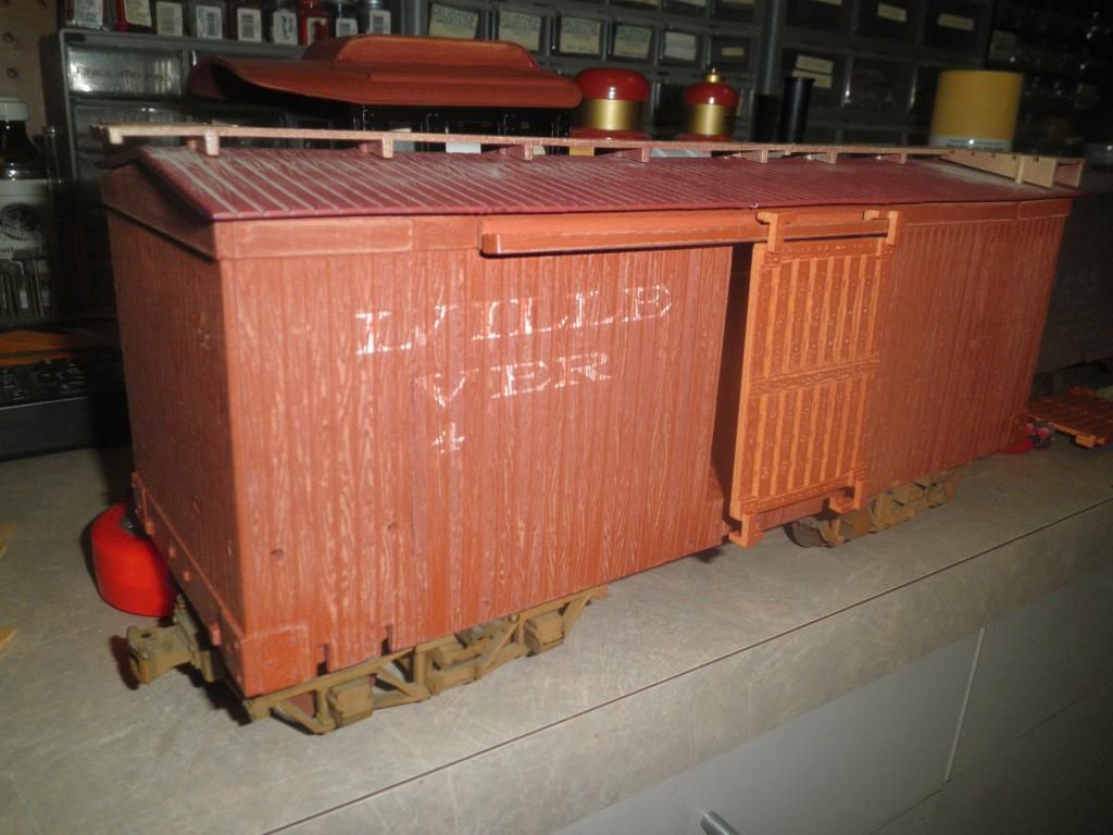

I cut 1 1/2 inches from each side of the car, shortening it to a scale 24’
That looks good. I like that it sits a bit higher and the door is distinctive.

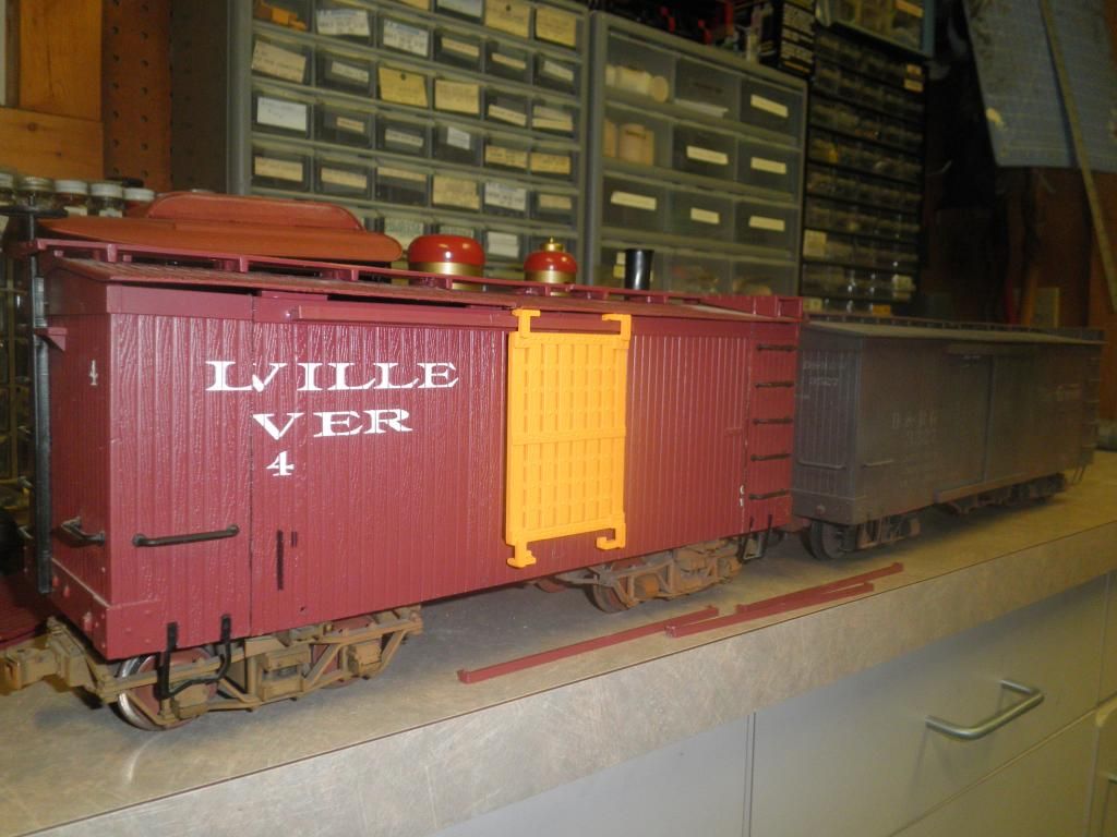

Some painting was done today, thought I had to share the yard with the ducks lol

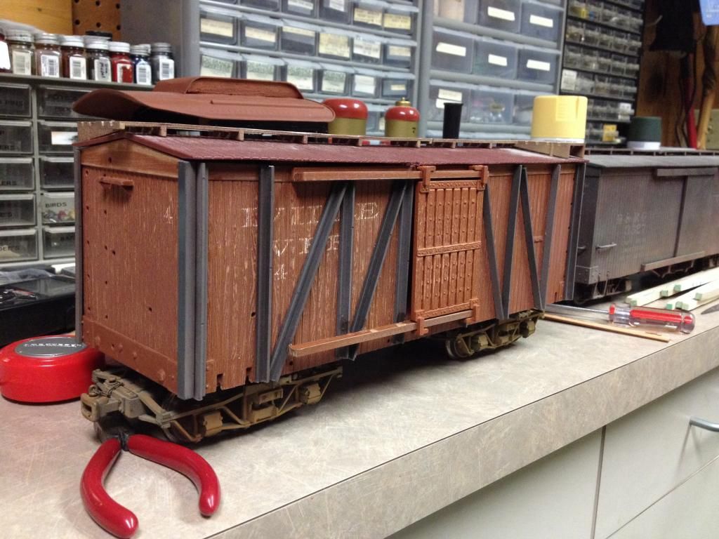

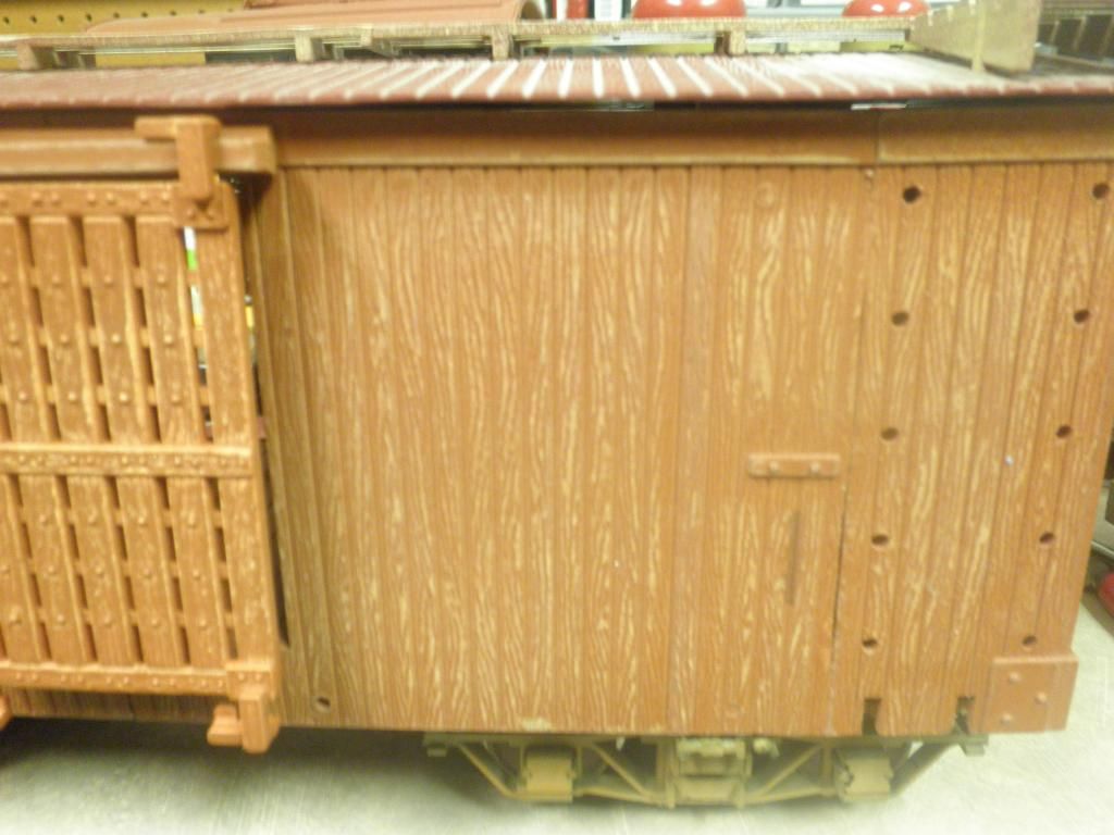

I decided to leave the special roadname on it just to get people to guessin. I painted a wood color spray over the carbody and then red primer. I then took a fine grit sandpaper to it and lightly sanded it back down to replicate fading and chipped paint. I will finish it with a wash or two. Here is the result so far
Next up is a new roof, and then outside bracing to make it interesting :slight_smile: But before further work commenced the crew had to quickly move it back inside. The International Association of Roundy Round Runners has caught wind of a new car being built, and they aren’t happy to hear of so many corners. There has been talk of a picket, but time will tell. to be continued

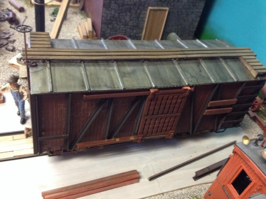

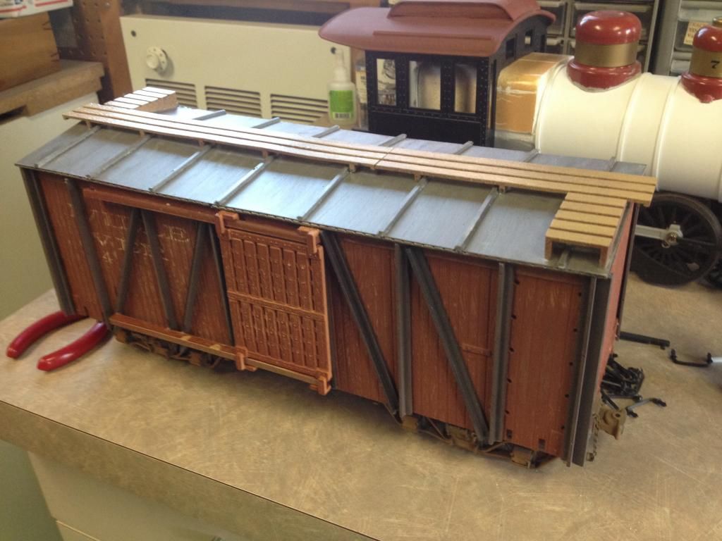

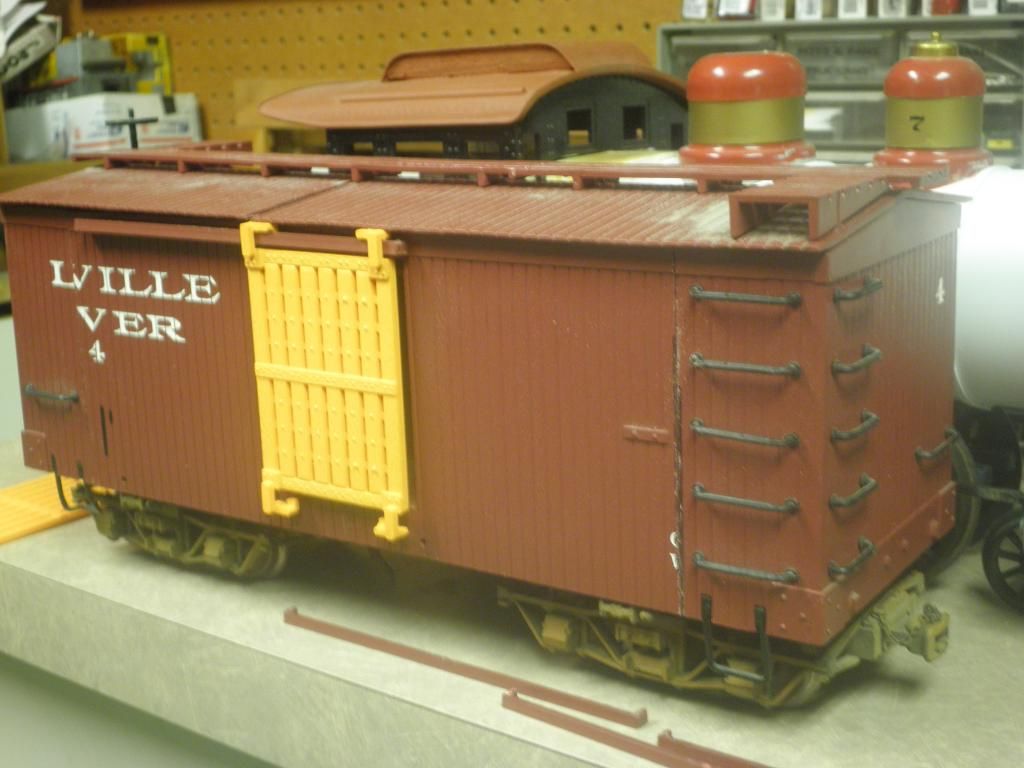

The car has taken on a new look! Outside bracing was finished on the sides and doors installed

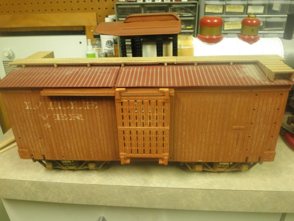

Today it got its new roof! I decided to leave the original roof in place and just put another one across the top of it. Used sheet styrene and square stock to create a sheet metal look.
and after some paint
Next onto end bracing, handrails, and weathering :slight_smile:

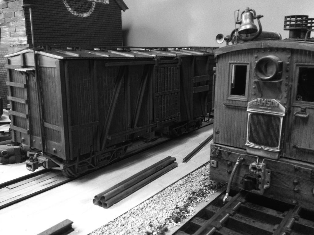

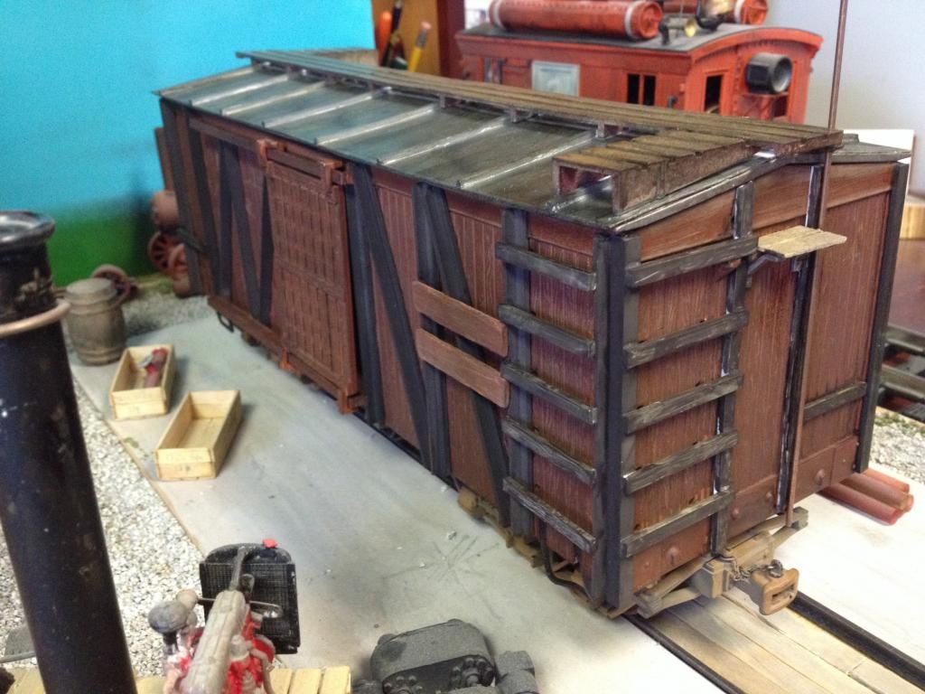

Thanks Joe! Work was completed on the car last night, this may very well be a record for the boys in the shop around here. The finished car was pulled out into the yard at Mik’s Salvage for a couple photos
And here is sits in the yard with Boxcab #14 waiting for its trip into the tall timber
Thanks for following along, this has been a fun project. Now onto finishing a couple more and clearing the bench for this years annual Mik’s Build Challenge :smiley:
