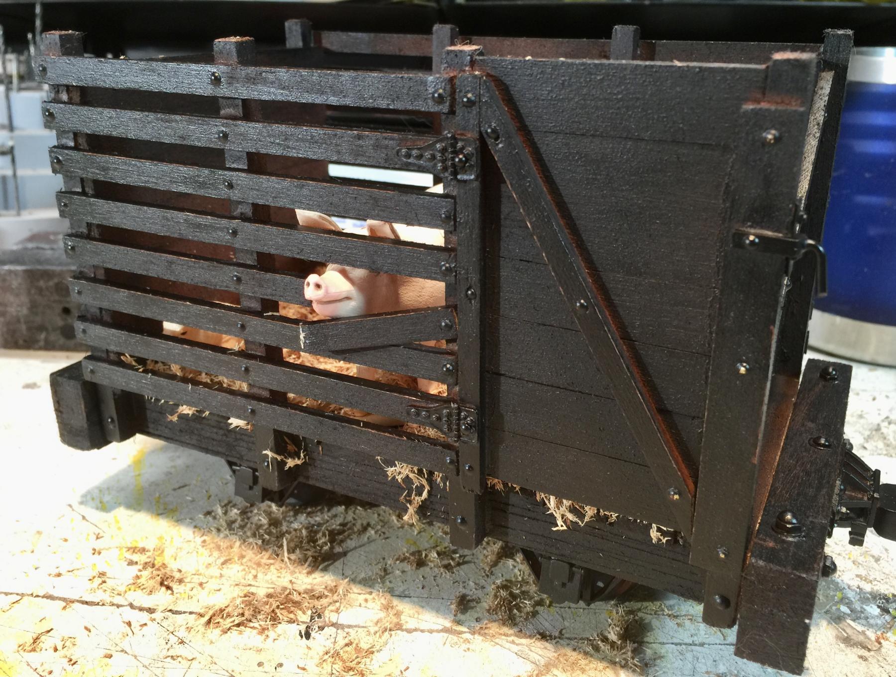

Latest 7/8 project. A shorty pig hauler.
Don’t forget Charlotte, John (https://www.largescalecentral.com/externals/tinymce/plugins/emoticons/img/smiley-wink.gif)
A bacon bus…(https://www.largescalecentral.com/externals/tinymce/plugins/emoticons/img/smiley-wink.gif)
Looks Great Now all you have to is get them pigs dirty …
Thanks, Guys.

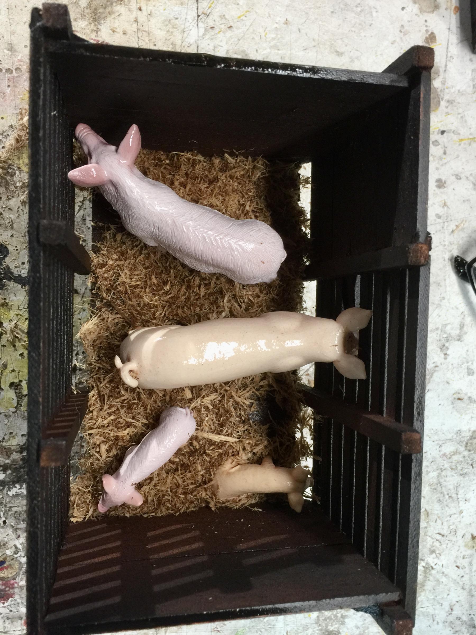

Once I figure out how to get the “straw” glued down, I’ll filth those swine up.(https://www.largescalecentral.com/externals/tinymce/plugins/emoticons/img/smiley-laughing.gif)
I’ll drip some diluted white glue from an eye dropper. that should hold it.
John,
I love your attention to detail. The broken board with the pig snout sticking out is perfect and not something most would do.
Great work.

When I made some HO log cars and needed bark and dirt stuck on I just used the thinest CA I could find and painted it on with Qtips and then sprinkled it on. The after the first layer dried I blew it off then painted on more CA and rinse and repeat. By doing this you can unevenly layer debris. May work for the straw.
I thinned out some white glue and poured it over all the straw. (Pigs, too. (https://www.largescalecentral.com/externals/tinymce/plugins/emoticons/img/smiley-foot-in-mouth.gif))
It dried clear and worked great. Shook the loose stuff off and she’s good to go.
Oh, BTW, I made the straw by shaving a piece of scrap cedar with a horse shoer’s rasp.
