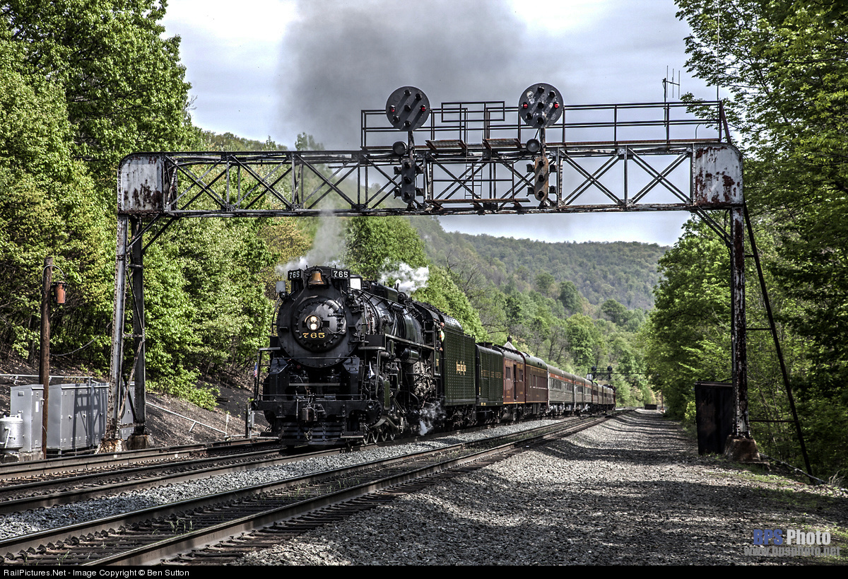

OK, now that I understand what yo were trying to portray, let me offer this… Give the train somewhere to go. Back up a bit, either physically or with “zoom,” so that there is some empty track in front of the 765. If she is underweigh, slow the shutter just a bit and pan, so that the background is blurred a bit, and more importantly, the rods and wheels are blurred, just a bit. That will give the notion that the train is moving more than anything.
This photo by Ben Sutton illustrates the “give the train somewhere to go,” principle. It is almost the same as your photo, 3/4 aspect, fireman hanging out of the window, train behind, but the difference is that the 765 now occupies the left 1/3 kine, and she has somewhere to go. Something that is missing here, that appears in your photo, is the flotsam and jetsam of the cast off rails. Attention to detail is important. The folks at RP only take the best of the best. If you want to be published there, pay attention to what you see in the viewfinder.(http://www.railpictures.net/images/d1/2/9/5/2295.1369015223.jpg)
JD, this is not meant to be a put down. You have a good eye. With a few tweaks, you can do it.
