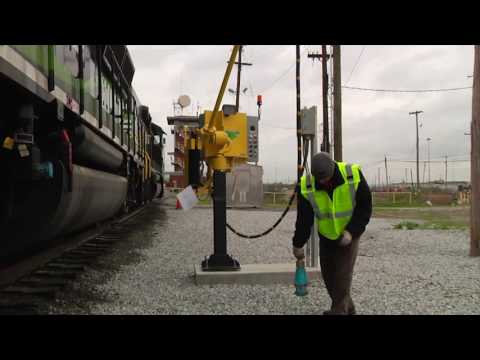

I was assuming there was a time when oil was cheap and other engines were converted to oil. I stumbled across this discussion about battery operated steam engines. No, don’t roll your eyes just yet…
Most of the discussion talked about impracticalities tender full of batteries, but they did mention the Swiss famously replaced their human hostler with an electric one in the early 1900s. And reportedly, the Norfolk and Southern use something similar called a sleeper for their diesels.
(Aside: Does the BNSF use sleepers @ctown2 Craig?)
Electricity to help run a Steam Loco
@Dave_Taylor Dave, Is there any practicality to using solar panels on the roofs during the day to charge a battery to run an electric heater to keep these boilers water near boiling at night? Might be cheaper than building a new boiler?
This discussion mentions that there’s an American steam engine running on used cooking oil too. And isn’t that a conveniently located McDonald’s next to the D&S in the photos? Any thoughts on engaging the town folk to contribute this otherwise waste product to the cause?
Not sure what you mean by a sleeper?
The BN for a while in the mid 80’s to early 90’s ran what was called fuel tenders. Basically a big tank car full of diesel and placed between locomotives. Fuel and MU lines connected everything. Supposedly it was to save fuel costs because they could buy it cheaper in some places. But it was over complicated and the fuel tenders developed cracked frames from all the horsepower pulling and shoving on them.

Here’s what I came across on the Norfolk & Southern “sleeper system”.
I also found out a bit more about steam engine boiler heaters. In the early 1900s, Switzerland pioneered the use of electric heaters to maintain steam engine boilers at optimal temperatures during idle periods. This innovation arose from the need to prevent steam engines from cooling down completely, which could lead to operational inefficiencies and delays in restarting machinery.
The electric heater, often referred to as an electric boiler feedwater heater, was designed to keep the boiler water at a constant temperature, ensuring a swift and efficient startup when needed. These heaters typically consisted of electric heating elements immersed in the boiler water, controlled by thermostats to regulate temperature.
They are still produced and a Canadian company makes them.
