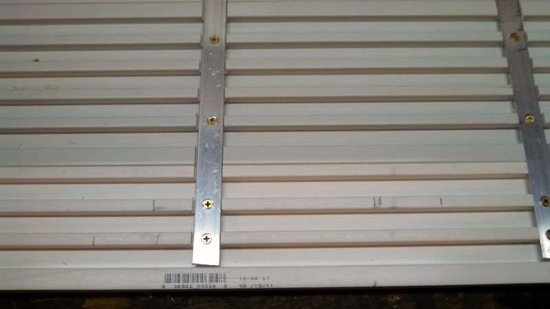

So, out with the old old and in with the new. I picked up a couple pieces of vinyl garage door molding that measured 5 3/4" wide and 5/8" thick. It’s ‘supposed’ to be rot proof warp proof and UV protected, we shall see. I cut the pieces to length & ripped one to get the right width. On the bottom I routed some channels to put some flat aluminum stock I had in for support and screwed the whole thing together with brass screws.

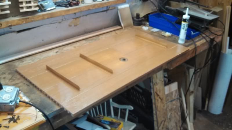

It will get painted brown and also get some support braces on the top once the station is placed.
You might want to change the flat alum. stock to angle stock. The PVC board has a tendency to warp out in the hot sun.
I’ve made 3 station platforms from the stuff and the widest ones needed the angle braces to keep from warping.
Just a heads up…:wink:
The top braces will be angle braces. I wanted to keep the bottom flat so it would sit flush on the ground. The building itself will work as a brace too. It also covers about 90% of the platform so most of it will be out of the sun.

Got it painted and the inside braces put on. The hole in the center is where the power comes in.

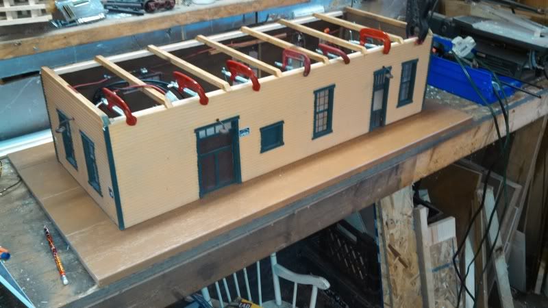

Station attached. I added some more bracing to the building and did some rewireing. I just need to touch up the roof.

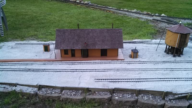

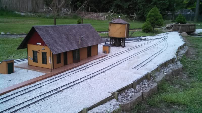

Here’s the finished product, the station is gonna need some new windows though…
(http://i73.photobucket.com/albums/i231/paintjockey/IMG_20130516_202210_441_zps553778a9.jpg)
(http://i73.photobucket.com/albums/i231/paintjockey/IMG_20130516_202224_040_zpsc9503958.jpg)
Terry
Terry, that looks nice… :slight_smile: Layout, too
I like it!..:wink:
Nice work Terry. The scene looks good
Looks Great!
