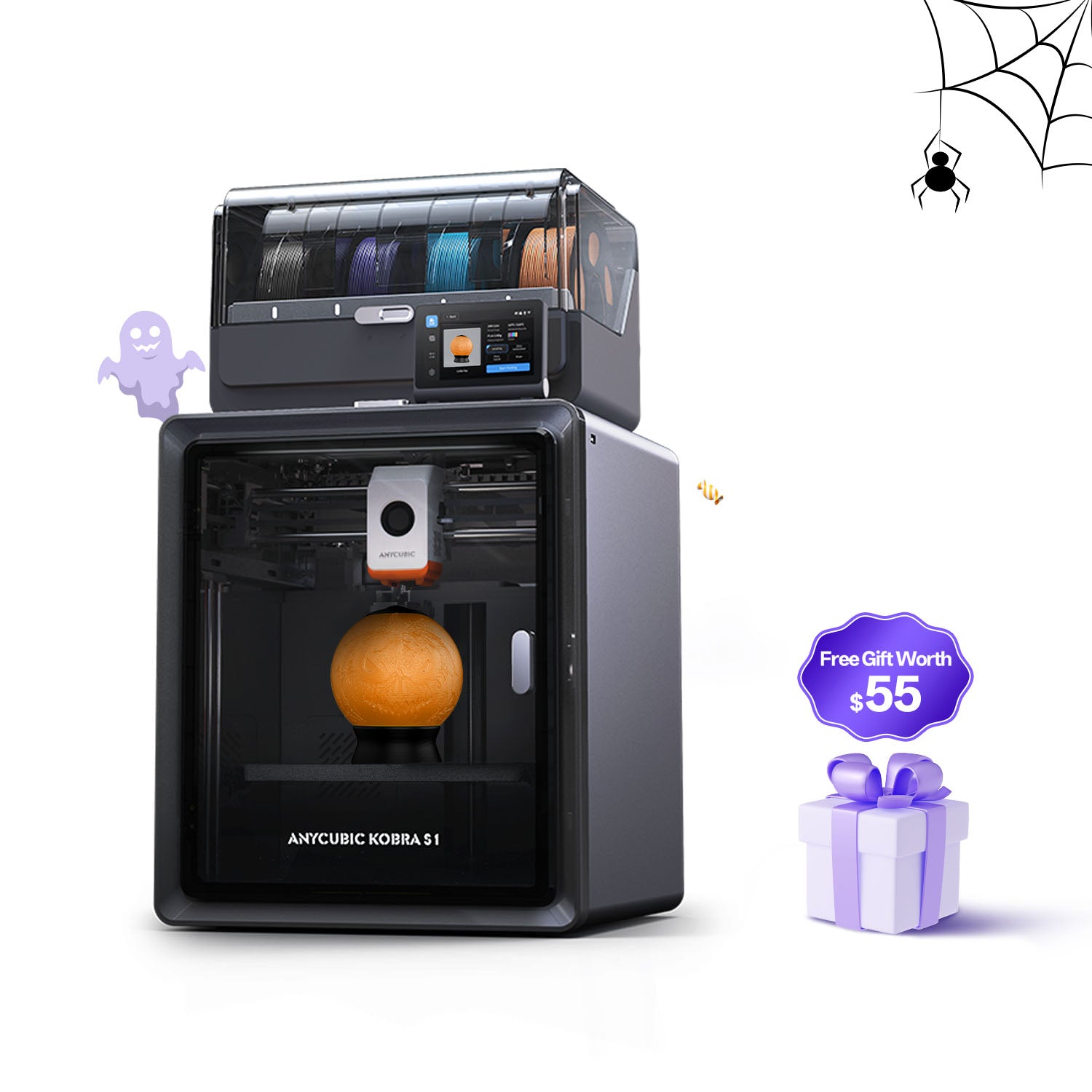

Today I learned that Anycubic is gunning for this marketshare, and is now offering this:
They’re almost deliberately offering theirs at half the price of Bamboo’s equivalent, and the specs seem similar.

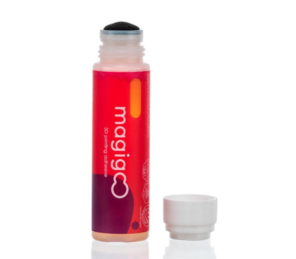

Screw-ups are most typically caused by poor bed adhesion. The print will cool and pull away from the table often rising in the process and then obstructing/misaligning the print head which then ends up printing garbage.
Todd,
Have you tried Magigoo? It is heaps better than glue sticks.
I haven’t needed acetone or isopropyl alcohol to clean the bed since using it. It can be easily washed off the bed too, so you won’t get build up.

Hines, just a matter of having the bed really clean and set at the right temperature. I use Goo Gone followed by dish soap and that works well.
