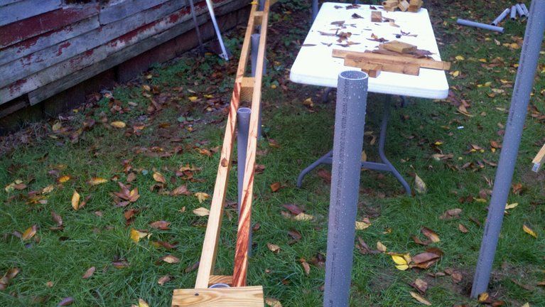

here’s an pverview of the backside with the access hole. The deck will be for visitors to load their trains. [url](http://i73.photobucket.com/albums/i231/paintjockey/photobucket-14275-1349525089423.jpg)
[/url] This is the decking. I’ll trim it so it will be a smooth continuous curve. [url]
(http://i73.photobucket.com/albums/i231/paintjockey/photobucket-21389-1349525090473.jpg)
[/url] This is the framework I made. It’s ripped down 1 5/4 deck board with 2" PVC conduit for legs. [url]
(http://i73.photobucket.com/albums/i231/paintjockey/photobucket-24341-1349525088892.jpg)
[/url] Here is the opposite side of the grade. [url]
(http://i73.photobucket.com/albums/i231/paintjockey/photobucket-21949-1349525091013.jpg)
[/url] Like I said, the grade is about 2%. The structure itself is very secure. I weigh 275lbs and can walk the length of it. But, rainy dreary day here so no work… Terry
Terry, what is the radius of your curves, about 5 feet?

Ric they are 5.5 radius. 11’ is all i could fit between the barn and property line.

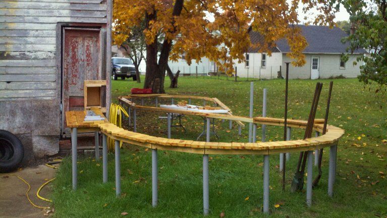

Finished the framework, had a minor accident that could have killed me but that is another post. Think I may lay off work for the rest of the day and celebrate life.
(http://i73.photobucket.com/albums/i231/paintjockey/photobucket-11599-1349799530511.jpg)
(http://i73.photobucket.com/albums/i231/paintjockey/photobucket-17593-1349799529054.jpg)
Gap to get the mower in. I’ll put a swing top bridge in there.
(http://i73.photobucket.com/albums/i231/paintjockey/photobucket-13713-1349799529947.jpg)
Talking to friends and contractors I don’t think i’ll do anything but stain the wood. A fellow firefighter & contractor who does mainly decks said he never does and still puts a guarantee on his work. He found the walminizer didn’t prolong the wood life for any significant in this area. I do appreciate the heads up and opinions though. Terry

Terry, Since you are in celebratory mood of not suddenly ending your life, take advantage of the moment and save yourself some time and anguish by turning the inside of that loop into a rock garden, flower garden or pond and eleminate the cutting of the grass there forever, instead of making a bridge so you can get in and cut the grass, If not for yourself, do it for the environment. My goal is to eliminate the running of lawnmowers one blade at a time. More goats, less mulch. Another idea, would be a compost pile, but they sometime get smelly.
No worries Ric, I have a rotary push mower.
The ultimate goal, some decade, is to build it all up and fill it in.
Terry
