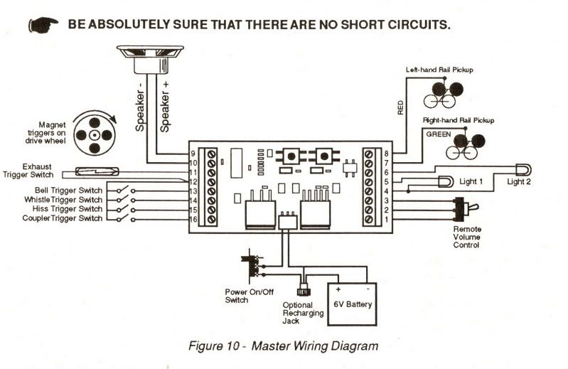

Does any one have the pin configuration of the Sierra Soundtraxx board, I can’t seem to find mine (the wife must of put them up)
Thanks for all the help.
Herb
This what your looking for?
(http://i253.photobucket.com/albums/hh58/rgseng/Other%20stuff/Sierra01.jpg)
Thanks Ken that should do the trick!
