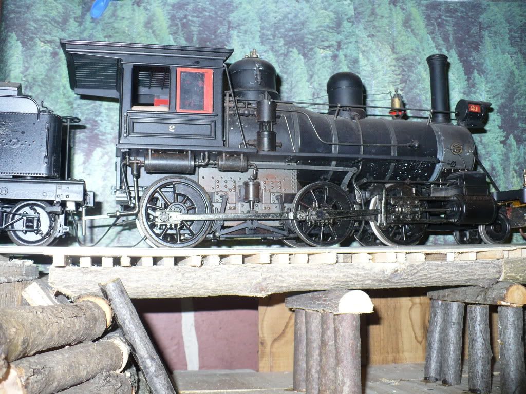

I was at our model train show yesterday running my climax ,with 5 logging cars&bobber.I decided to run the 2-6-0 give the climax a brake , well it made it around the loop twice and died sounds like it has striped the drive gear(as you can hear the motor sing) .what can i do to get it fixed or can i regear it to match the rearing of the climax as my line is not a high speed railway and it would be nice to be a bull to use it as a helper on my steep grade

this is the loco i got
(http://i280.photobucket.com/albums/kk200/scooby19784/trainsetpart4023.jpg)
Oops I was wrong. That’s the 1:20 Spectrum mogul.

Try this:
some Spectrum Locos (that is one) tend to loose screws at the bearing that holds the geared axle in place. As a result, the gearwheels slipp over with a sound. My Connie had that, too.
Would be easy to repair: just fix the unfixed gear-house on the bottom of the loco with a small screw (or with 2 or 3 of them…depending how many said “good bye” yet).
Frank

Steve,
The most vulnerable part is the gear on the axle. It is exactly the same gear that fails on the Connie. Not similar, interchangeably the same. So this is my best guess. And it can be repaired.
Remove the gear and axle from the gearbox and all of that Stephenson valving (remember/photograph how it was or came apart).
Slide the gear off of the axle. Notice the hub is the same on both sides of the gear. There is a K&S brass tube which fits nicely over the hub. Make two slices about 1/8" thick, clean up the burrs on the brass, trial fit the slices. Mix up a small batch of JB Weld (the 24 hour stuff). Put the epoxy in the trough on both sides of the gear, then press the brass slices into the epoxy. Smooth up the sides, notice the time and come back in 24 hours. Clean up any of the epoxy. Reassemble.
Barry - BBT
I’ve done two of these, one for a Connie and one for a Spectrum 2-6-0.
