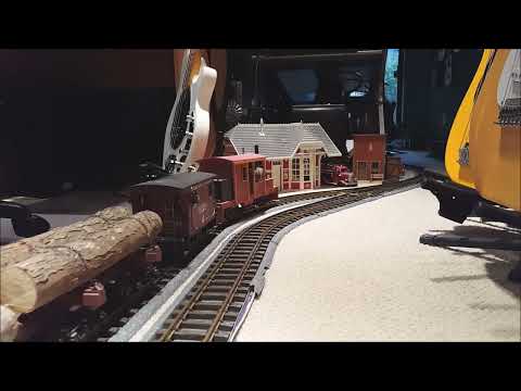

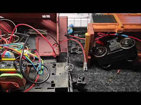

My recent dead rail battery conversion with Poor Man's Throttle (PMT) and scratch built Class A Climax
I built this Class A Climax over 15 years ago. It has never run well on track power. However, now with this latest conversion to dead rail using the Poor Man’s Throttle (PMT) it run smoothly, especially at slow speeds.

Yeah, I should have clarified that. I could never get this loco to run smoothly at low prototypical speeds on track power. I had to really juice it to keep it from stalling and stuttering. But now with battery power I can run it as slow as I want. I love it!
