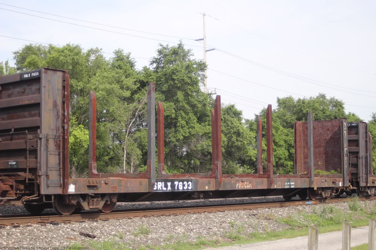

I wanted a couple more unique rail cars to add to my roster so I decided to build a modern pulpwood car. I like the big vertical steel posts that keep the logs in place and its also a style of bulkhead flat car that I like. The ends are different than the other I built and will add a cool variety to the fleet. I’m building two of them at the same time . Its a big car at 75 feet long and over 14 feet tall. I started this build as the others i’ve done with a piece of 1/8" x 2" piece of aluminum epoxied to a piece of .060 plastic cut to the size of the deck. In this case its 75’ x 9’, it will be over 10’ wide when finished. The bolsters are made from 2 pieces of .080 plastic , a piece of .030 plastic and a piece of 1/8th inch thick aluminum laminated together with JB Weld. A 1/4" hole is drilled through the bolster that will accept a plastic tube (evergreen #228) 1/2" long. The aluminum strip is drilled and tapped for a 4-40 screw 8 scale feet from the end of the car. I’m using trucks from Kadee (100 ton 36" wheels) for this car. The car is modeled after a SRLX ( Southern Railway Leasing) pulpwood car.
