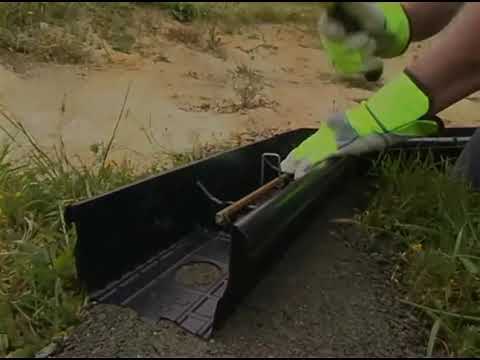

Fortunately & unfortunately I’m at the end of my roadbed construction. Some guys here do concrete road beds.
I just saw this YouTube NZ product promotion. @Neil_Wiggins might have an opinion.

@Hines That concreting does make it look really easy.
@Cliff_Jennings A slow response but I figured it was easier to show you than try and explain it.

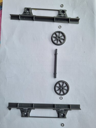

The bucket is a single piece:
The main frame, now slightly edited looks like this. The piece in the middle is a spacer that will go between the side rails, against the buffer plate and below the top plate.
Now that I’ve looked at the axles I’ve seen ways I can make those more simple too
Hmm… maybe I should work in an instruction factory

Had a quick look, seems pricey at$15 per m for the former plus steel and concrete. Definitely a timesaver tho. Might be an Au version on your side of the ditch, and most likely less cost (volume and all).
In a previous life I did a trench in tamped dirt with crusher dust slurry as the roadbed. Seemed to hold up fine. YMMV…
