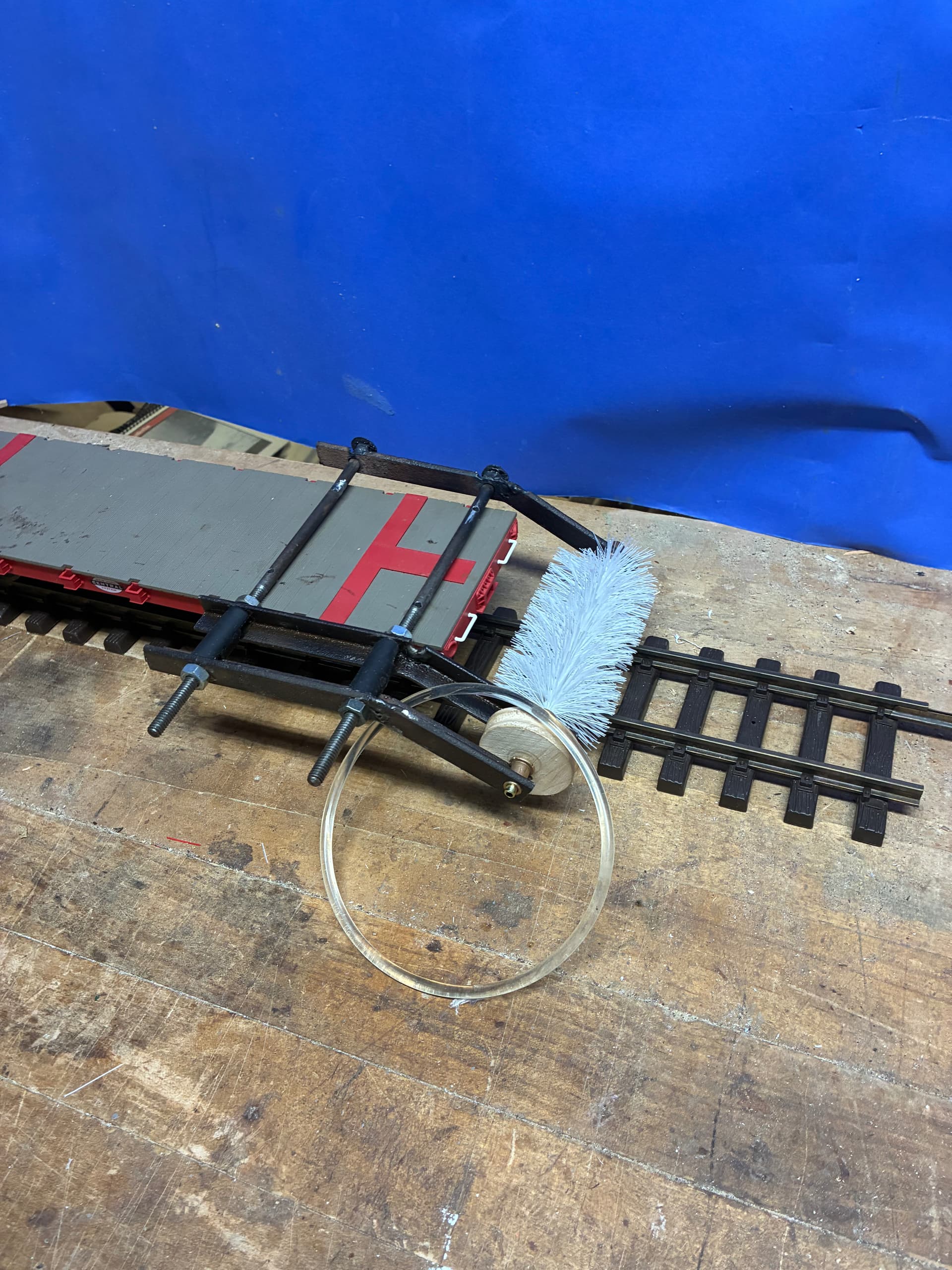

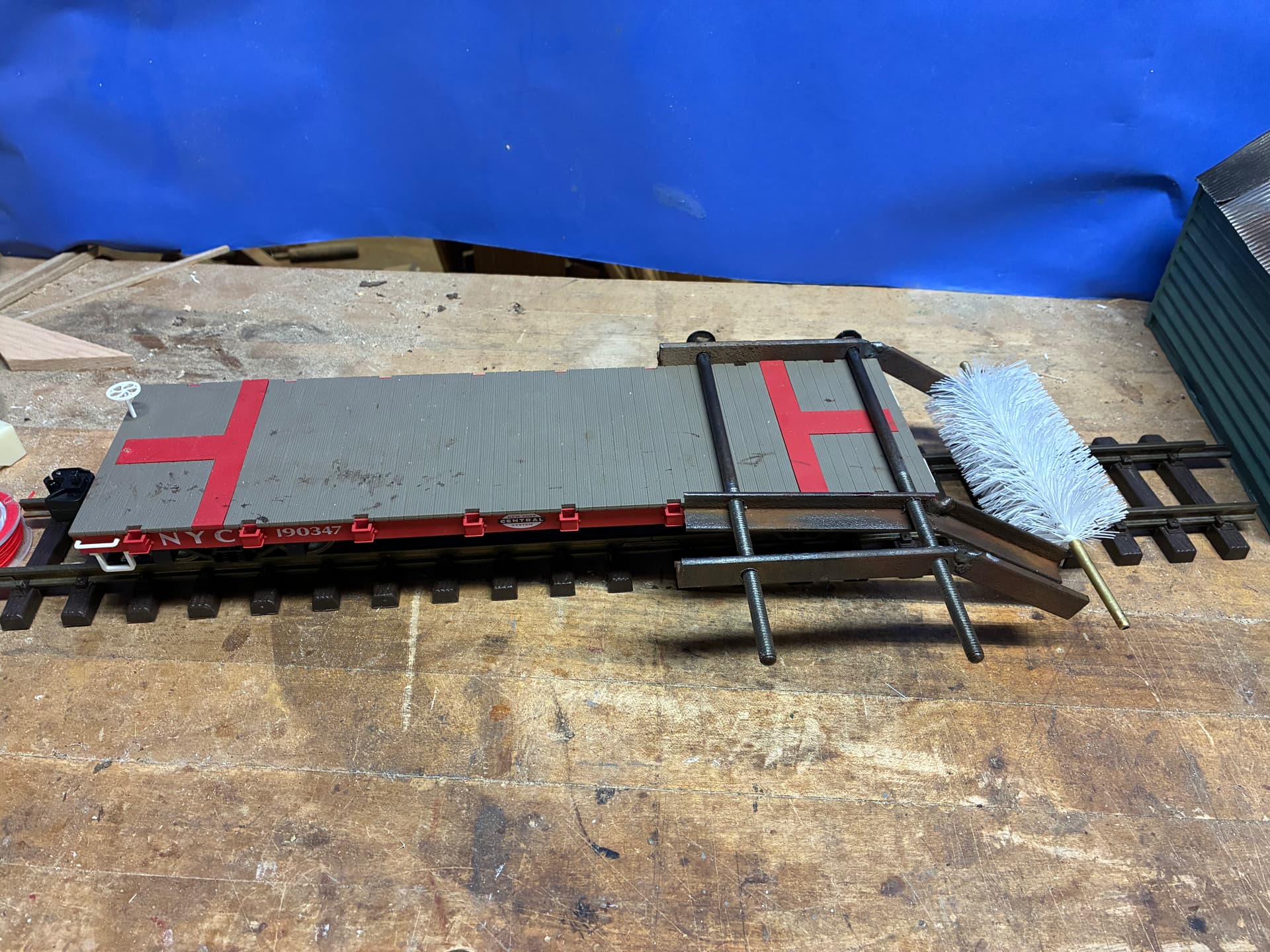

I have started building a powered broom car. The broom will be powered with a battery powered motor. It will be used to clean up the small twigs, leaves and grass clippings on the track.

@John_Bouck I plan on making a shield over the brush to hopefully avoid that.

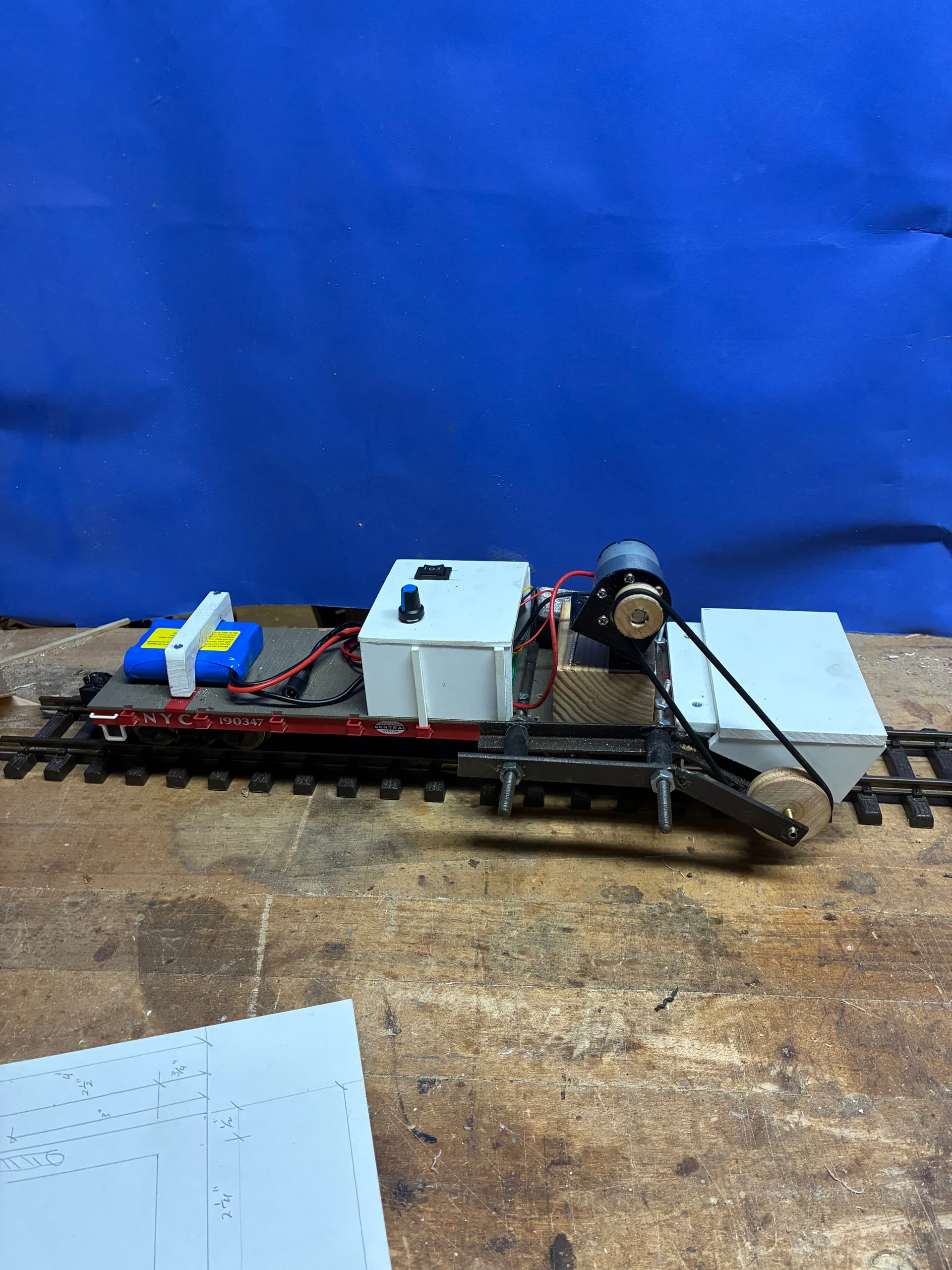

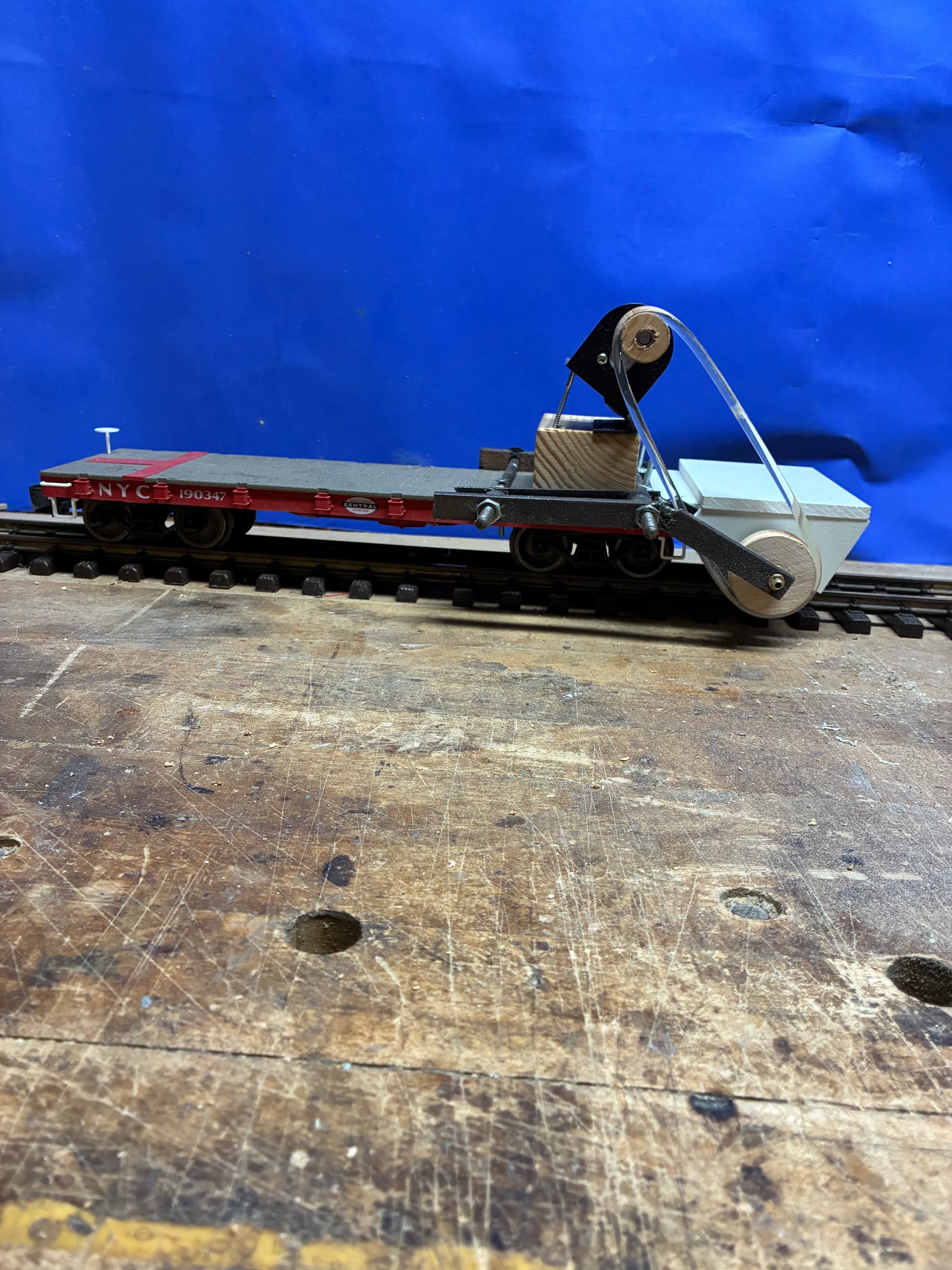

A little progress today, installed the bushings and belt that UPS delivered late yesterday. Waiting on the motor and battery.
Mounted the motor and added a guard over the broom, waiting on the battery.
It is coming along but if I may could I point out two potential spots of trouble?
Have you tried powering the broom with that belt? It looks too thick possibly too rigid. I use a thinner oring found at my local hardware store. Another spot of concern is that shield you built might be too low. It is possible for leaves, twigs and other bits to get stuck in the spinning broom, they do in mine, and by having the shield so close it might keep bits from being thrown clear.

Thanks for the comments, I can move the guard easily, I have not tried powering it yet waiting for the battery. I may change my pulleys too, after I see how fast it is going.
It does work better with the smaller belt. I think I need to change the pulleys, I think the brush needs to run faster. The motor is geared down to 600rpms and with the pulleys the brush is running to slow, I think.
