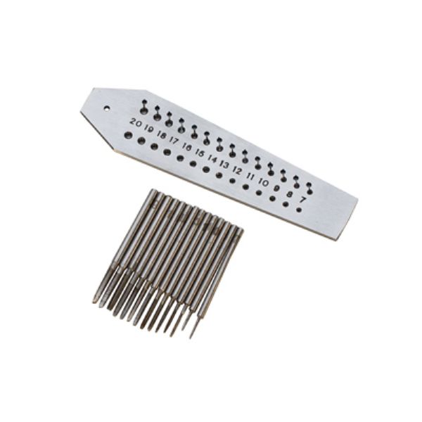

If no familiar, fish hooks come in many styles and each have the eyelet situated in different positions. What I prefer is what is called a trailer hook. I won’t go into what it is used for but key to its design is a long straight shaft leading to the eye. This allows you to cut the shank to any desired length within reason.
Then you can drill whatever your attaching to as deep as you need and then CA it in place. It won’t likely go anywhere. I was jut messing around with my cheesy die set and threaded a hook that had the right diameter (I believe 1.2 mm i ahve it written down if someone cares to know) to accept a 00-09 nut. It wasn’t a trailer hook though but the principle would be the same. You make it long enough to go through what your mounting to and actually bolt it on with a nut and washer and it sure as heck ain’t coming out. This would probably be way overkill but what the heck. I was actually just trying to develop threaded rod to use to attach my link and pin couplers to the body without them pulling off under load and was just using the fish hook wire when I went " hey real threaded eyebolts". I used little ones in HO with CA all the time. Hope that helps.
