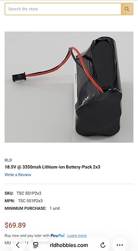

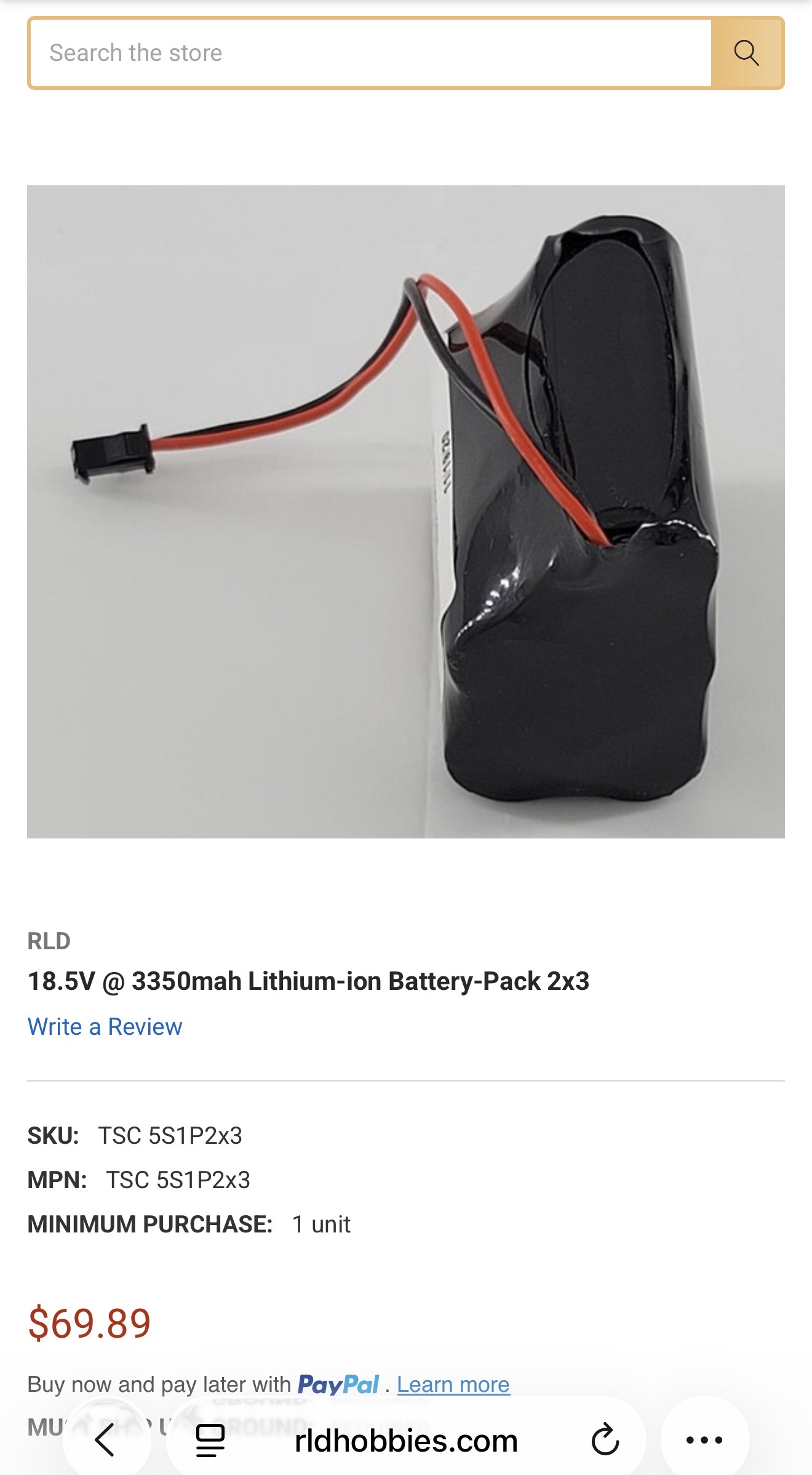

All my locomotives except one have 18.5v 3350mah batteries from RLD Hobbies , just under $70 , and they will run roundy round operations for 4.5-5 hours with one loco pulling about 8-16 cars , one has a bigger battery 18.5 6700mah and it will last over 5 hrs

The 18.5v 3350 3
batteries I use can easily fit standing or laying down in the shell of a USA GP locomotive so less than 3.5” length and maybe a couple inches wide.
