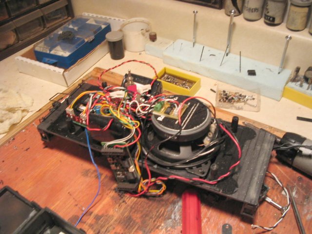

Like this one?
Nah…more like this…
Ken
That is known in the industry as "Rats Nest Wiring " . Whilst Tony is probably delighted to see you having a go --successfully we hope – I bet his toes curled up a bit when he saw your effort .
I don’t think anyone should knock what you show in the picture , it may encourage people who haven’t tried because they can’t do as nice a job as Tony or TOC does . I’m all in favour of showing , warts an’ all as long as you enjoy it and it works .
More disciplined wiring has many advantages ,usually in terms of serviceabilty in all senses of the word . And with show and tell , too .
But let’s keep things in perspective --if it doesn’t all come apart when you take the body off , it is probably acceptable . Tidying it up may induce faults . Best left out of sight until you need to get at it .
Mike
Far be it from me to criticise the work of others.
Especially as Ken has been running that loco successfully with the RCS install for some years now.
All wiring matted together can often be a good if unintentional method of stopping induction interfering with the RF signals.
However, it is a good idea if possible to keep the receiver antenna out of the other wiring.
As TOC would say: Holy Batman!
