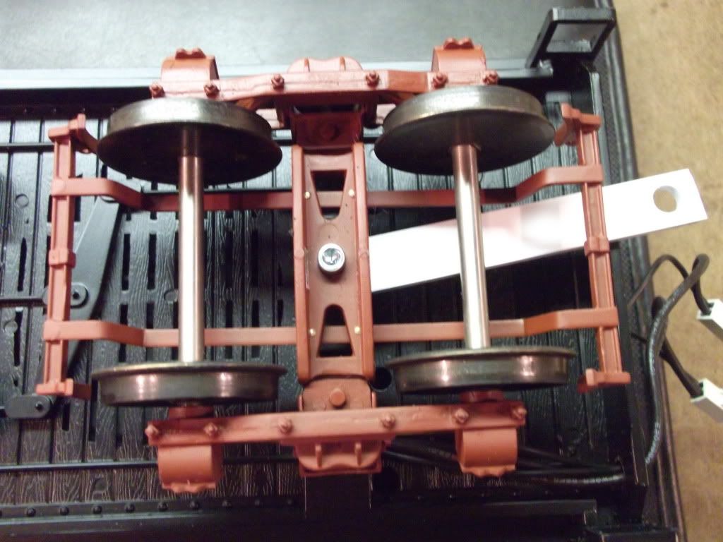

When I replaced my Annies tender trucks with Accucraft units I made a draw-bar from .125 styrene and simply drilled a hole in both ends…One fits on the journal post the lead truck screws into, and the other uses the same hook on the engine the old “Hook and Loop” did. This allows pleanty of swivel but puts all the force on the tender body. It still manages tight radius curves. I’ll see if I can find a pic.
Edit: I double checked…It’s .080" styrene.
I just cut the loop off the tender truck and mounted it directly to the body of the tender. I also shortened the distance between the tender and loco.
Found it…Hope this helps. I should paint it but honestly you don’t see it.

Randy, my son;
Just take the loop coupler that is on the tender truck…cut it off and mount it on the front of the tender, using shims of styrene to set it at the correct height. You can also mount it back a bit farther than it was when truck mounted. I lined the rear ege of the loop in line with the front of the tender. This gives you closer coupling of the tender to the loco, if your curves are over 4 feet in diameter.
All my locos hace this madification and work well.
While you are at it; body mount a Kadee coupler on the rear of the tender…

That was a criticism I had, too, wich is why I moved it. When I mounted to the tender body I only left enough of a gap in the coupler loop so that the tang on the engine just fits. There’s less side to side play and the engine body is what is actually pushing against the tender. (If you know what I mean).
