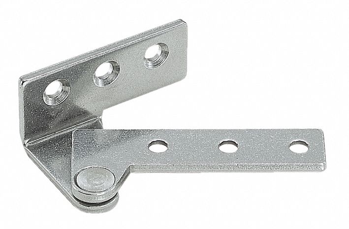

There’s a secret, you need an offset hinge that lifts the rail ends away before lifting, basically the hinge points are above the level of the rails.
The angled base will go down on the baseboard that the track is on, the flat piece on the side of the moveable part…
rotate this picture 90 degrees counterclockwise…
you will see that in effect the offset moves the rails apart very soon as compared to swinging.
This makes a big difference on how nicely you can make the rails fit together at the hinge joint.

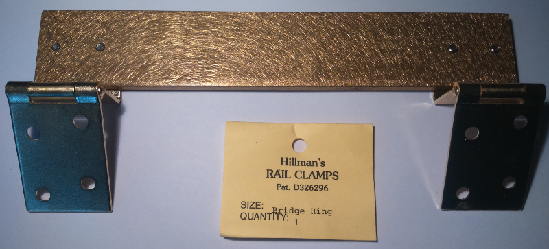

If you can find a picture of the hillman bridge “hinge” you will see it works similarly

Something like this is exactly the sort of thing I envisioned needing. I am pretty sure you showed me this once before. Do you know the name of this style of hinge? Is this something you can get at a big box store.
I googled the Hillman bridge hinge and was wondering if one could just use a T Hinge bent to shape
I am generally a pretty handy guy but for some reason I am having trouble seeing how to make this work (easily) without having to fabricate the entire hinge assembly.
If I were to bend a T hinge to shape, I am thinking that the pivot point of the hinge needs to be as high or higher than the top of the rail, right, preferably higher? Then it will lift away as it is rising?

Same idea, the hinge point above the rails… that’s the key…
In this case, the end of the moving part is also “beyond” the pivot point, thus making sure the rails separate before lifting, if you will.
if you wanted to bend one yourself, instead of the example you showed, use something like this:
But realize then that hinge is maybe 2 inches wide, so you would have to add that width to your right of way on both sides. So not really as good as the examples above.
Greg
