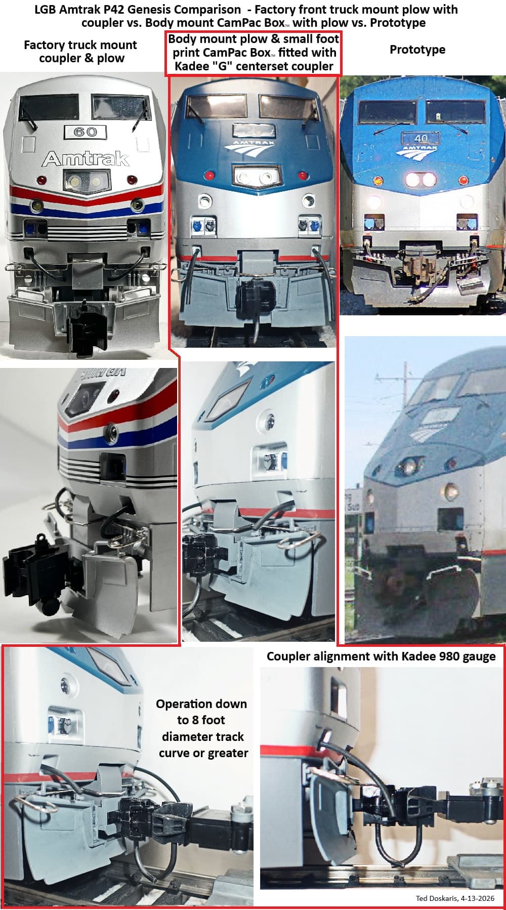

I’ve been working on doing body mount CamPac boxes for the P42 which makes the loco more like USA Trains offerings and more realistic. So far the front coupler is done - still working on the rear.
Cool, are you gonna do the back as well?
Yes as I mentioned in the description. CamPac boxes are small foot print - not like the large Kadee 906s
