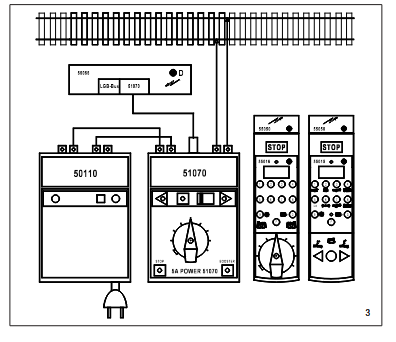

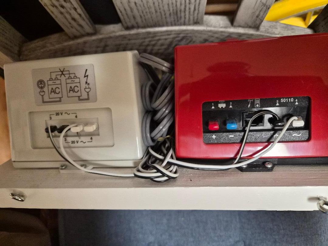

Are you wired like this?
If you happen to short the transformer, you need to push the reset.
The transformer must be unplugged from the 110V outlet when you push the reset.

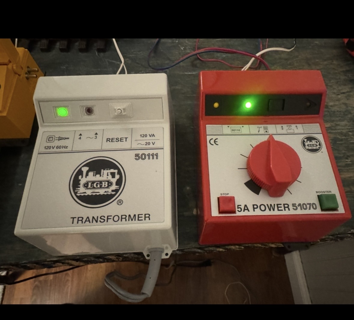

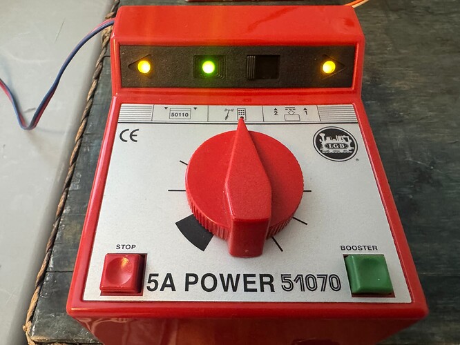

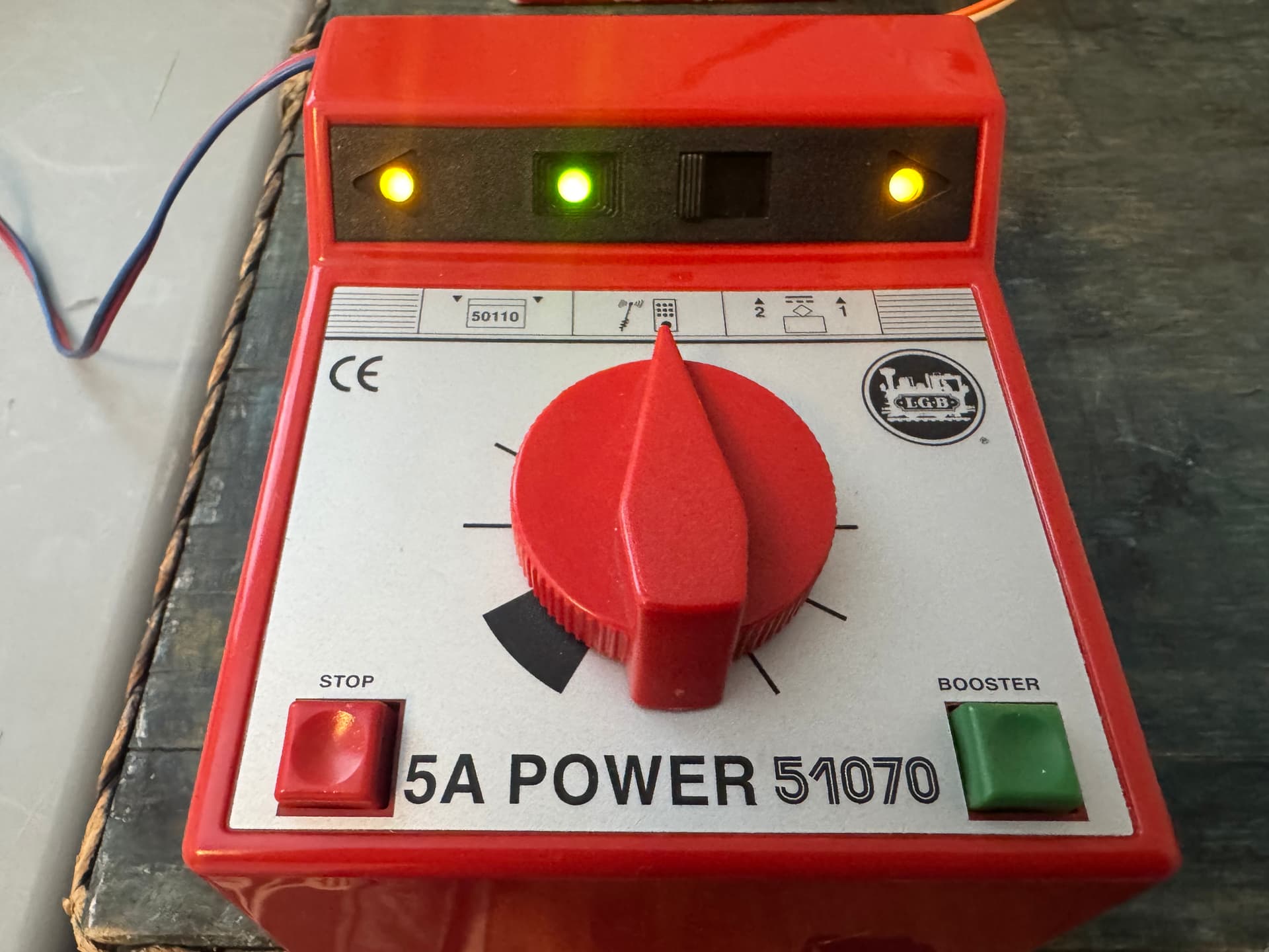

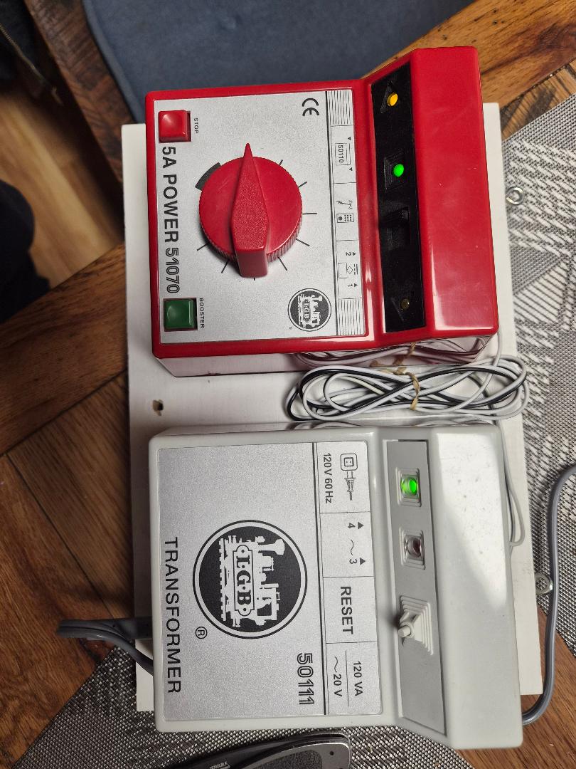

This is what the 51070 looks like when I plug it in. And attach it to the track. I don’t think all of these lights should be on.
well, then i don’t know.
are you sure, that your cables are connected as requiered?
Neither do I. You have it indicating leftward and rightward travel! Hit the STOP button!

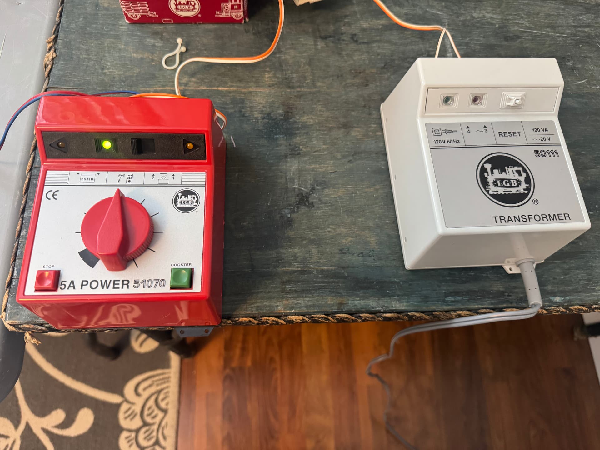

Here is a photo of my 51070 & 50111 connected to power. There are green lights on both, but my loco will not move. I’m using a small Stainz loco.
Can you tell me what your lights look like when you are powered up? Thank you for your help.

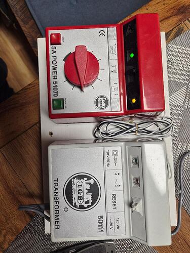

Only 1 amber light on to indicate direction on the controller, no amber light when the controller is in neutral. So something is wrong.

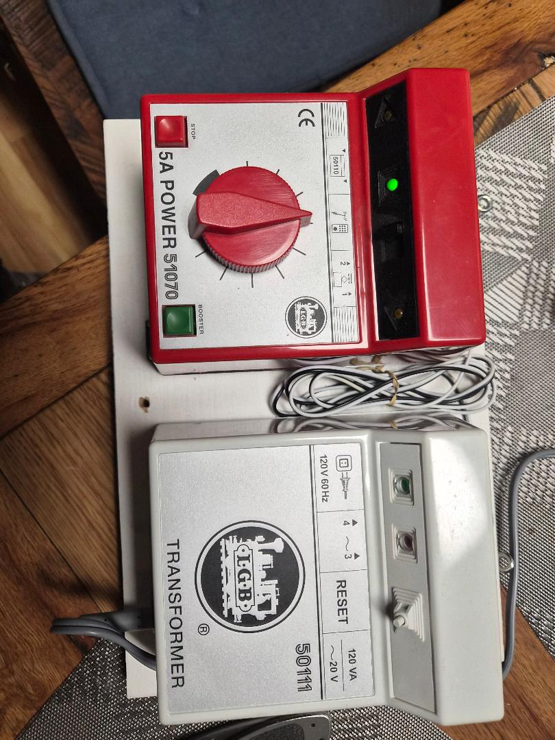

Controller in neutral:
Direction selected:
Opposite direction:
Green light on the transformer when plugged in. Red light on transformer, overload and tripped.

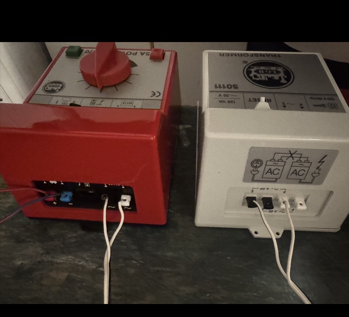

On your picture, I can not tell, do you have the power wires from the transformer to the controller reversed? 3 to 3 and 4 to 4? The 50111 power pack will power up 2 separate controllers.
Thank you. I have 3 to 3 and 4 to 4.

I agree, the 51070 should not have a amber light on when in neutral.
something is off.
in the pic above, the connected cables to the 50111/50110 are different from the pic in the manual.
Before you do that try disconnecting all the wires on the transformers and then turn them on with no connections and see how they light up.
