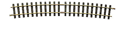

Looking at the LGB 18000 series track, the R5 switches may not be a direct drop-in replacement for Aristo or USA Trains #6 switches. From my experience the #6 seems closer to fitting within a 20 foot diameter circle compared to the LGB R5 that is described to fit in a 15.5 foot circle. This could be a problem for established layouts.
Curve Track, R5:
LGB 18000 Curved Track, R5, 15 Degree
“24 pieces needed to make a complete, 15.5 foot diameter circle”
Switch, Right & Left, R5:
“Straight: 600 mm. Curve…, R5, 15°. Included manual drive can be installed on either side. Convertible to electric with 12010.”
LGB 18050 Manual Switch, Right, R5
LGB 18150 Manual Switch, Left, R5
