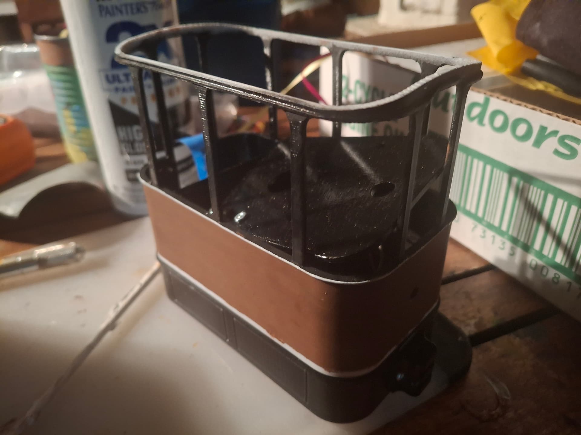

Somewhere along the line, the skirt, steam dome, stack, and boiler got painted, which, of course, necessitated a test fit:
You’ll note our 1:24 PLAYMOBIL engineer fits perfectly! Bonus!

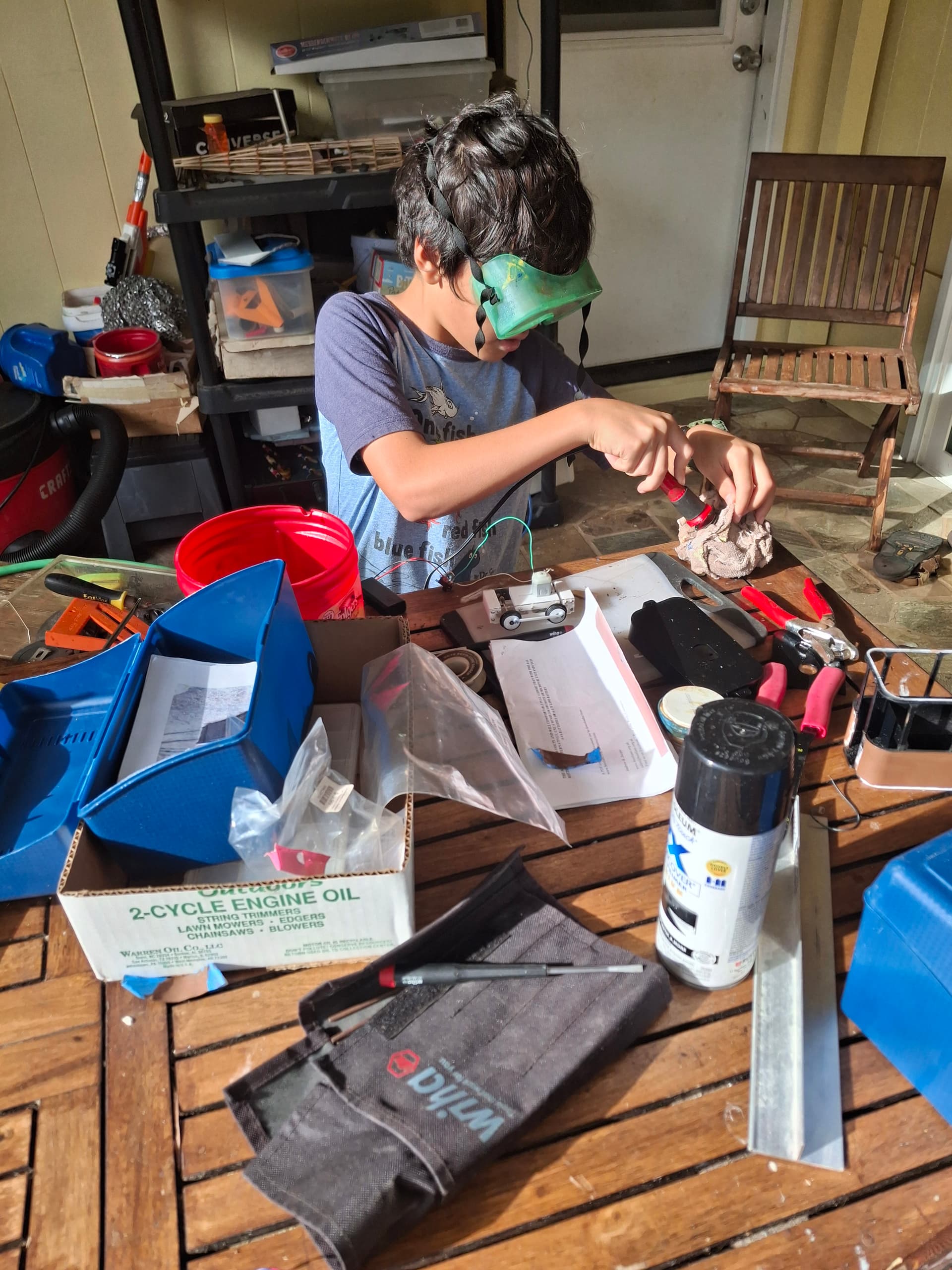

I had been peaceably working on a rocket, when I heard him mumbling about getting the wheels onto the axel. I looked over and saw a pair of pliers about to clamp down on the drive gear, so I decided it was time to act to prevent catastrophic failure (of note, his kit complete extra motor and gear, whether by design or accident, I care not!). Then we really got into trouble, which is why there are no pictures.
The company usually makes 32mm stuff, and the instructions, which I read, said to make sure the wheels had 28mm between them. Being literally minded, I dutifully the wheels 28mm apart. Ooooopsss…Maybe if I could have found my gear puller, the 90 minutes of creative use of vise, hammer, aluminum angle, pliers, etc. could have been prevented. I would also note the axel is a bit short, and it does not come flush to the end of the wheel hubs when the gauge is set. Something to know if you get one of these kits.
This worthy father-son quest successfully concluded, Kid-zilla installed the bottom plate. The instructions warn that you may need to enlarge some holes with an 8mm tap. Not having one of those, we gently widened these holes with a jewelers file. This has been the only difficulty we’ve had to date in terms of part fit. Maybe these folks could do quality control for B’mann?

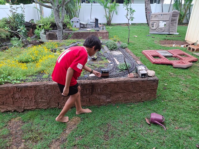

Success! To be frank, I was surprised how well the shallow flanges kept to the rails.

It scooted along pretty nicely.

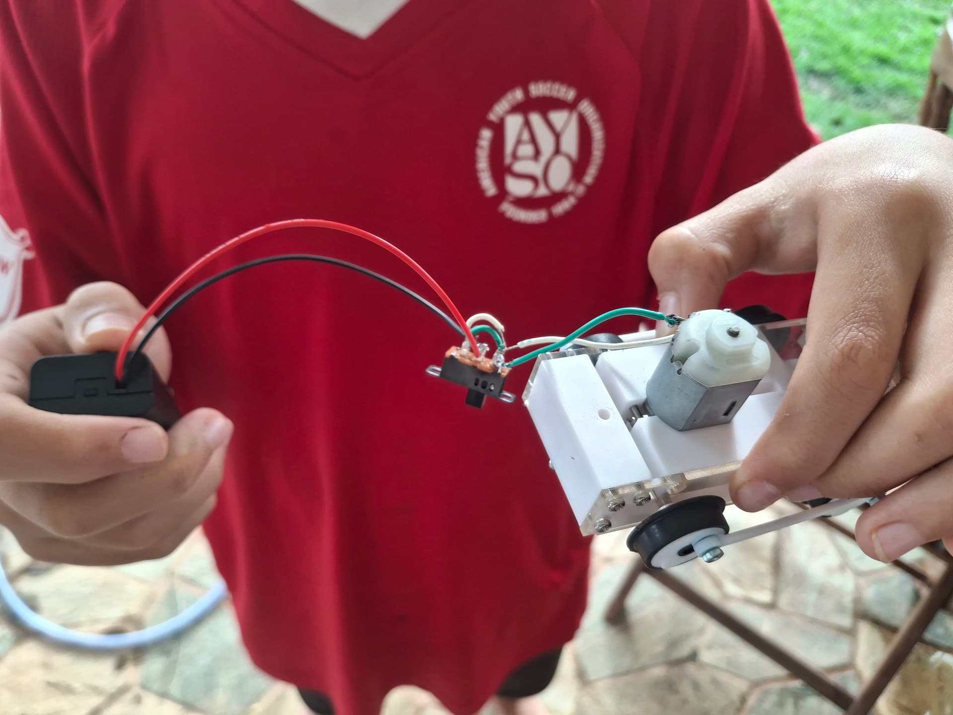

Torrential rains drove us from our lanai this weekend (see my last post in Hawaiian Volcano?), but, in between soakings, Kid-zilla did make some progress. The big event was to wire the DPDT switch, batteries, and motor together.
Saturday, he set-to, but not before a wind gust sent my tablet with the picture of how to wire a DPDT switch to the ground (I had it on top of a bunch of boxes; the boxes went, and the table went with them!).
Success (video)!!!
Track trials followed…
…but, surprisingly, we found Fudge bound on our curves! The resistance seemed to make the vertically mounted motor disengage from the drive gear. We experimented with wooden wedges to hold the motor in place, but the rains returned, ending our session.

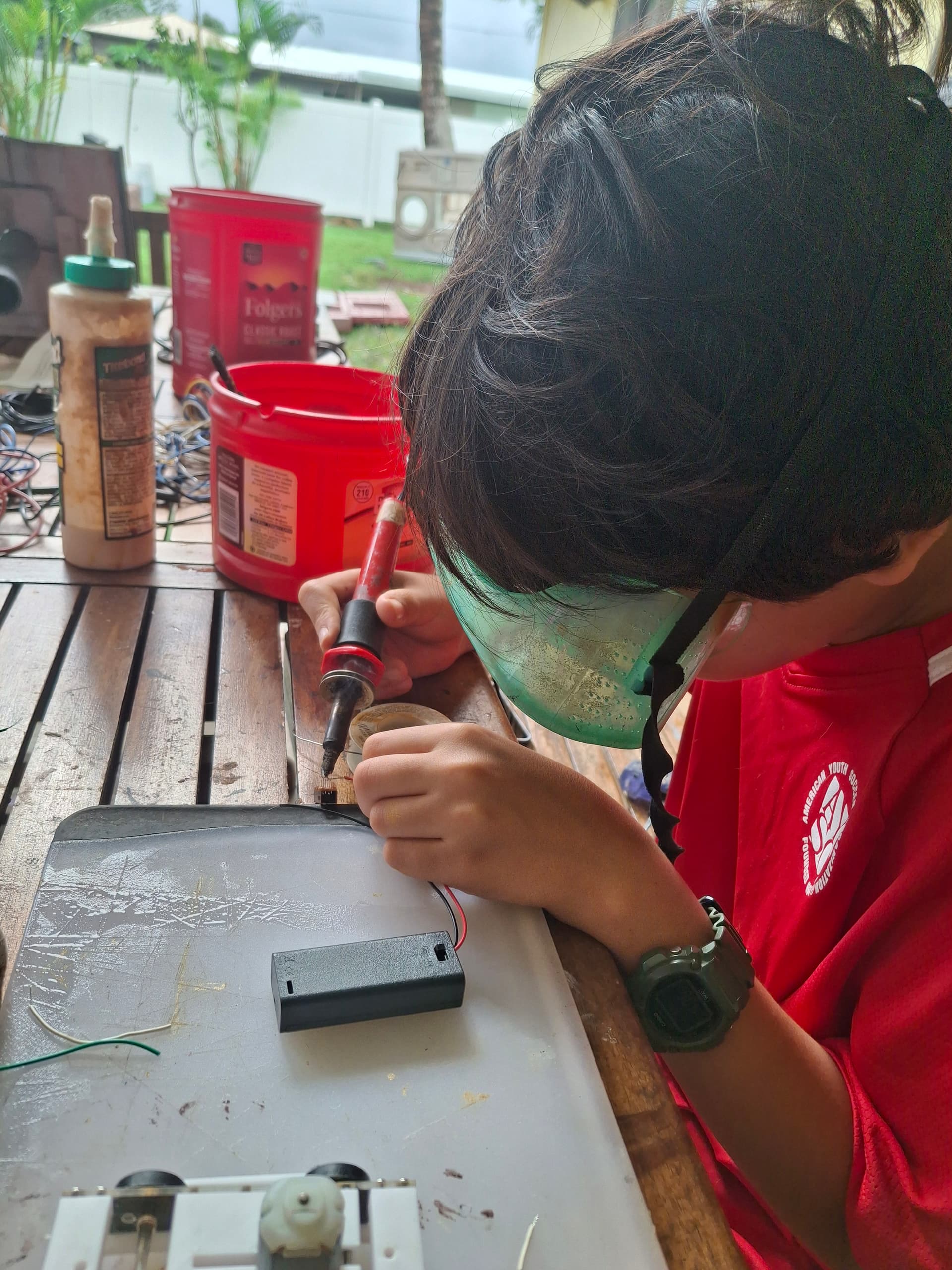

Sunday Kid-zilla was back at it. He found that his wires were to short allow him to remove the deck to change the batteries, so some cutting and soldering were in order. He reminded me that, while I can solder, he is actually good at it. He’s not wrong…
Longer lead wires did the trick!

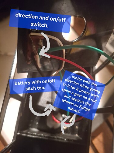

He also wanted to show off his wire work…
…as well as to explain how the mechanics work. He did not, I see, use spell-check.

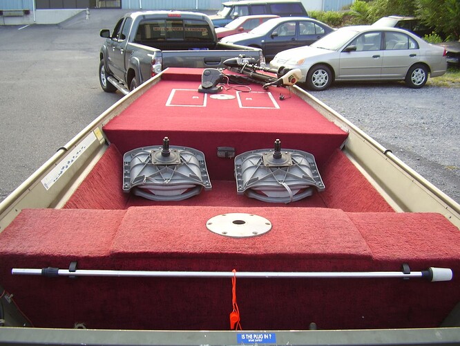

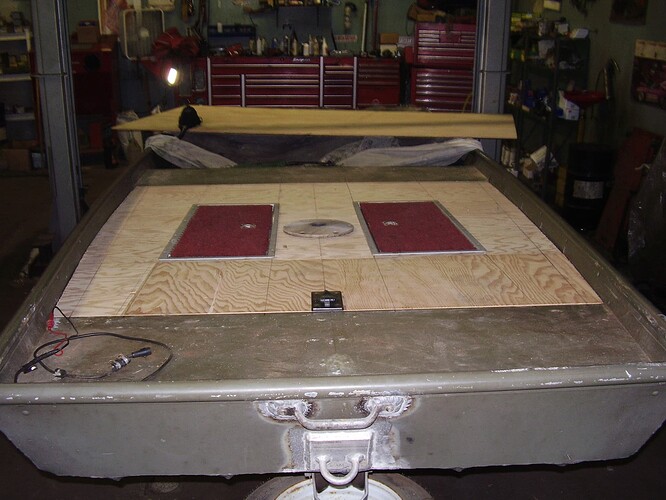

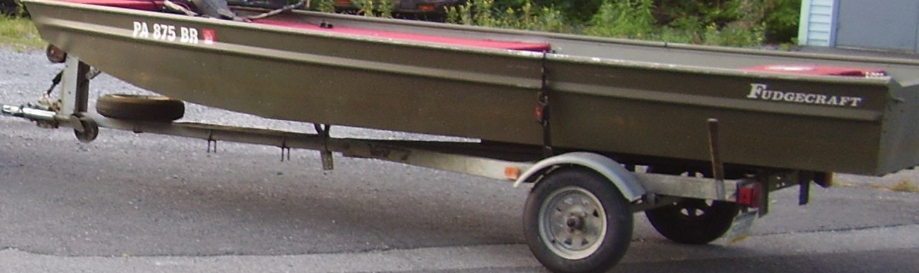

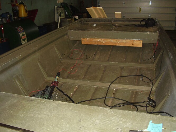

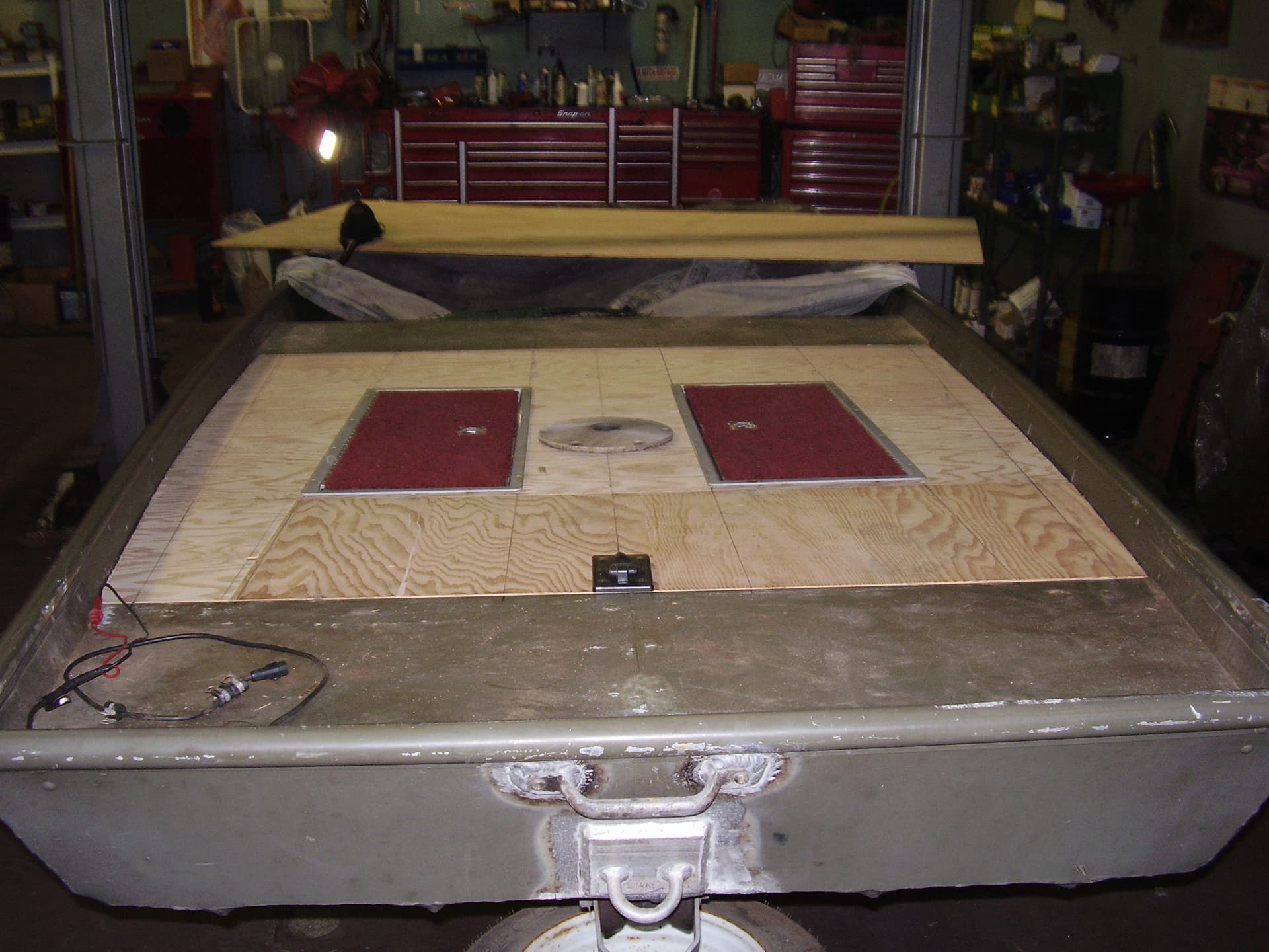

(insert wavy lines here) …Back in the day, I wanted a comfortable boat for fishing the small lakes and large ponds in Pennsylvania. I looked around and found the perfect platform to build what I wanted on a budget.
So purchased a “Polarcraft” flat bottom jon boat that was extra wide and stable so I could take my father fishing on it. After I was done and several mistakes later we joked about it being a polarcraft and it should be called a “Fudgecraft”. So when I was finished I had some customs decals done.
Sorry for the thread jack but thought the story was a perfect fit.
He liked the boat!!!

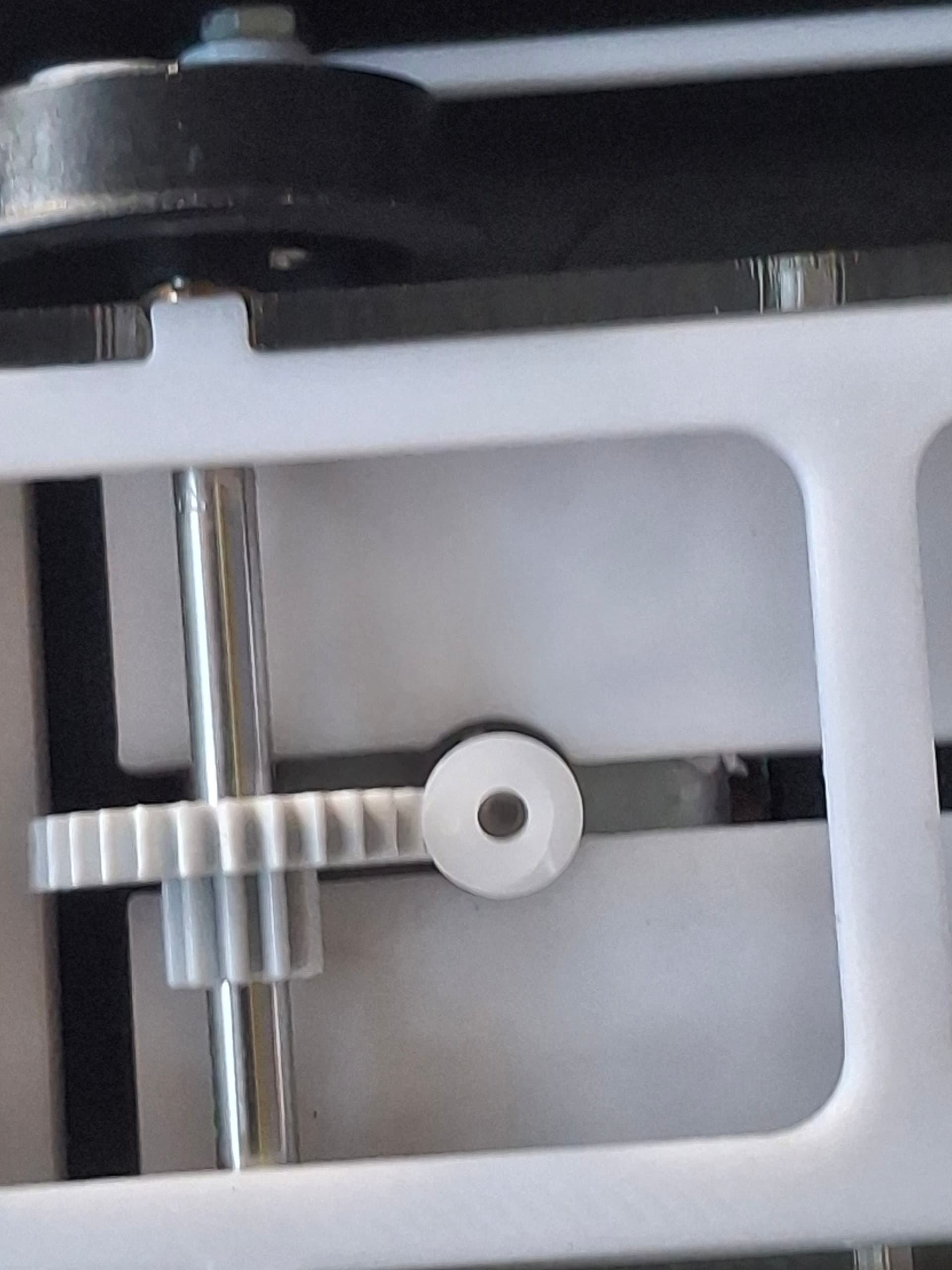

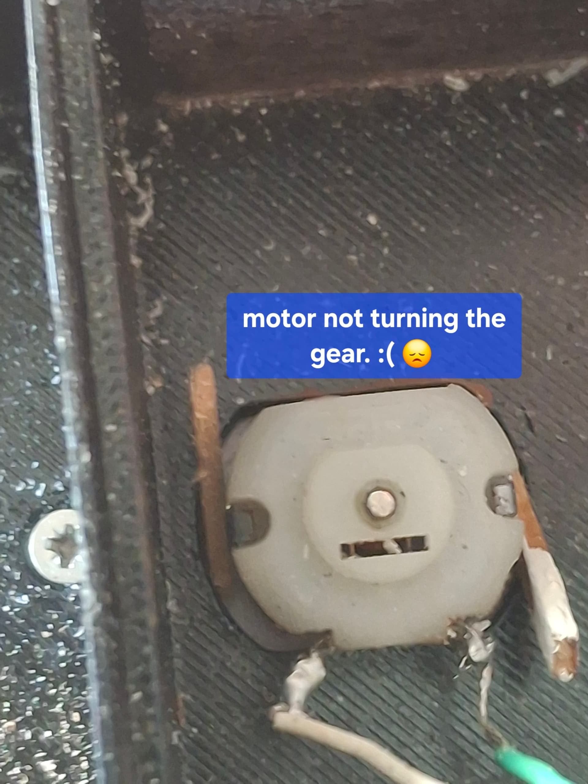

Kid-zilla is satisfied with his painting. Unfortunately, he is having a bit of an issue with the drive train. The vertically mounted motor comes down through the floor and engages the drive gear:
Earlier testing shows it works loose on our curves. He is experimentingwith shims to brace the motor in place, as accessing the bolt thst holds the motor in place would entail taking off the wheels, which is really hard

Nothing heard from the company…Should we proceed with Plan “B” and try to use hot glue or E6000 to hold the motor in place?
Perhaps wrap the top of the motor with electrical tape until you can get a snug press fit. Then make some Z-bent brass (metal ) screw one end to the floor and let the other end rest firmly on top of the motor casing.
What are we looking at here? Is this the split in the floor that clamps the motor?
The motor sits snugly int a puka (hole), then a 16mm screw is used to tighten the puka about the motor.
I would be inclined to avoid glue. As the motor is clamped, perhaps a shim on the side away from the axle will persuade the motor to engage its gears?
