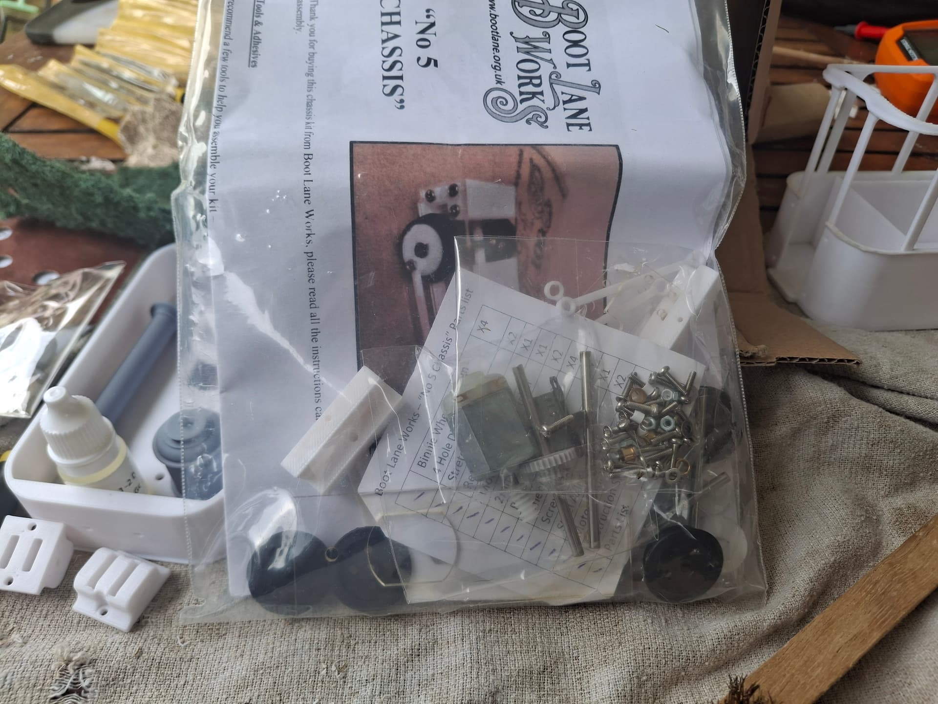

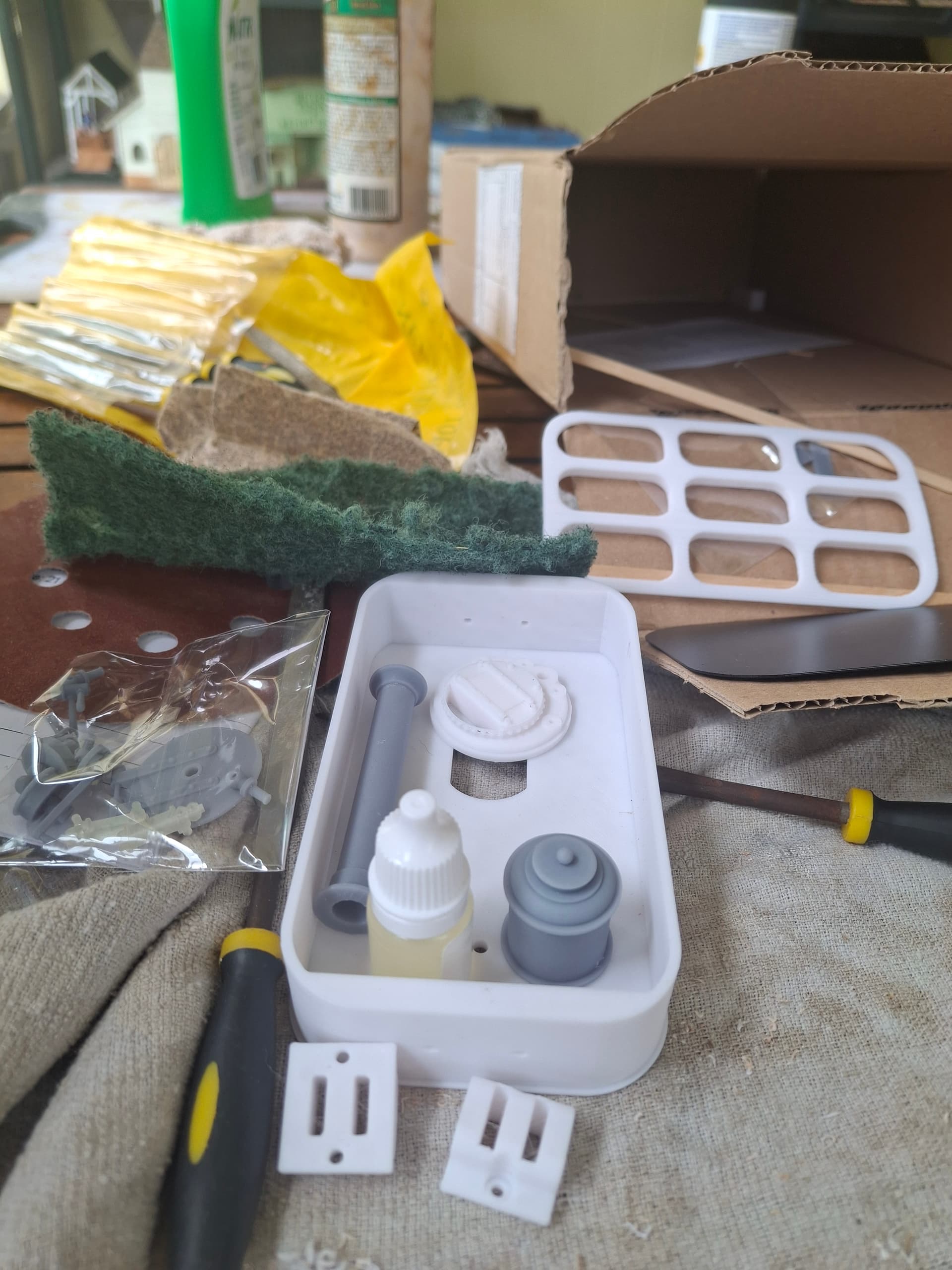

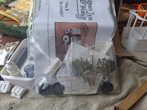

The kit, by the way, is a nicely packaged, with inventory sheets to check contents against instructions. I’ve no way to evaluate the parts against other manufacturers’ offerings, so I offer photos below:

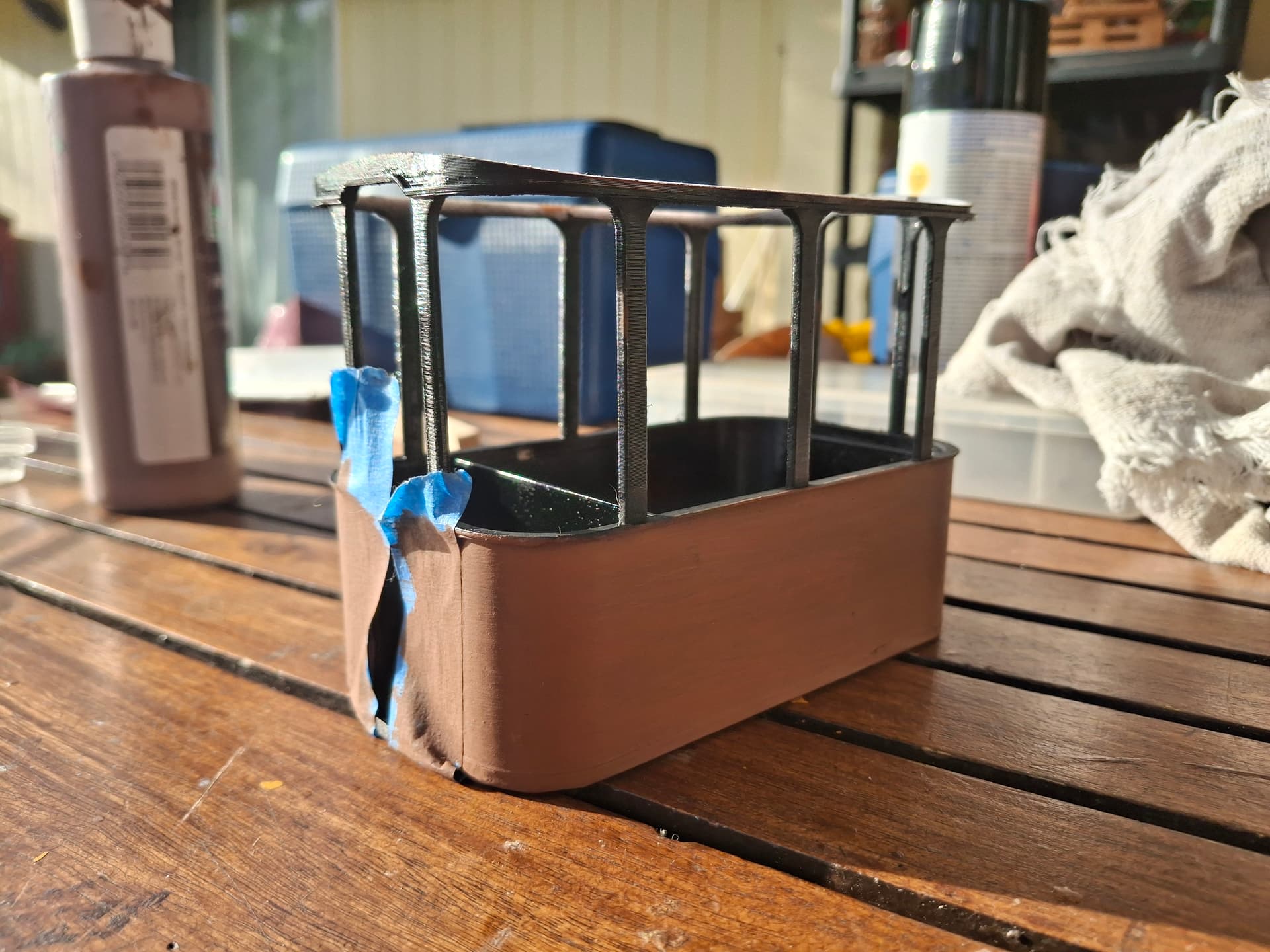

The day ended with some time at the Palm of Spray Painting, where Fudge got its black parts painted black.
The brown will go on Sunday. We’ve found it takes 48 hours for paint to cure.

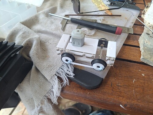

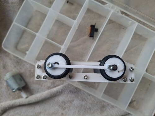

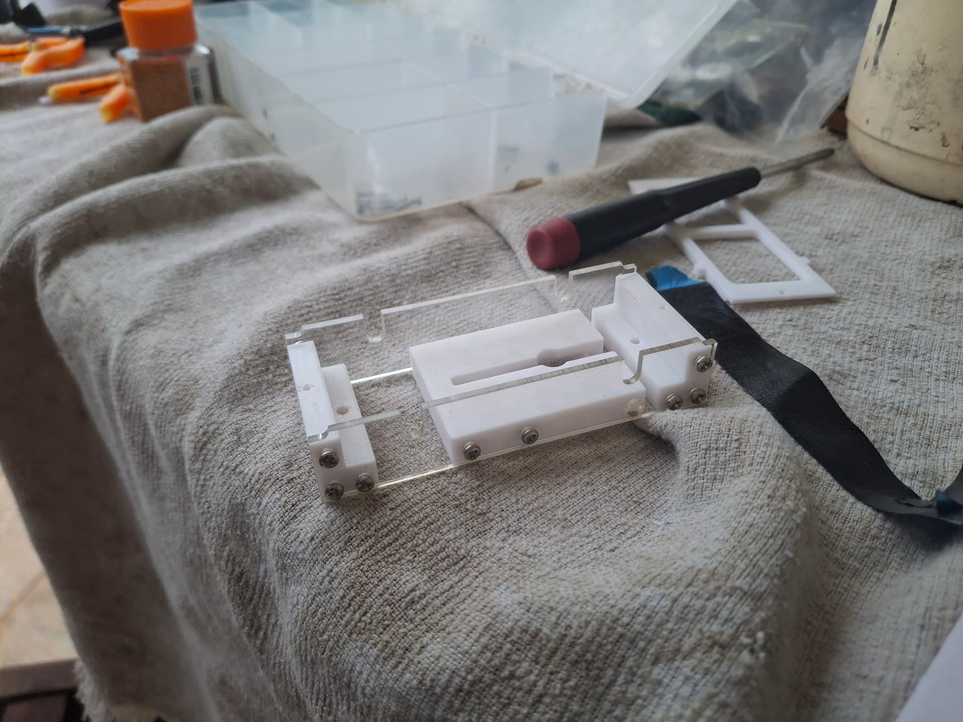

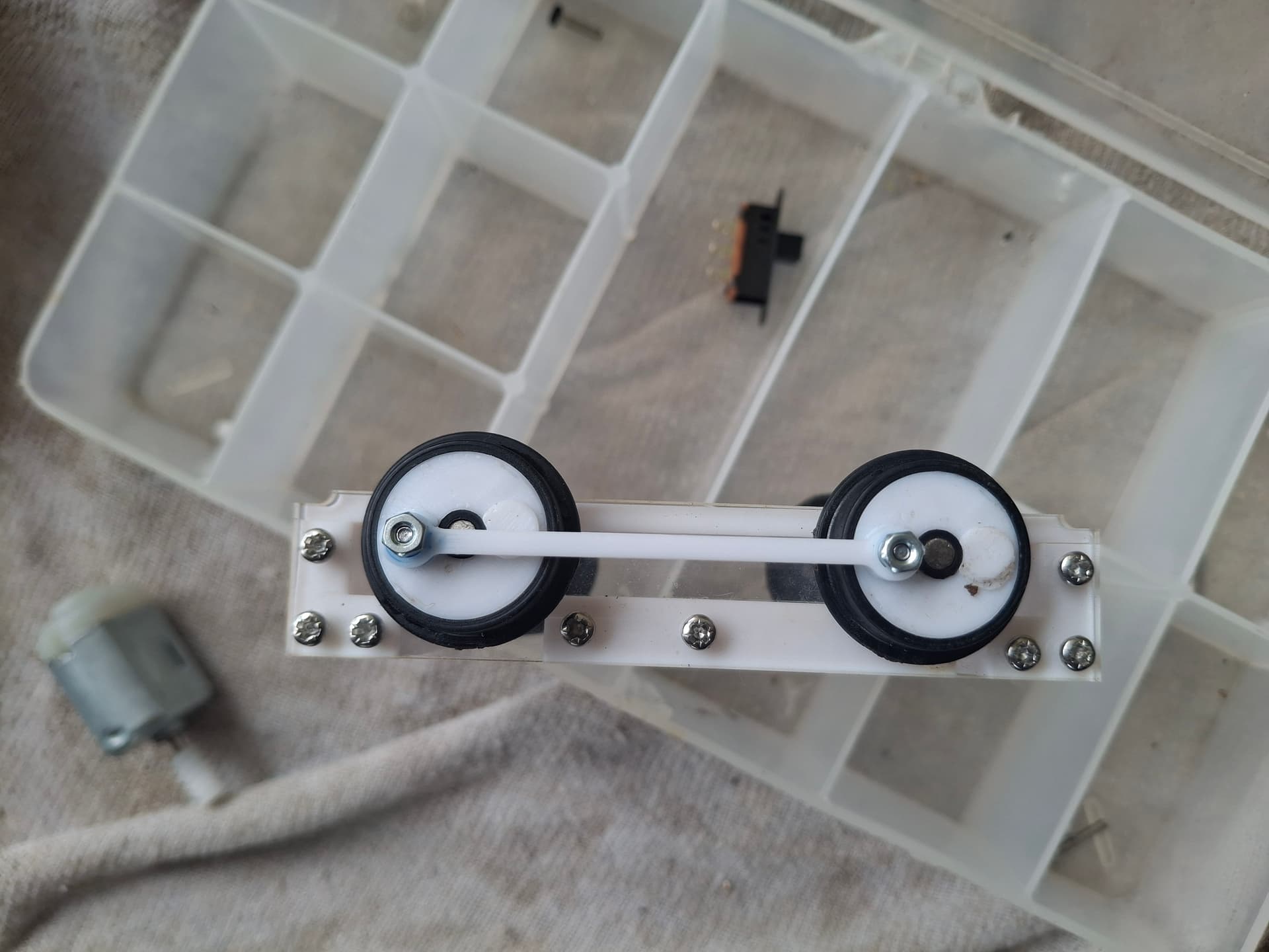

Back to this build. The chassis came together almost problem free.

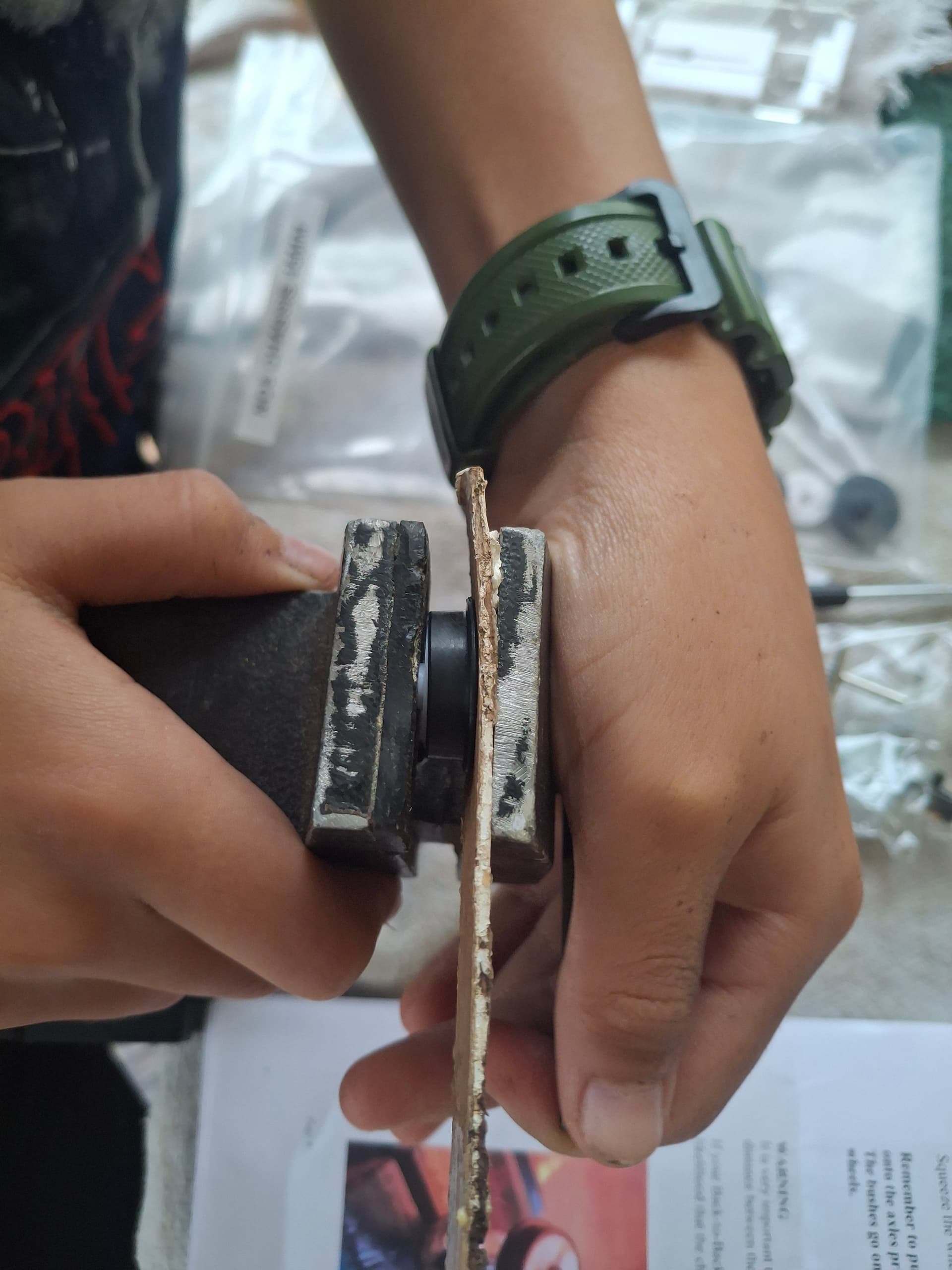

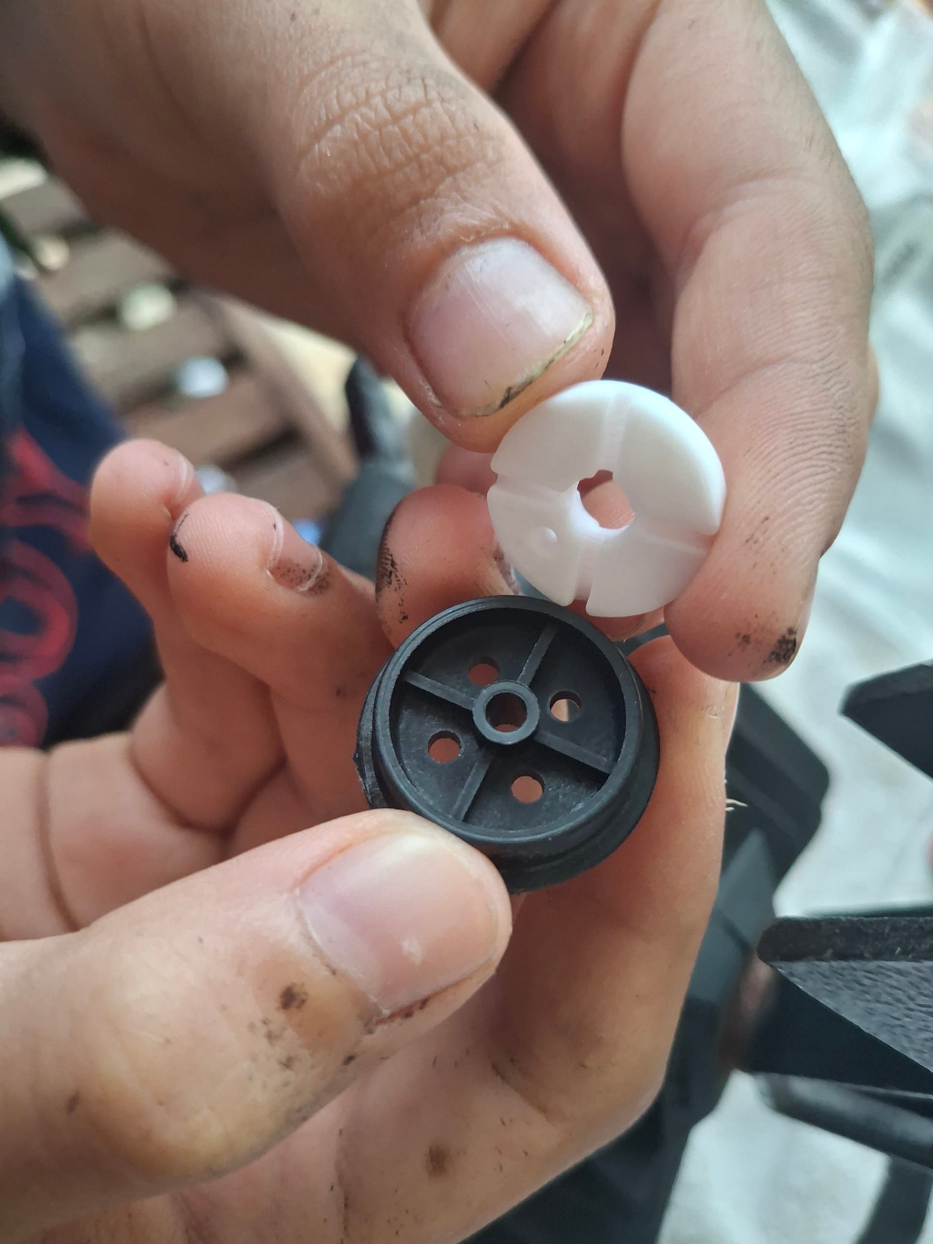

After that, following the instructions, he used our vise to place these hubs into the wheels:
Using the vice was a neat trick!

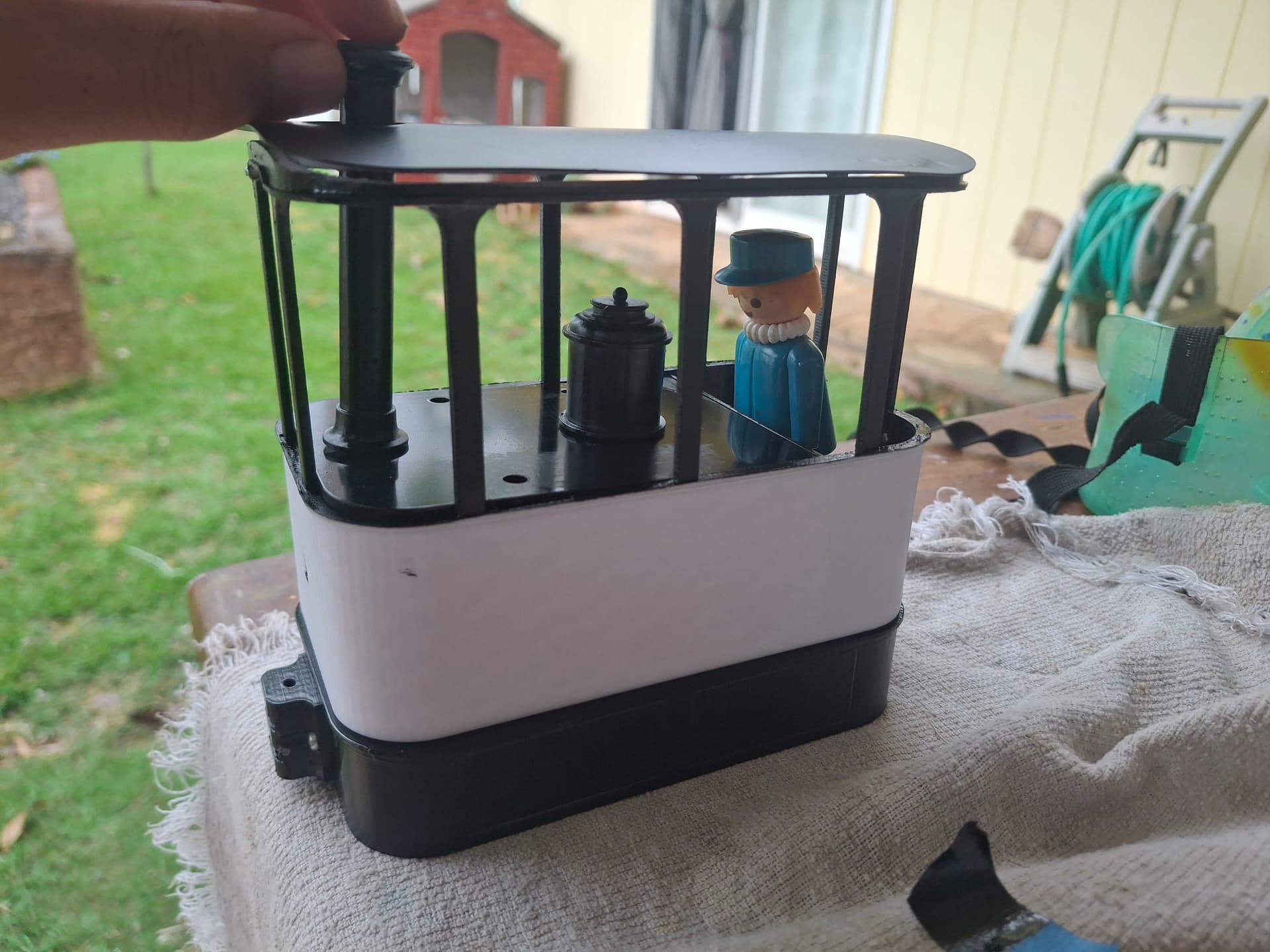

Somewhere along the line, the skirt, steam dome, stack, and boiler got painted, which, of course, necessitated a test fit:
You’ll note our 1:24 PLAYMOBIL engineer fits perfectly! Bonus!
I had been peaceably working on a rocket, when I heard him mumbling about getting the wheels onto the axel. I looked over and saw a pair of pliers about to clamp down on the drive gear, so I decided it was time to act to prevent catastrophic failure (of note, his kit complete extra motor and gear, whether by design or accident, I care not!). Then we really got into trouble, which is why there are no pictures.
The company usually makes 32mm stuff, and the instructions, which I read, said to make sure the wheels had 28mm between them. Being literally minded, I dutifully the wheels 28mm apart. Ooooopsss…Maybe if I could have found my gear puller, the 90 minutes of creative use of vise, hammer, aluminum angle, pliers, etc. could have been prevented. I would also note the axel is a bit short, and it does not come flush to the end of the wheel hubs when the gauge is set. Something to know if you get one of these kits.
This worthy father-son quest successfully concluded, Kid-zilla installed the bottom plate. The instructions warn that you may need to enlarge some holes with an 8mm tap. Not having one of those, we gently widened these holes with a jewelers file. This has been the only difficulty we’ve had to date in terms of part fit. Maybe these folks could do quality control for B’mann?
Kid-zilla quartered the wheels, which proved easy.
Given all of this is hidden behind the skirting, the rod is visually unnecessary.

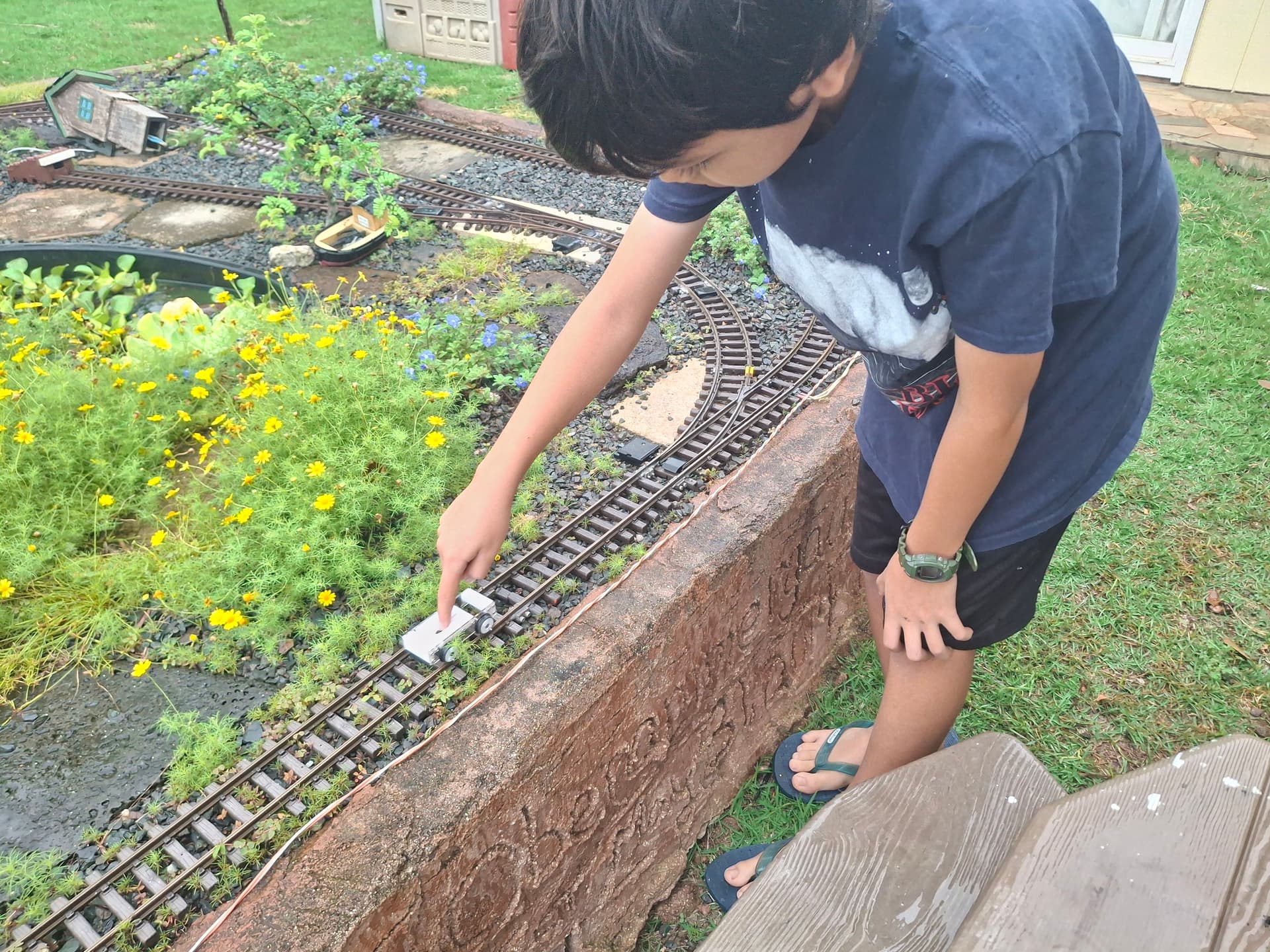

Now it was time from some 0-5-0 testing. Our previous foray into UK kits ran into the rocks on our turnouts, so I was very worried…
Success! To be frank, I was surprised how well the shallow flanges kept to the rails.
The motor went in next. Unfortunately, this required removing the bottomplate which had been such a bearcat to install. The motor sits snugly int a puka (hole), then a 16mm screw is used to tighten the puka about the motor. Then you get to put the bottomplate back on, a job which fell to me. Completed, it lloks like this:

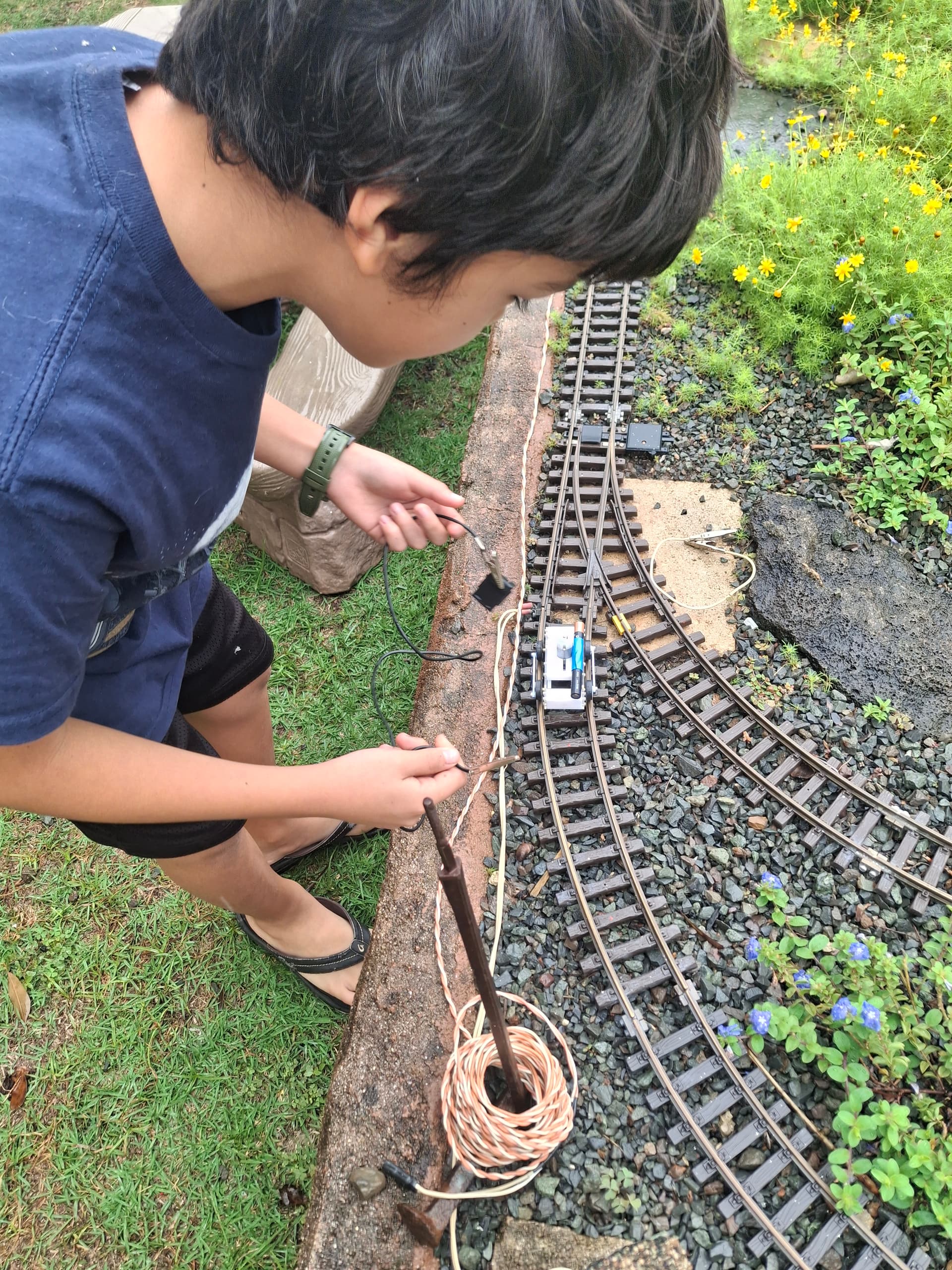

Track trials followed…
…but, surprisingly, we found Fudge bound on our curves! The resistance seemed to make the vertically mounted motor disengage from the drive gear. We experimented with wooden wedges to hold the motor in place, but the rains returned, ending our session.
