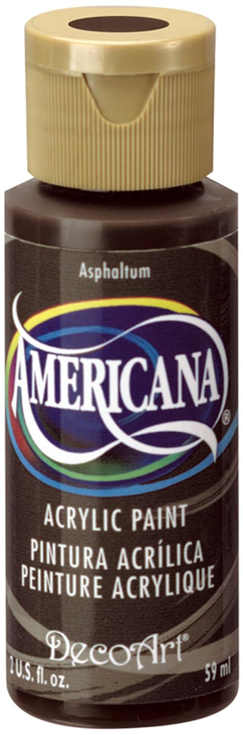

They look nice with the rods cut off, painted, and brake line hoses mounted on the cars.
I use Americana (Asphaltum) paint for all my G scale Kadees. While it takes some time to brush paint them, I think the end result is worth it.
