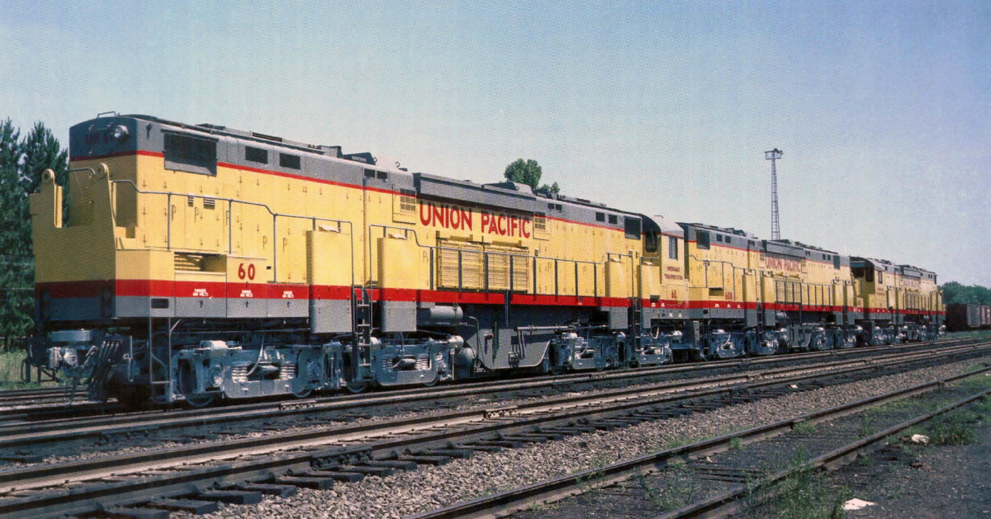

Rarest is the Alco C855, there were 3 C855s built for the UP (2 As and 1B), all three are in this picture.
Chris

Chris Kieffer said:
Chris
Your pure evil for posting this.(http://www.largescalecentral.com/externals/tinymce/plugins/emoticons/img/smiley-tongue-out.gif). I love the EMD DD35. I bought one in N scale before I began modeling in N sale and it dictated my layout. They are just massive. And I had no idea they made a B unit. Now I want to model it in G. But I am affraid my 8 foot curves would disagree.
