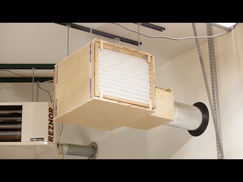

I’m using the same vacuum pump as for the laser; the pump is outside in a ported plastic Suncast deck box. It’s similar to those used for inflatables, except its connection is at the center of the fan, not tangent to it. Here’s what I’m using:
There are plastic versions of it; but I’ve yet to find one with the center inlet connection for vacuum usage. This one is cheaper than mine and is 2x the wattage (might be overkill):
I’d want the motor to be as separate from the airflow as possible, to avoid mixing flammable fumes with the motor. Which is why the inline blowers, or ones with the squirrel cage around the motor, don’t seem great. Those mentioned above at least have the blower to the side.
Here’s an interesting setup one guy did, with a completely separate motor.
I don’t have any records, and according to Micromark, I have NEVER bought anything there at all. (Who knew? :innocent:). But, I suspect that IS where I got them; and they just don’t carry them anymore…
I built one years ago from a cut down cardboard TV box reinforced with wood furring strips. The fan motor needs to be outside the air path to eliminate the possibility of fire or explosion. Some bathroom vent fans are designed with the motor outside the air path. That is what I chose. I attached to fan output to a long dryer hose that went out a window.
My advise is to design it so it folds up for storage. Mine didn’t and being large and seldom used I finally decided to scrap it.
