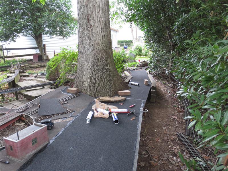

Ken, I haven’t glued it in place yet. I’m waiting to make sure the boards are dry, but it rained again last night. Maybe by the weekend. But, I’ve got a giant caulking gun size tube of black E-6000 that I’ll be using.

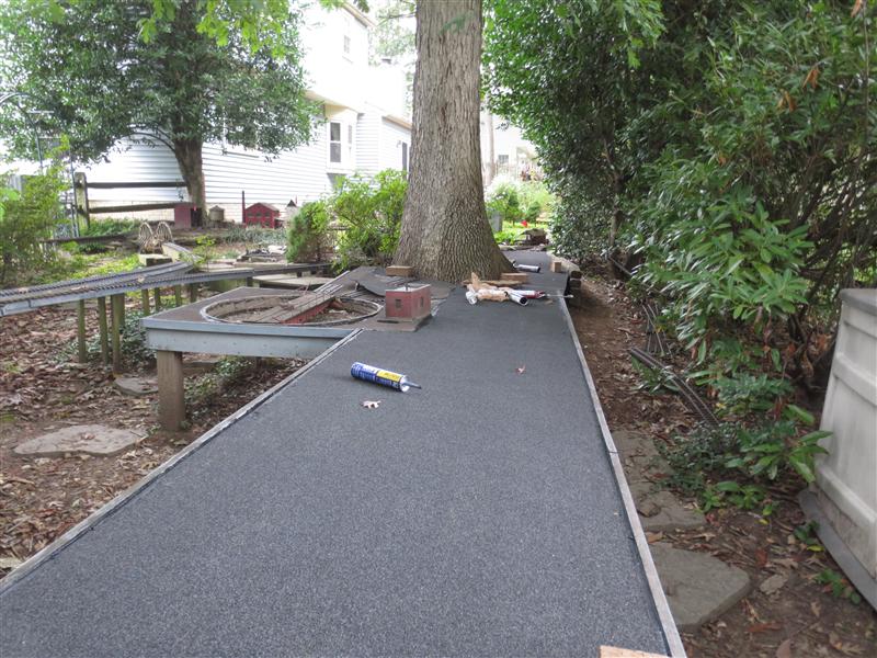

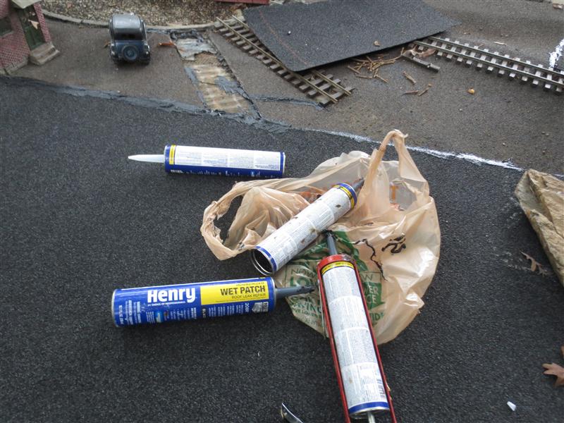

I started gluing everything in place today. The tube of E-6000 wasn’t even close to being enough, so I went over to Home Depot and got some patching cement.
It goes down much easier than the E-6000, and it’s made for this stuff anyway. I went through 3 tubes of the stuff; I may want another coat later. We’ll see.
I’m pretty pleased with the results so far.
The spikes I ordered from Switchcrafters came yesterday, so I should be able to start rebuilding the switches soon.
Looks real nice.
Ya missed your calling…ya shoulda been a roofer…:wink:

Right. You should have seen my hands. I thought I was being really neat with that stuff, but my hands ended up black.
Thanks, Jon. I sure hope this stuff lasts!
Is that granular roofing going to pass for ballast, or are you going to add some rocks?
I don’t think it will pass for ballast, but it will look better than half bare board half ballast in strange piles. No rocks will be added; there’s enough junk that falls from the trees to clog up the points.
Good to see the progress. Nice work and look.
Looks good. Hopefully the glue will keep things in check. We used similar rolled roofing on the live steam track out at the Colorado RR Museum, and two years later, it’s wrinkled and warped. We didn’t glue it, though. We just nailed it, so that’s likely a big contributing factor. It’s all coming out shortly so we can rebuild the track for next year’s convention.
