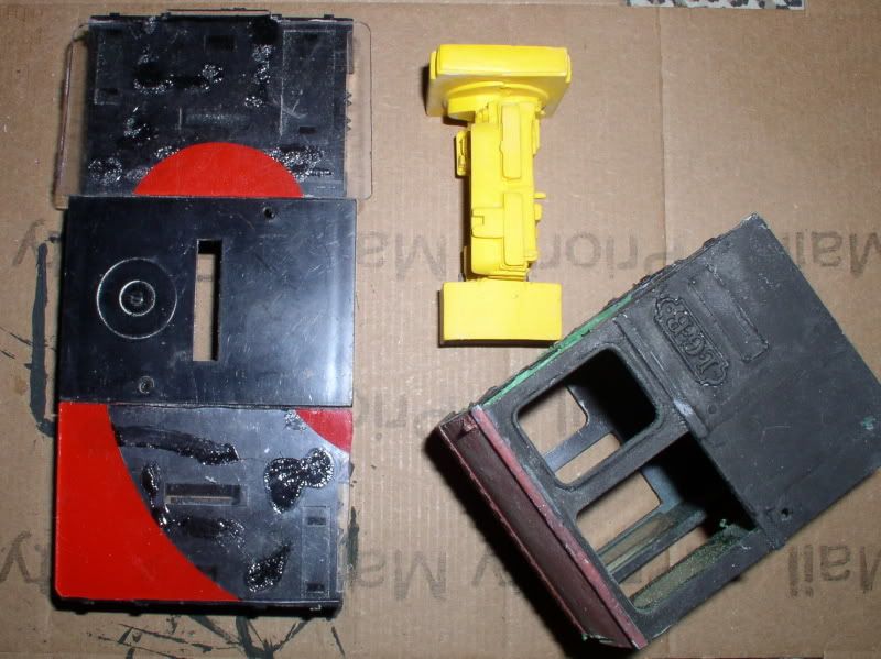

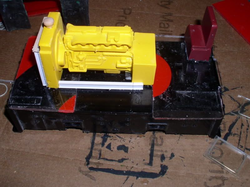

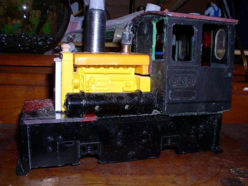

So I started working on a critter. One HLW mack base, one Larry G Scale gen set, one slightly mangled LGB 2017 cab, and some acrylic
With an idea roughly based on Plymouth practice, I started sticking it together
B’mann air tank and seat, Aristo toolbox on the other side, wooden 55 gallon drum for a fuel tank. I need to make a couple control levers yet…
Hood cut down from a plastic toy dozer, now waiting for the glue to dry so I can putty in the goobers…

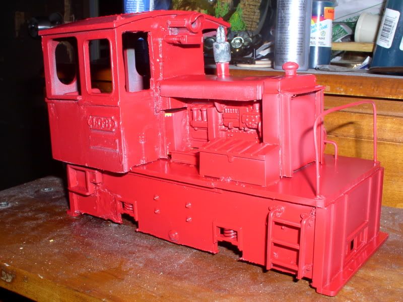

first color coat. Kim wanted red… it’s red. It might glow in the dark, too

I’m kinda partial to red myself :wink: Ralph

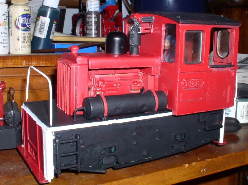

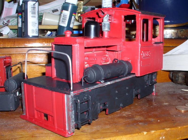

A Kalamazoo sand dome (yes, Plymouth actually did it that way, looks kinda goofy to me too), a Just Plain Folk engineer, and the second coat of colors. It’s starting to look like a locomotive, I think…
(http://i397.photobucket.com/albums/pp52/steamnut1917/critter/P5230002.jpg)
(http://i397.photobucket.com/albums/pp52/steamnut1917/critter/P5230001.jpg)
Did you give that engineer a nice, padded chair?

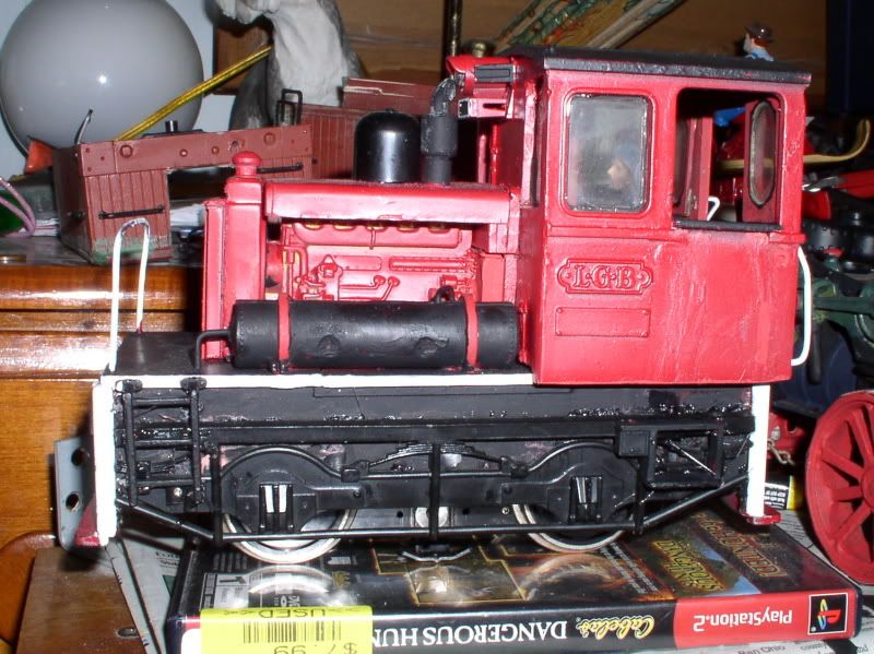

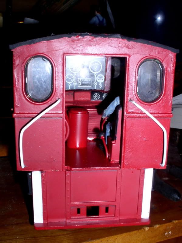

Doug, he got a B’mann coach seat. Probably quite a bit better than the stamped tin the real ones had… Anyway, while I was at it, I decided to cut the bottoms of the sideplates at an angle to make it more Plymouth-ish
(http://i397.photobucket.com/albums/pp52/steamnut1917/critter/P5230002_01.jpg)

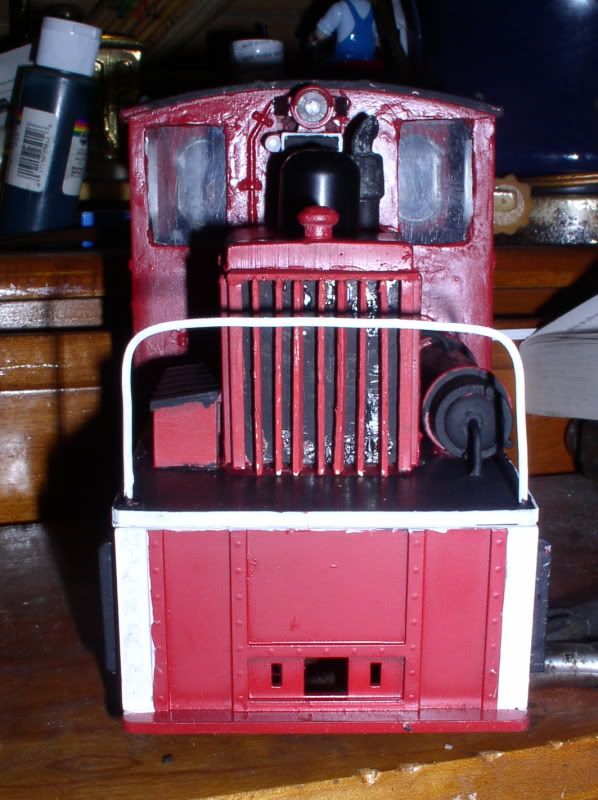

Front view… rather ugly, isn’t it?
(http://i397.photobucket.com/albums/pp52/steamnut1917/critter/P5230003.jpg)
Rear view
(http://i397.photobucket.com/albums/pp52/steamnut1917/critter/P5230001_01.jpg)
Still needs a bell, couplers, and brick

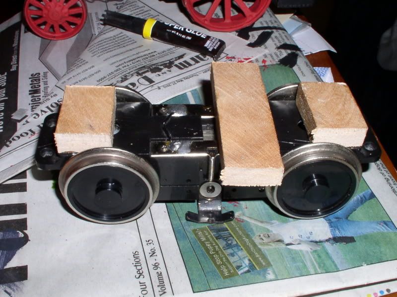

Yes, it’s a B’mann trolley drive. It’s wimpy and noisy and has a set of wheels that have a bit (maybe 1/16") of wobble - but at least they wobble together so it stays more or less in gauge, and it has skates for (maybe) decent power pickup… Did I mention that it was cheap? On the UP side, it came with some rather nice looking sideframes… And it was cheap!

The block has a bit longer wheelbase, but is lower than the HLW drive, so I made some wooden spacers

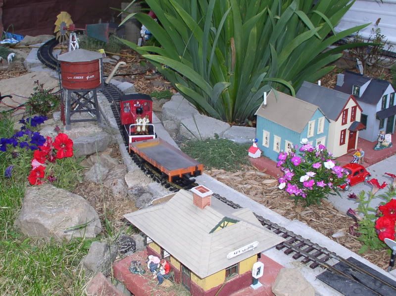

Maiden run…
(http://i397.photobucket.com/albums/pp52/steamnut1917/new%20AV/P6120006.jpg)
Them danged freeloading stowaways are at it again!.. Where’s Donald?
(http://i397.photobucket.com/albums/pp52/steamnut1917/new%20AV/P6120005.jpg)
It doesn’t pick up quite as well as a Stainz, so it was a bit jerky on the dirty track. It also wanted to run like a scalded cat or stall. I suppose I’ll need to clean the rails and try it again.
Looks great and fits the railway nice.
