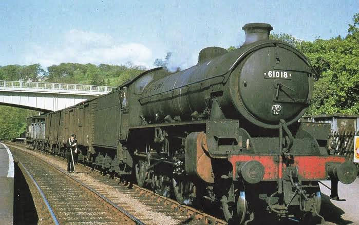

The UK was/is famous for the Fish & Chips, and the codfish was caught in the North Sea, mostly off the NE and Scottish coasts. Along with other catch, the codfish had to be transported to London and other markets, and the railways evolved to handle the traffic.
The primary transport was a Fish Van, which was insulated and had a longer wheelbase than the plain goods van. As the cargo was perishable, the fish trains ran at speed - 60mph and then 75mph after they retrofitted roller bearings. Here’s a train of empties being sent back for more.
There’s some fascinating information here:
https://www.bloodandcustard.net/bluespot.html
Occasionally they would add the fish van(s) to the front of a scheduled passenger train, as long as it wasn’t likely to exceed 60mph!
So, now I have a couple of LNER locomotives, the question arose of what freight they could pull. Fish Vans came to mind, though the locos did pull ‘regular’ pick-up goods trains. This pic of “Gnu” has a few goods vans an some mineral wagons - easy to find/buy.

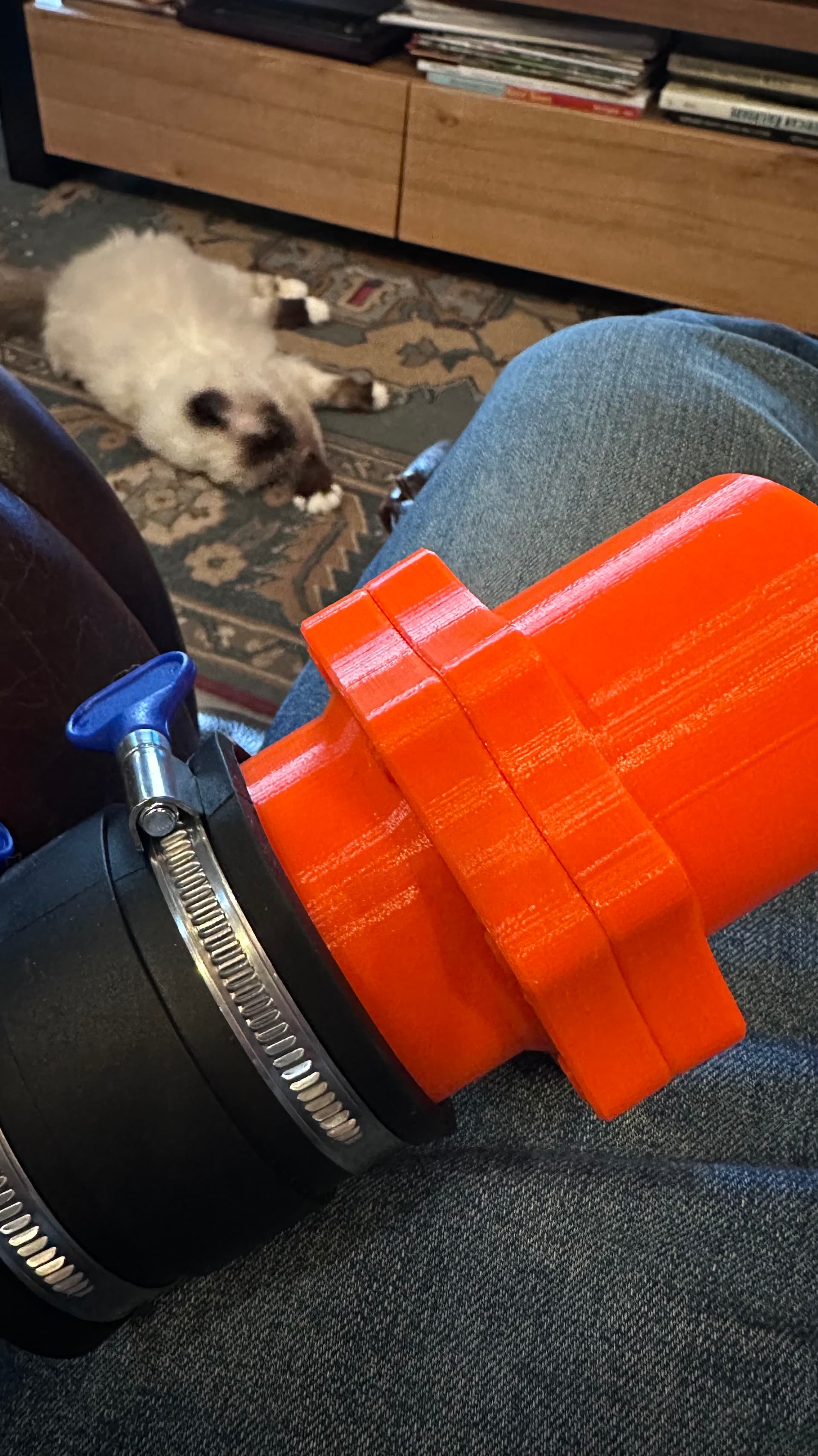

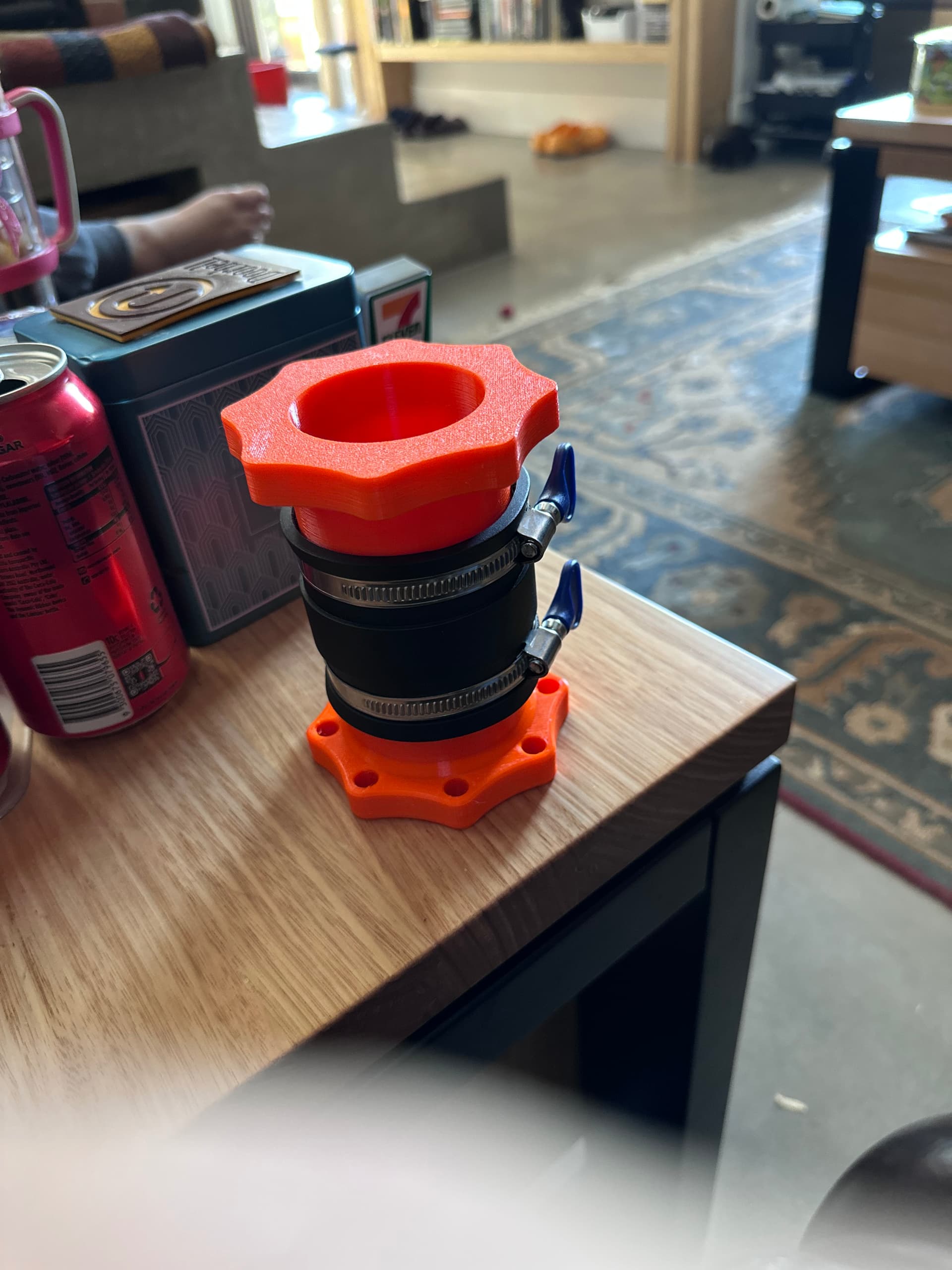

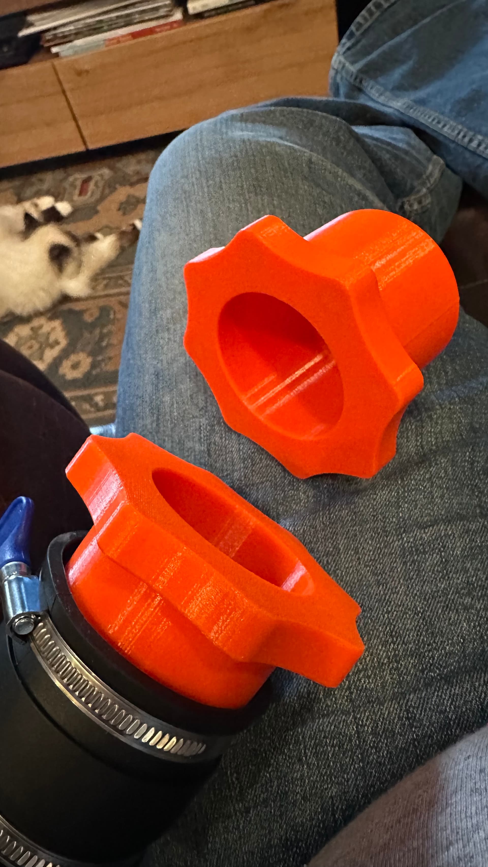

Here is the other up-side to having your own printer. Peter when Carbatec left town, I ended up purchasing a tool that had an unusual size dust port that wouldn’t fit my 4” port.
I just made these magnetic hose connectors to hook the machine to the dust collector.
