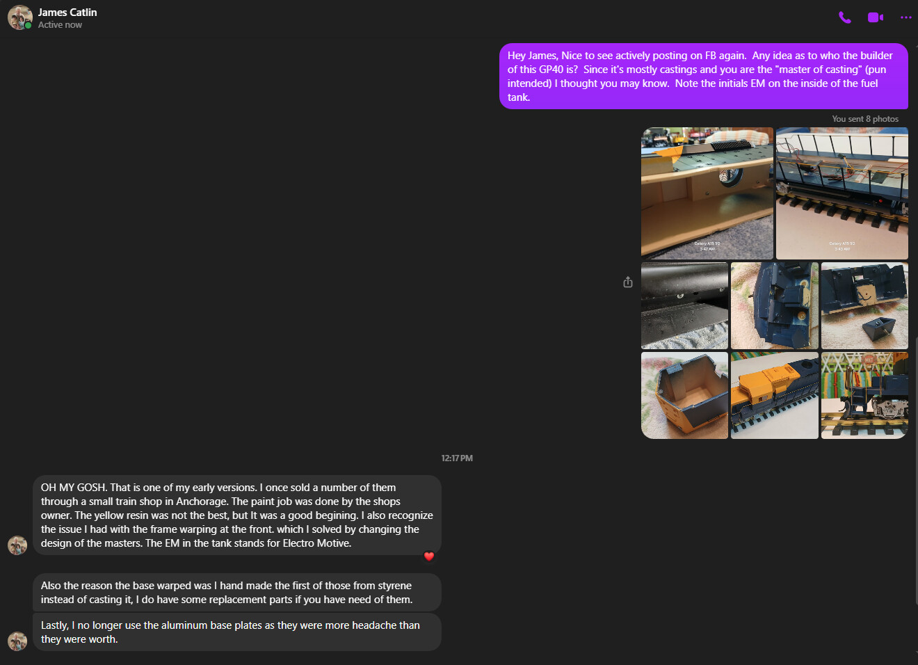

Mystery solved. I contacted James Catlin and here is his reply.

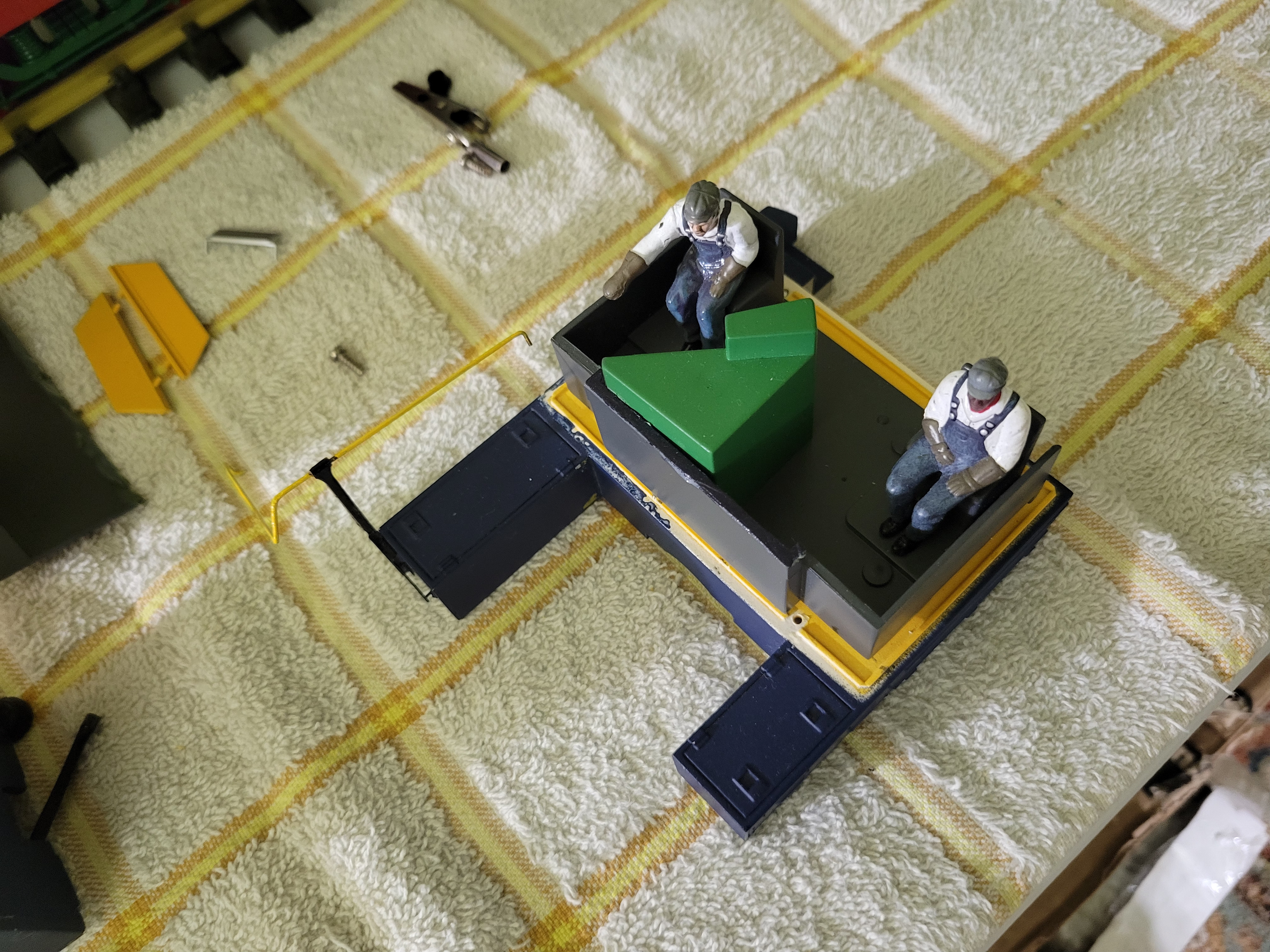

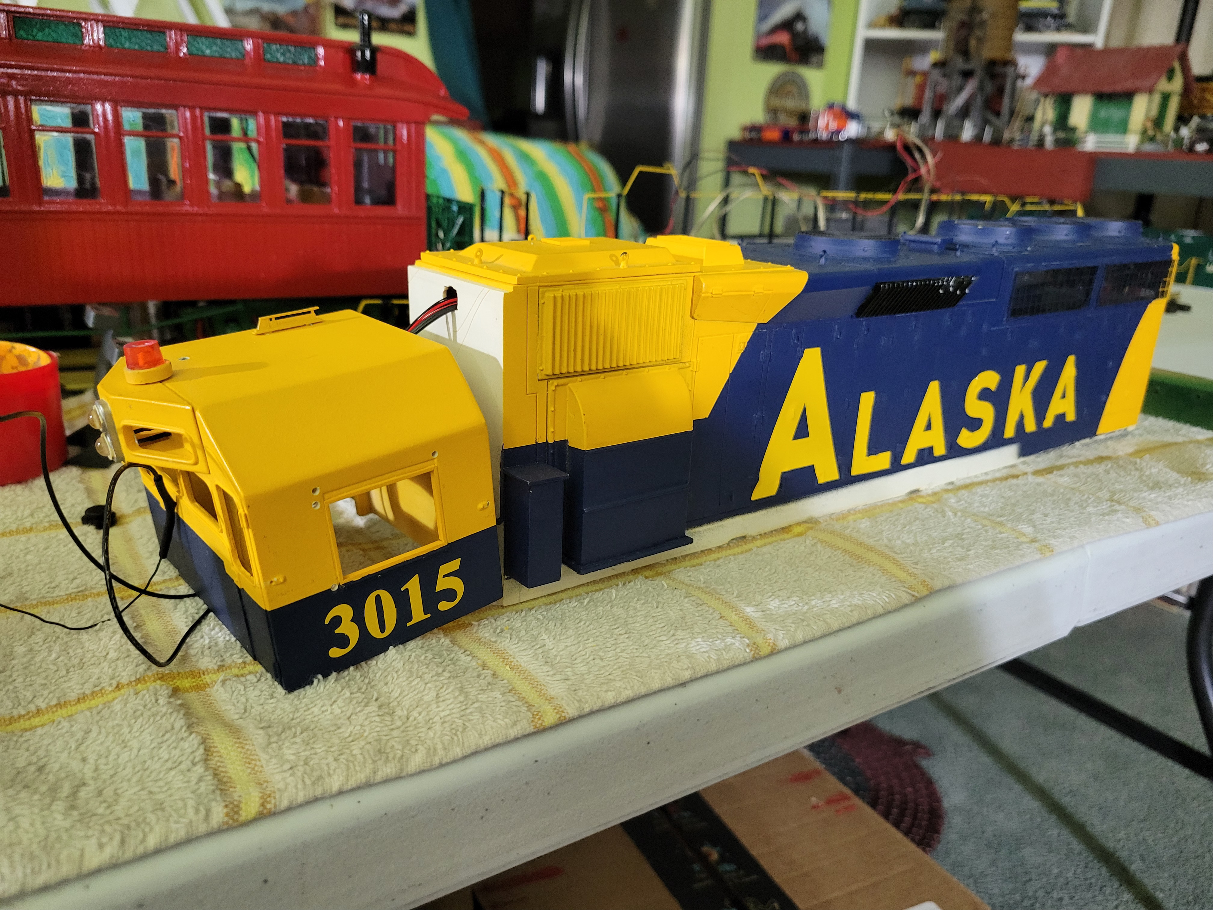

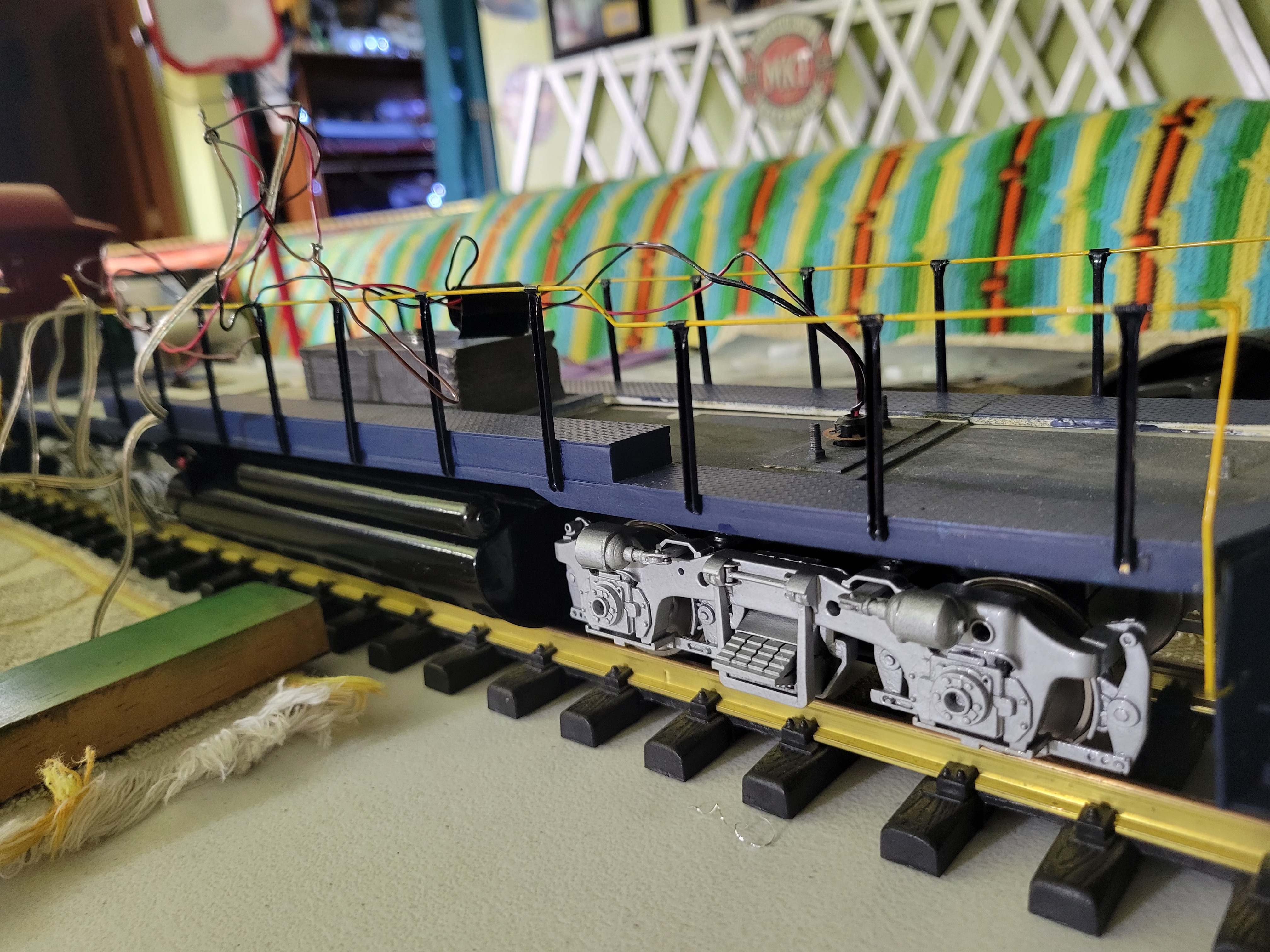

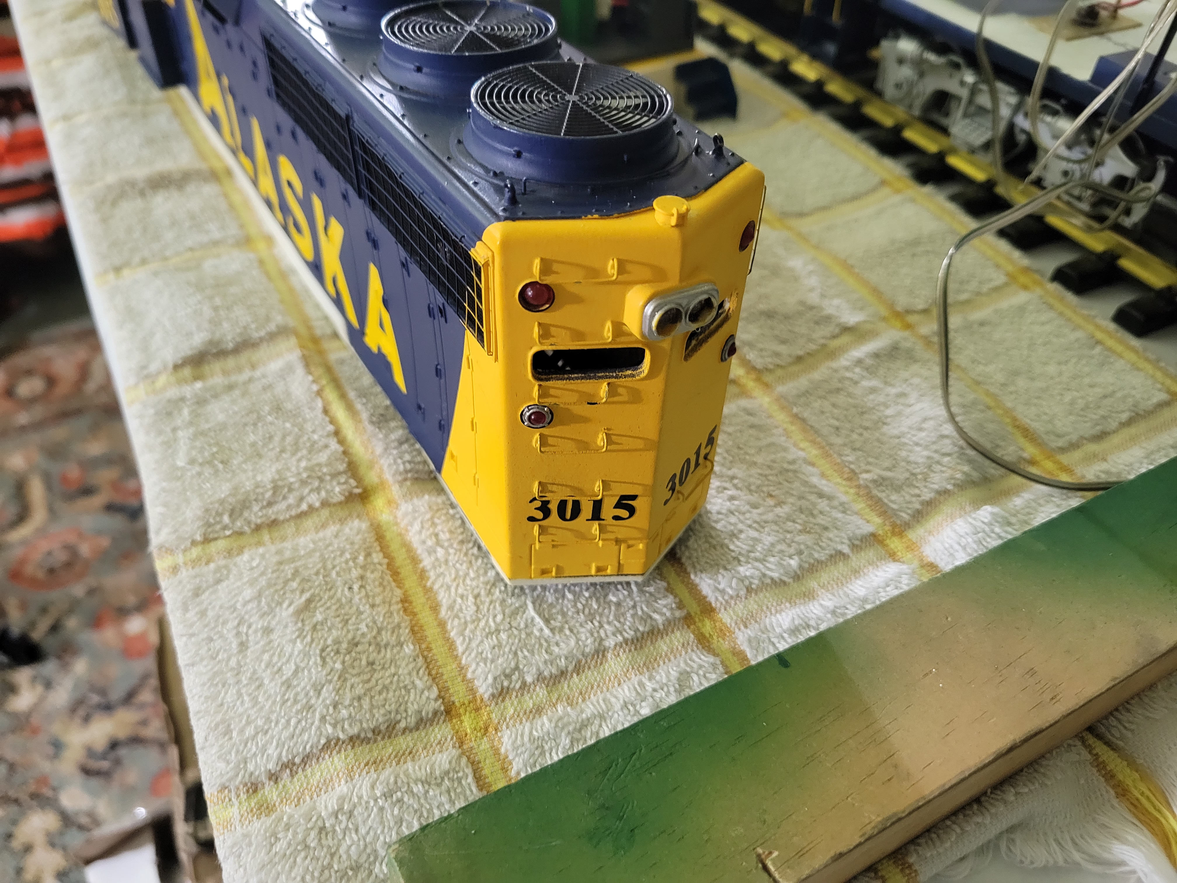

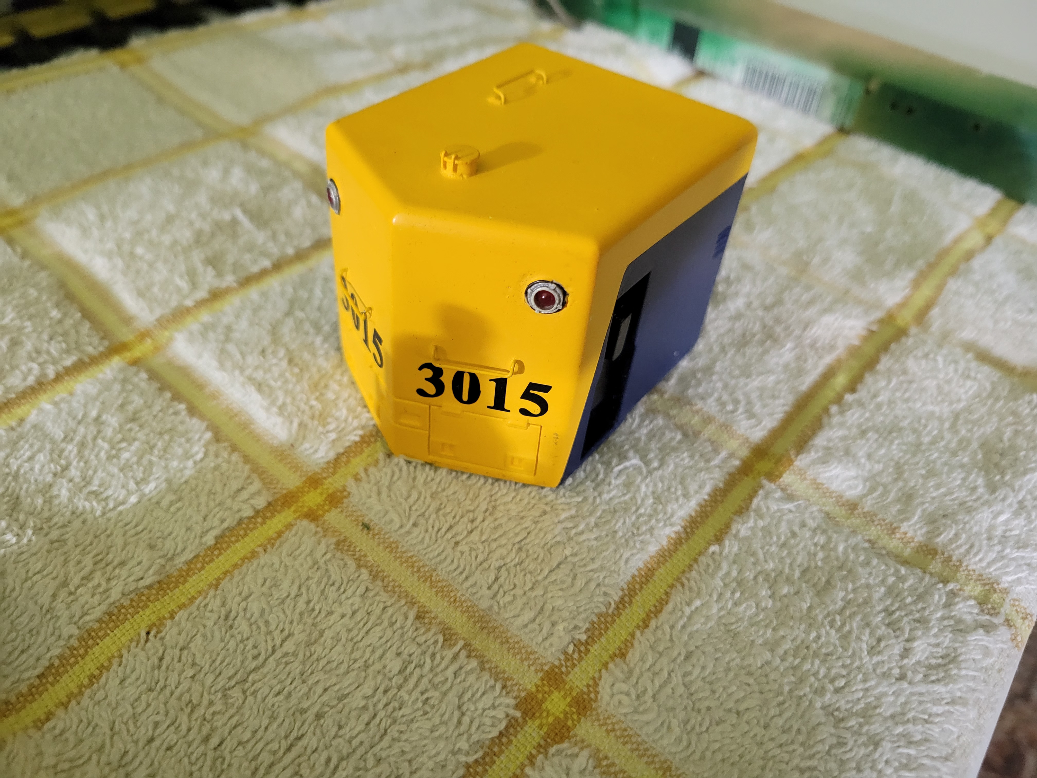

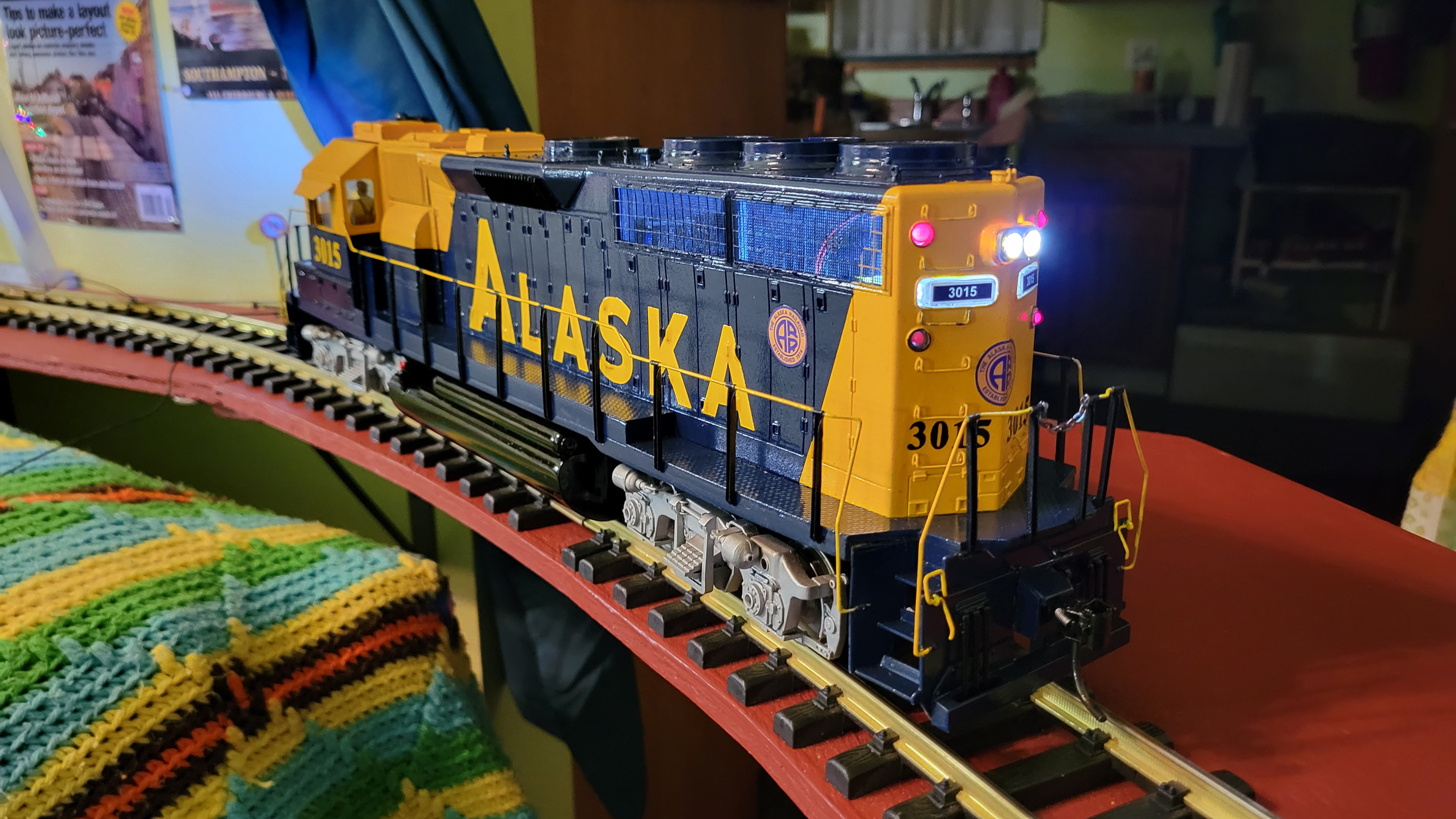

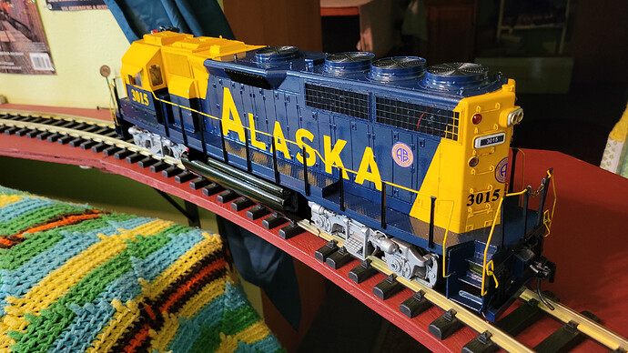

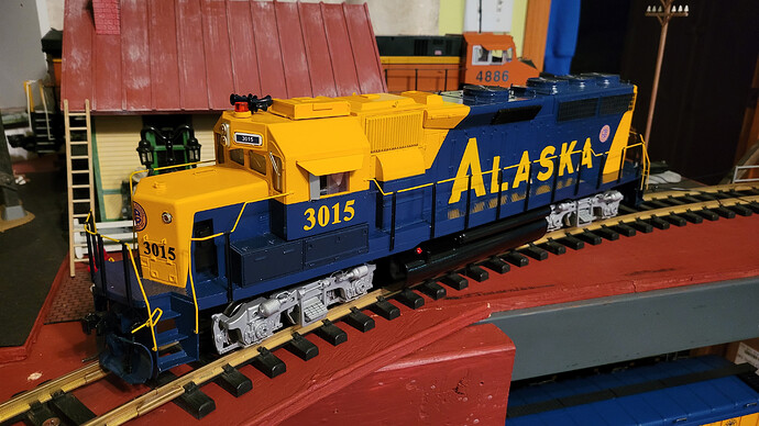

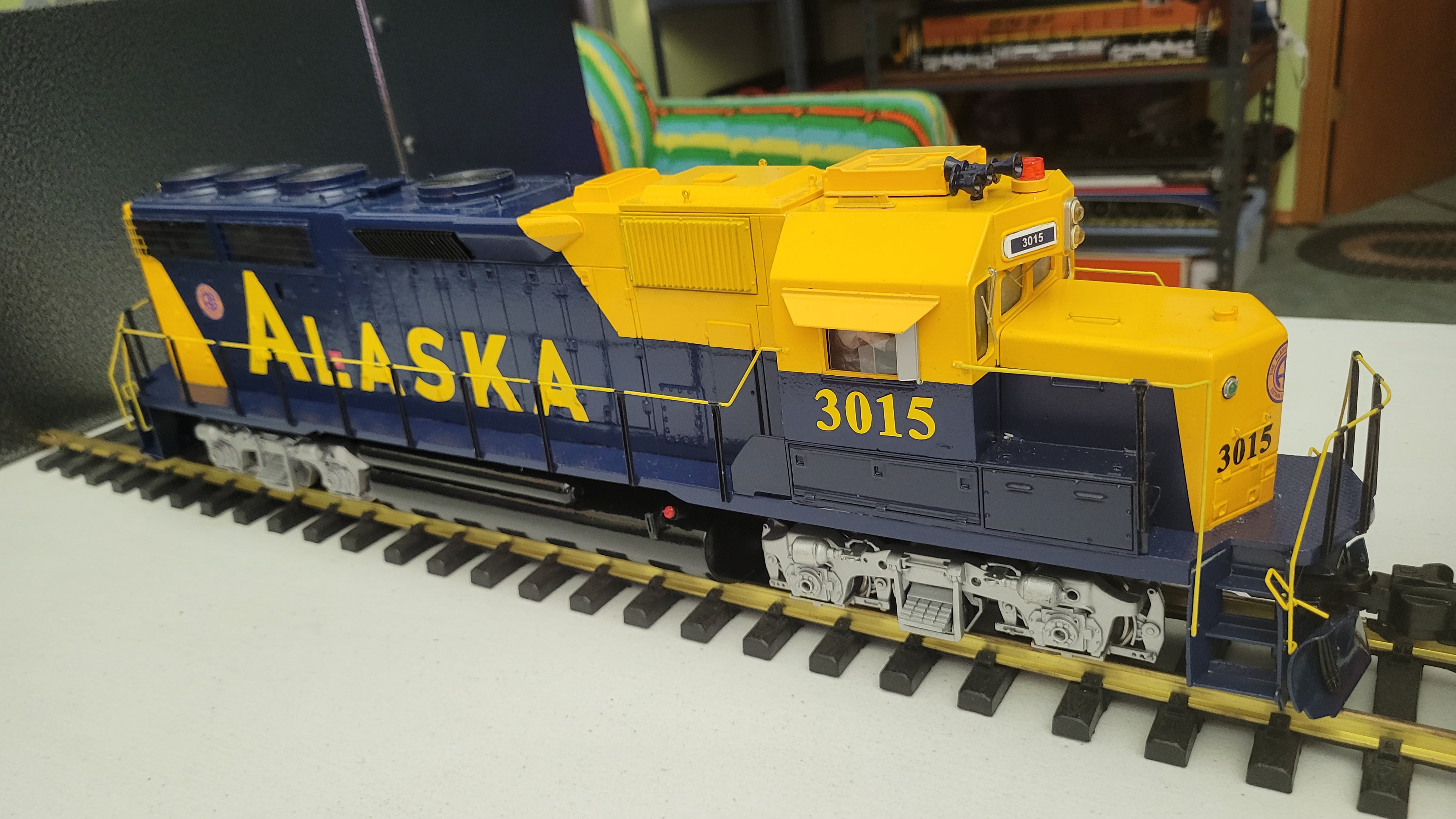

I have provided photos of some of the progress on the locomotive.
So far I have done the following;
Completely disassembled the trucks and oiled the bearings and axles and greased the gears.
I also installed grease plugs under each axle/gear to be able to grease it without disassembly.
I have installed a chain on the handrails.

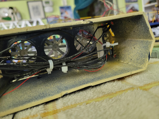

Installed horns, mirrors, windshield wipers, cab shades, air conditioner, interior cab details, engineer, cooling fans, number boards, etc.

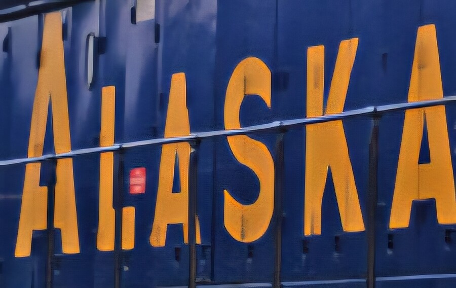

Purchased and installed graphics by G scale graphics.
Repainted/or painted fuel tank, frame, horns and other various parts.

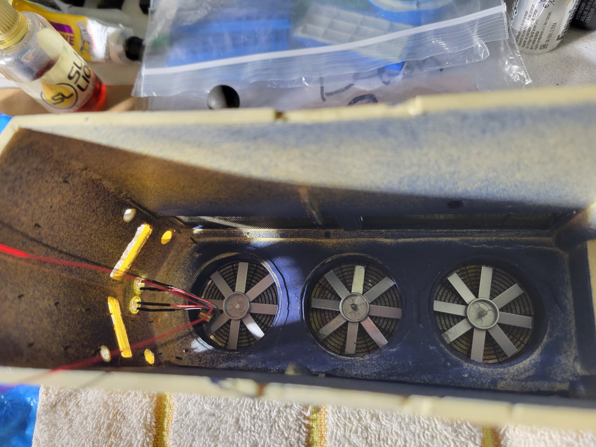

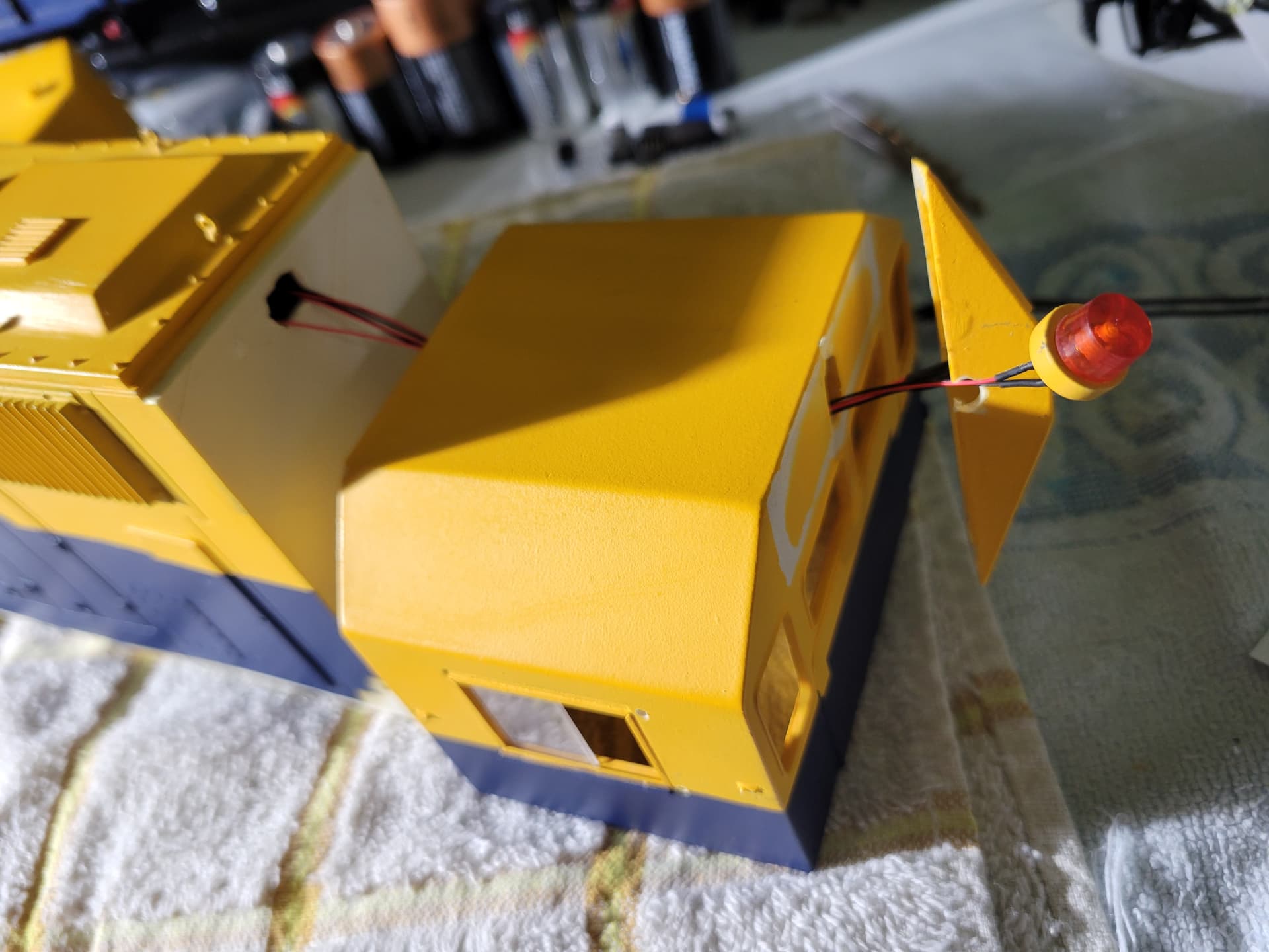

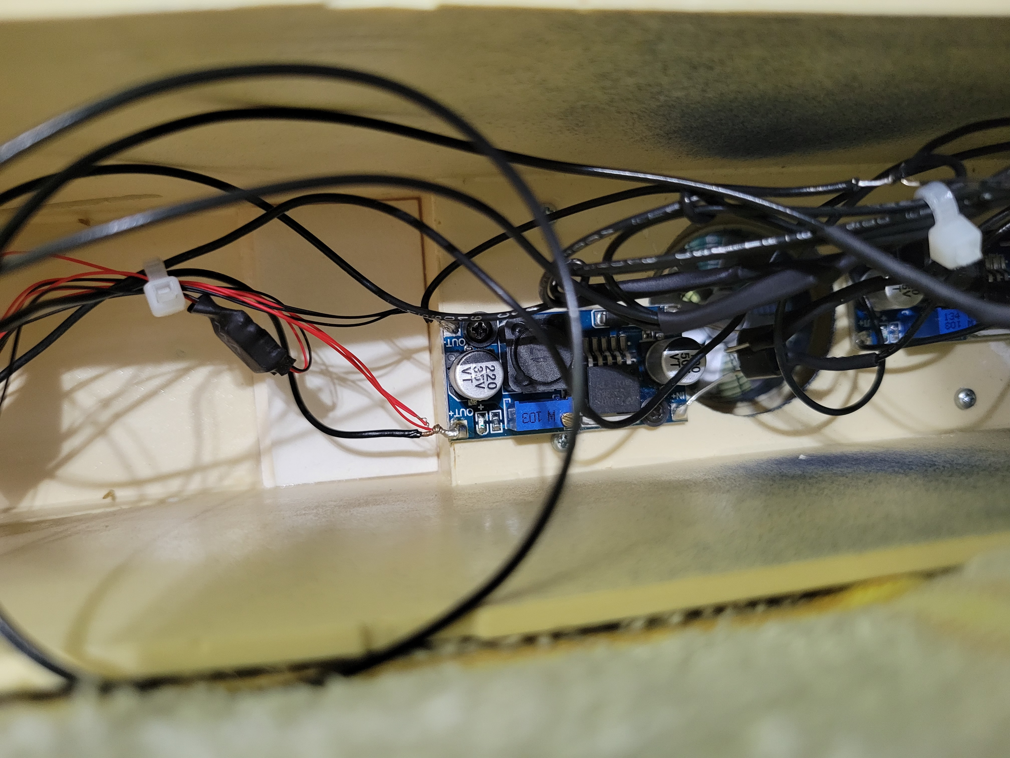

Largest job of all was the electrical which is 96 % completed including the following:

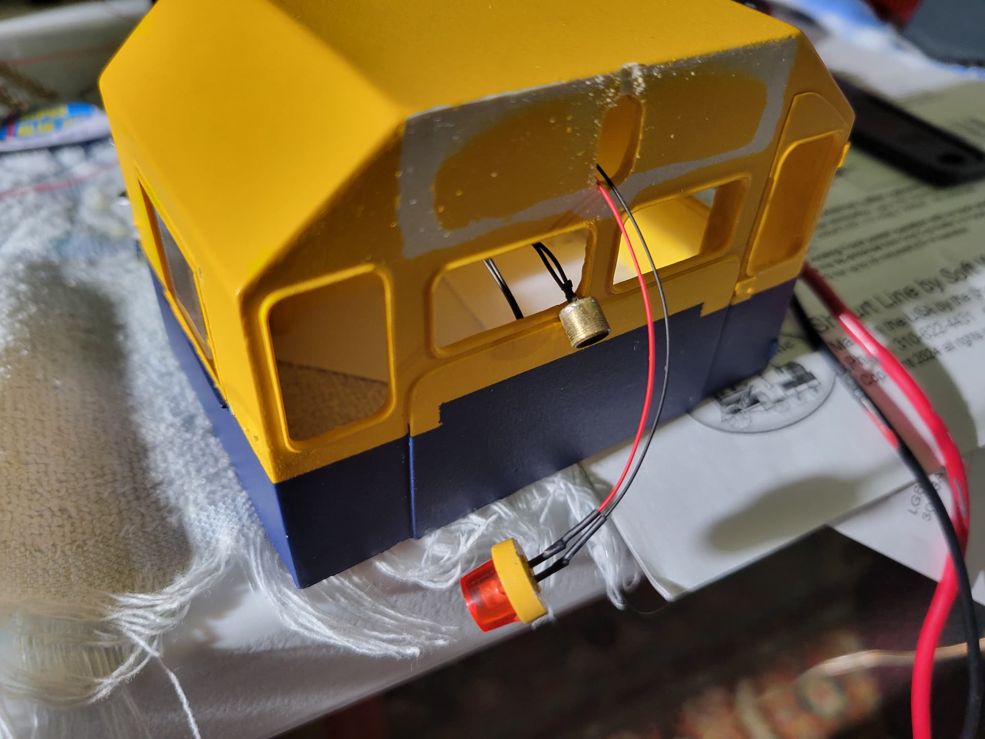

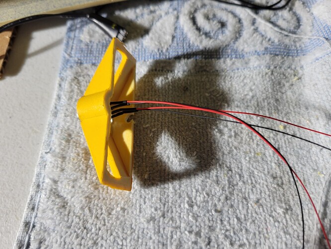

Installed 6 total, 3 mm red L.E.D’s for front and rear classification lights. (4 on the rear, 2 on the nose.
Installed 4 cool white 3 volt L.E.D’s for headlights on the front and back.
The locomotive won’t have the extra top horizontal headlight like the prototype does but it should still look ok.
Installed a flashing strobe light by Evans Designs, that Alaska Railroad had at the front top of the cab, using a 3 volt flashing L.E.D. with an LGB modern caboose top globe.
Installed a number board light at the rear.
(front wasn’t needed due to reflective light from the tightly enclosed headlight and number board assembly)

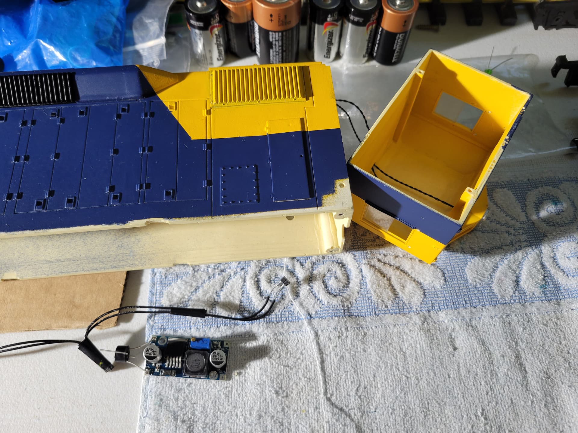

Installed and wired in adjustable 3 volt and 1.3 volt circuit boards from Shourtline to control it all.
It’s definitely lit up.

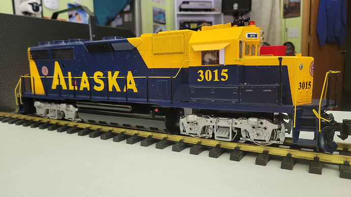

The photos are various stages and yes there was a slight warp but some has been taken out by heating adjustment.
The locomotive is not as precise as I’d like it but it will be clear coated and used in our program as soon as it’s completed and I think it’ll be fine. The one photo looks like it is really warped badly for some reason but it’s actually not at all. Maybe it’s the lighting or the way I took the photo.

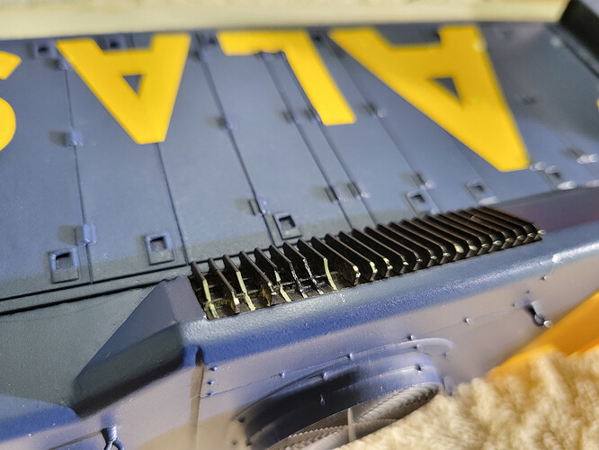

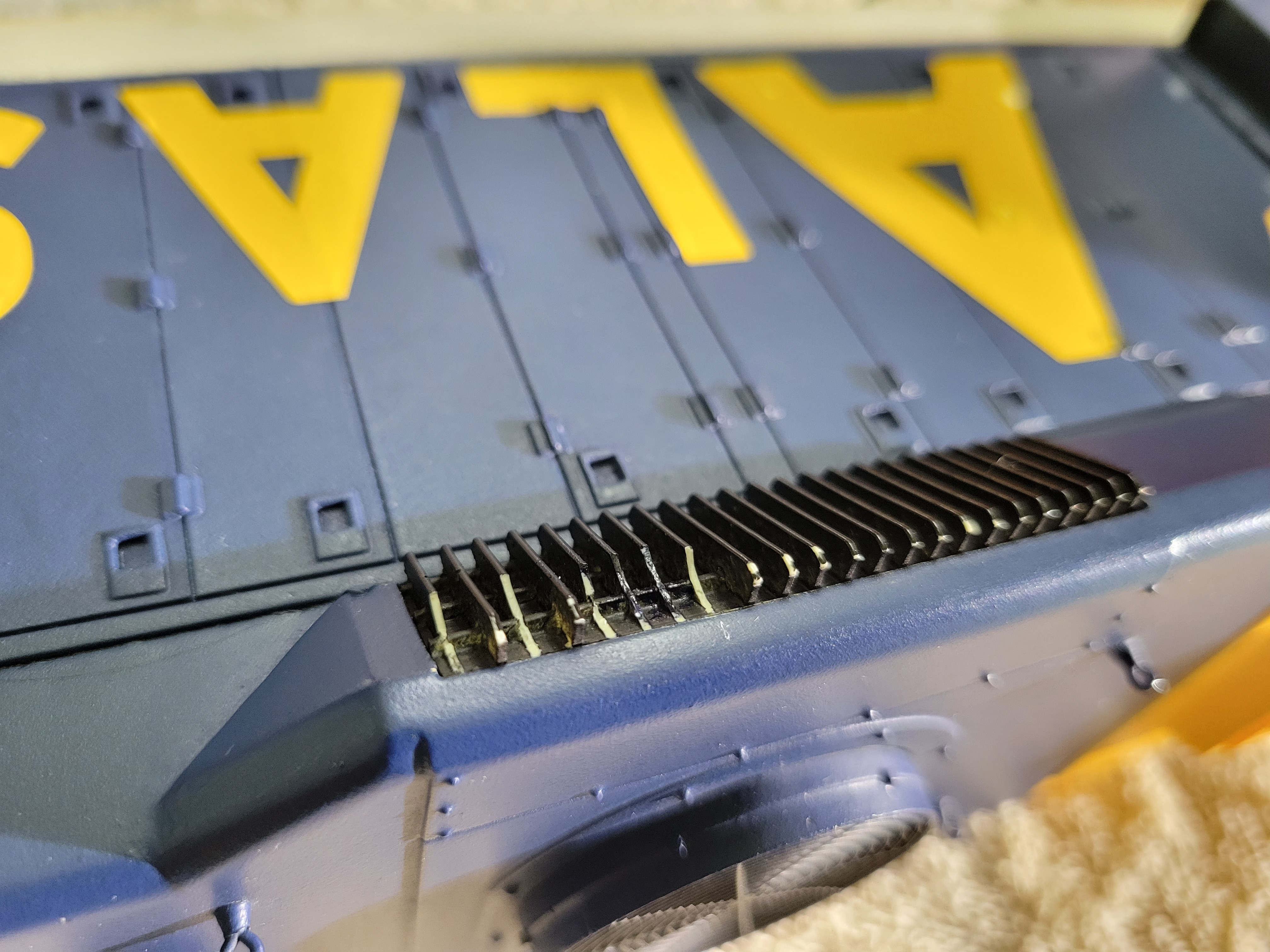

The only 2 problems I can’t fix is the broken radiator fin on the one side (as in the photos) and the long hood vents that are missing and one has glue on it, so contacting James is a miracle, to say the least.
Maybe he has some parts.
Any help would be appreciated and I will definitely check out the website.
Thanks Dan and hopefully I can get ahold of him.
Prototype photos are the property of their prospective owners.
Ken
A few more photos of the locomotive uncompleted. The interior cab figures and consoles are actually from an MTH one guage F3 body I had, since I couldn’t locate anything else. It’s got a ways to go yet.
Hopefully it’ll come out ok when completed!
Hello, My name is James Catlin and I am the manufacturer of this GP40-2 which I produced along with my GP38-2 over twenty years ago. At that time My company was called North Star Railway Models. I only produced them for a couple years as I had a family and job that took priority over my modeling pasion. I lived in Alaska at the time so thats why I had that name. Different name now. The mdel is 1/32 scale as I have been collecting 1/32 scale things since the late 60’s. It is cast resin, brass and other materials. I still manufacture the side frames as I still build my own locomotives. Each side frame consists of approximately 15 individually cast parts, unlike Ralph brown’s which were one part castings. As of today I have reached out to Kenneth and hopefully we can connect sometime soon.

Just a little bit more on creation of my models, The handrails are K&S brass rod bent by hand for each loco, so it’s an intesive build, The stanchions are brass from patterns I drew by hand and then had the brass photo etched which were then formed on a jig I made. The lift rings are simple eye pins I get from Micromark.com. The fan grills, radiator grills and and a few other items are also photo etched from my artwork which was hand drawn at the time. I use Adobe Illustrator now for my artwork. All the masters for the resin parts were hand made in either Styrene or ABS plastic from which I made the silicone molds. Image is me with one of my GP38-2 loco’s which is the same body as the GP40-2. All my creations are fully modular so I can make variations. Lastly since NWSL no longer makes their 1/32 scale motor blocks I make my own.

Hello,

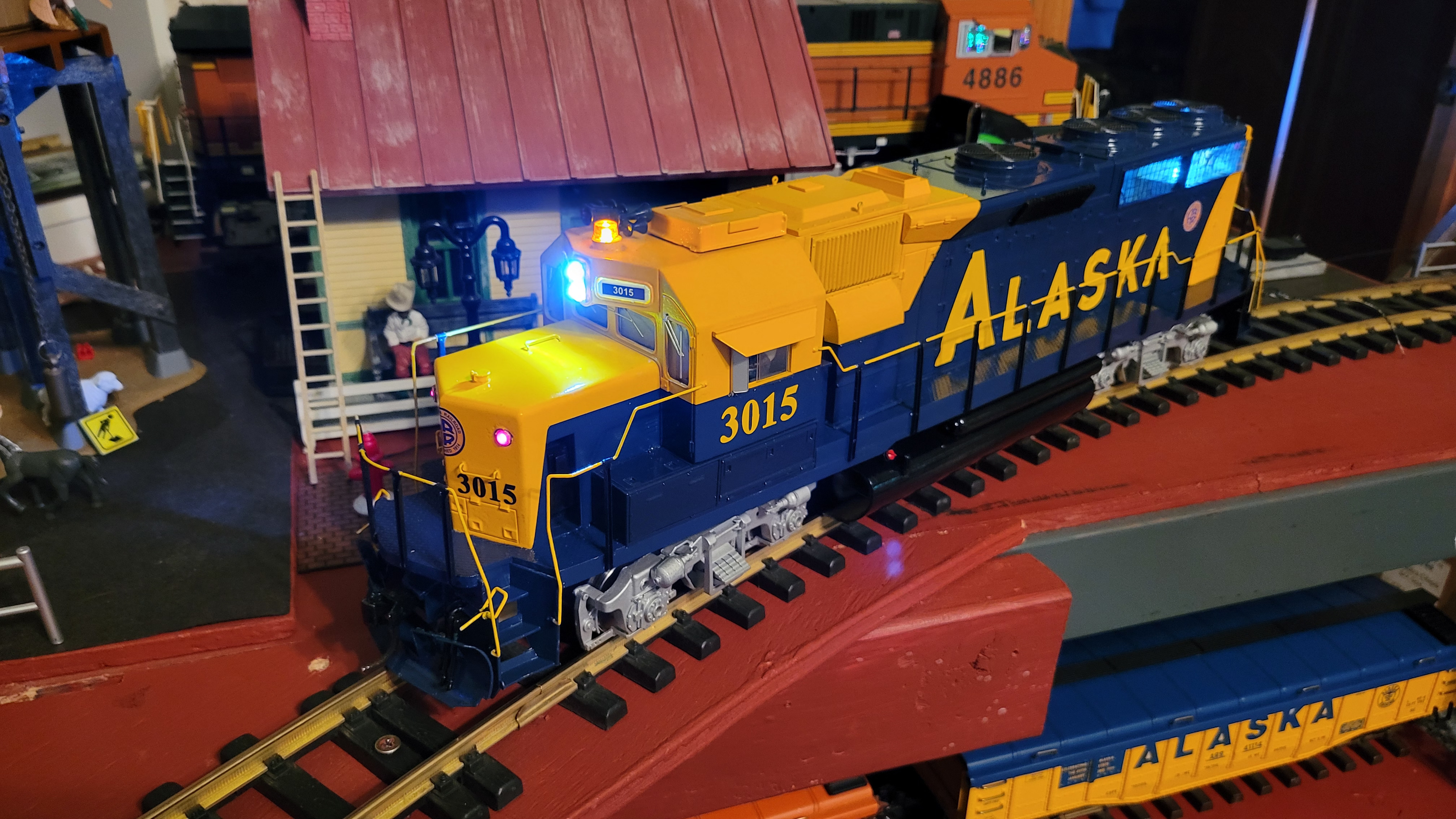

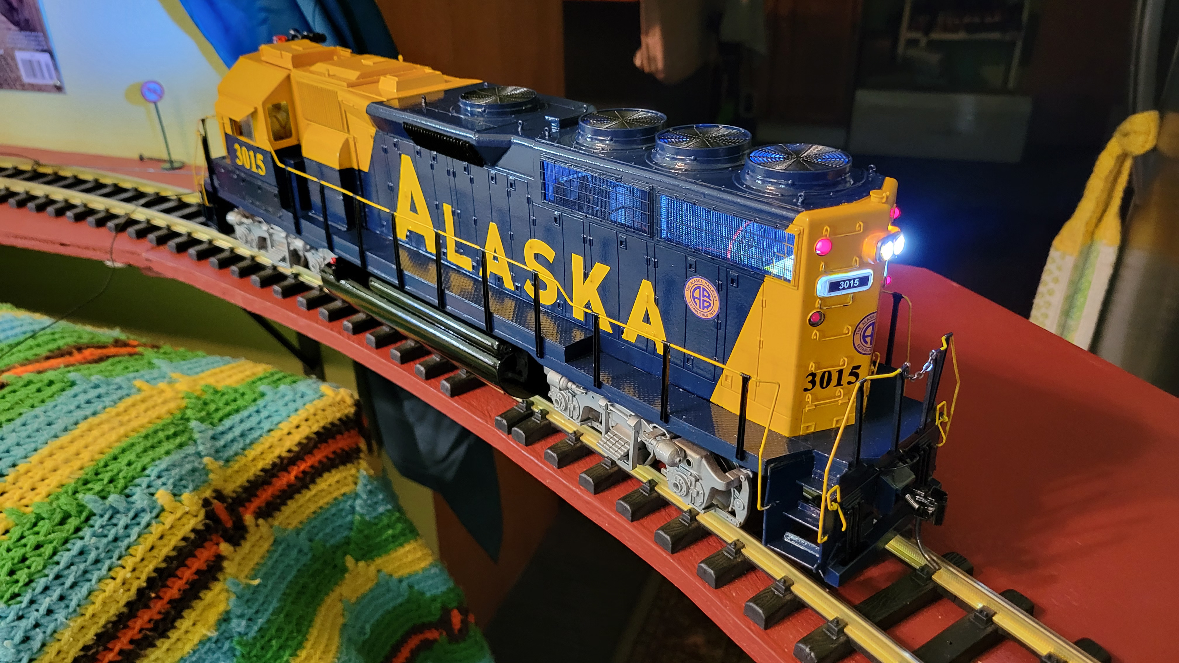

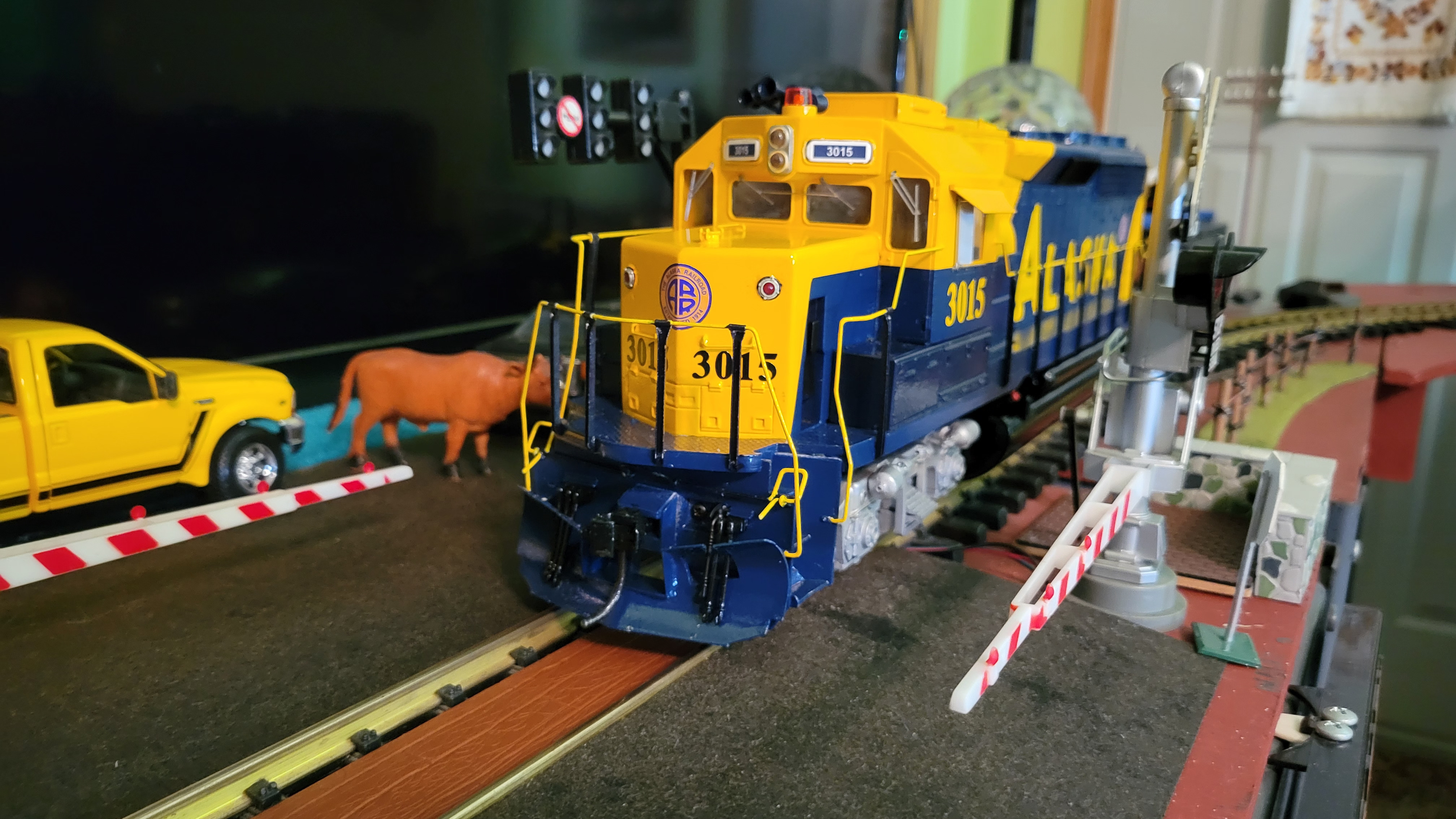

I have spent countless hours trying to refurbish this locomotive and am very close to getting it completed. Since this was posted a lot of things were done to the locomotive to bring it back to presentable condition.

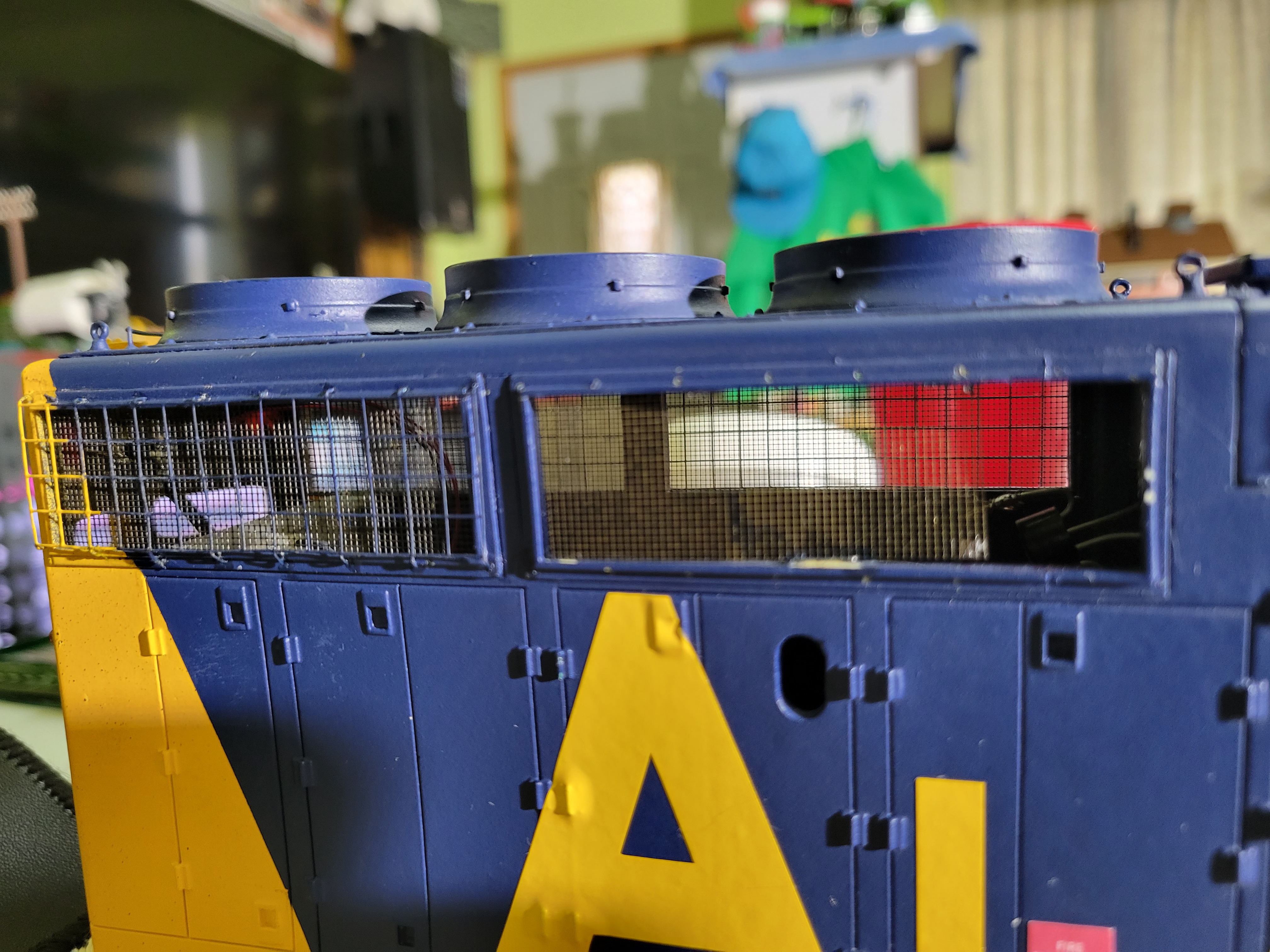

I have repaired and repainted the handrails by hand, fixed broken brakes, added L.E.D’s, (all around) added interior cab details and crew members, installed grease ports, installed windows, (thanks to James Catlin) Installed a flashing strobe, bell, windshield wipers, horn, cab shades, mirrors, air and brake hoses, a.c. unit, number boards and fixed rear air intake grills, or whatever they are called.
Once again, I want to express my sincere gratitude to James Catlin for supplying the grills, windows, windshield wipers, and bell.
Without his help, I simply couldn’t have done this project.
The locomotive operates flawlessly and has plenty of power, however it still needs matching paint yet on the battery box areas which seems impossible to find in a lighter blue shade (spray) of Alaska blue, since I don’t have an airbrush system to work with.
I need someone who sells a huge variety of plastc compatible colors that could match the current color.

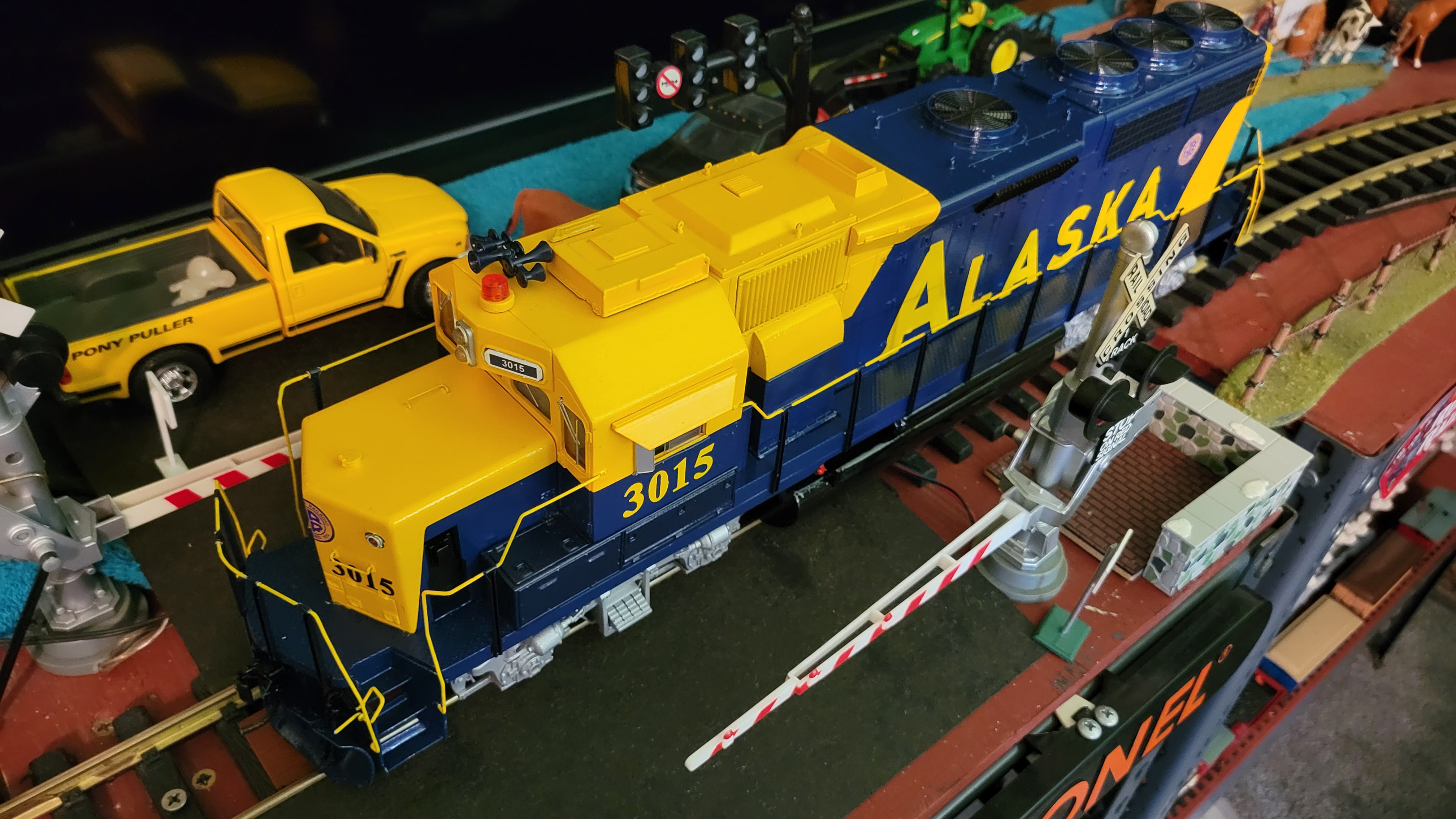

Any ideas on getting a slightly lighter shade of blue in a spray would be fantastic because the original purchaser painted this engine in a different type of blue at the time than today’s current Alaska blue. Tamiya did not seem to have a match.
I also need to lower the couplers because we can’t pull any of our freight cars because the couplers are way to high, as most of our cars are stock height with Aristocraft couplers.
Not sure if Kadee offers a coupler lowering kit?
There are a lot of things on the locomotive that don’t meet my expectations and are less than perfect by a long way but I think the public will still enjoy operating it.
I am getting older and my health/vision isn’t great but I guess it came out a lot better than when it was received anyway.

I am waiting on the matching paint to be delivered and will paint the battery boxes that are currently dark blue primer to match correctly and that should do it.
Thanks Eric and for everyone else’s help also.
Ken
