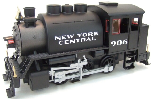

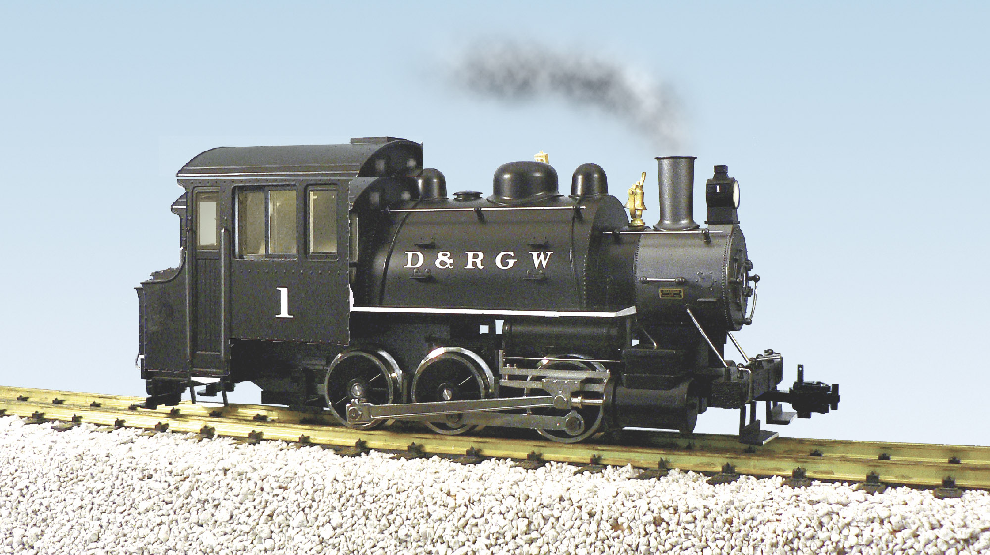

John, if you are talking about this beast:
Then it is certainly heavy enough. Just don’t drop it on your toes! I believe they run nicely - my pal (@naptowneng ) has one. I don’t know anything about adding r/c.
It is 1/29th scale and therefore will look a bit squashed compared with Fn3 or SM32 slate cars. A taller cab would help.

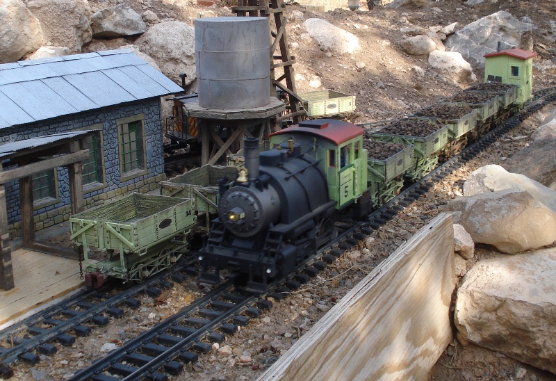

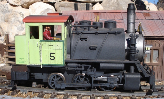

John, this is my mine train. It is built from a Piko 0-6-0 saddle tanker. I added details and enlarged the cab as Pete has mentioned to get it up to 1/20.3.
It uses a 0-6-0 motor block clone of LGB. Replacement parts including the entire motor block are available from Piko.
It was easy to disassemble as everything is screwed together from underneath. Three is a substantial weight in the boiler which if removed could be adequate room for batteries and boards.

Plastic drivers. Looks pretty good after painting and weathering but a clever guy could make new ones out of brass.
It will easily pull 8-10 of the Bmann side dumps.
Hope that helps. Look forward to seeing your project.

Good runners, heavy and pull very well.
Electronics a mess, terrible sound system, and chuff switch circuit needs work. One of the few locos that I would say rip it all out.
Smoke unit actually has a piston for puffing smoke, but smoke generator weak.
already a nice place for the speaker, stock is ok.
