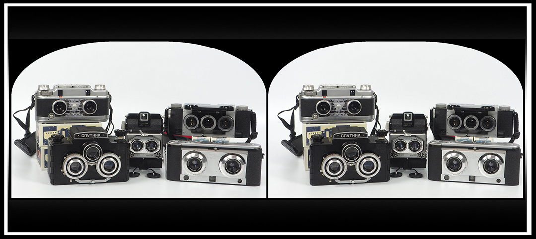

An update, I finished up my first roll of film in the 3D camera. Dropped it off at the local camera shop. They will send it to Kodak in New York. Three week turn around. :frowning_face: They will not cut the transparent film, I hope. Then I will mount them in the 3D slides.
Ohio River & Western Railway
Got the transparencies back from New York. 70-year-old camera not always operating the shutter. Still got a few pictures, I will post when I get the film cut and mounted.
Wayne, are you happy enough with the camera, that you’ll continue to use it?
Not in it’s current condition. Today I just got the light box so I will be able to easily view what images are on the film strip. Little confusing as they run: AR BR CR AL BL CL DR ER etc… Two exposures between the right and left lenses. Did that make sense?
There doesn’t seem to be anyone around that might be able to fix the shutter. Maybe more dry fires to see if it starts working more consistently.
I was reading this blog and it mentions a Dr. T in Ohio who I wonder might be able to point out where to get help in the USA.
Bill, very useful for me. I found Ohio’s Dr.T’s website. With the phone number listed I called and we talked. Turned out he was the Ebay seller that I bought the 3D slide mounts from. He did not know of anyone repairing the TDC camera I have, but he knows a lot about the Stereo Realistic cameras. I may go deeper in the rabbit hole and get a camera from him.
