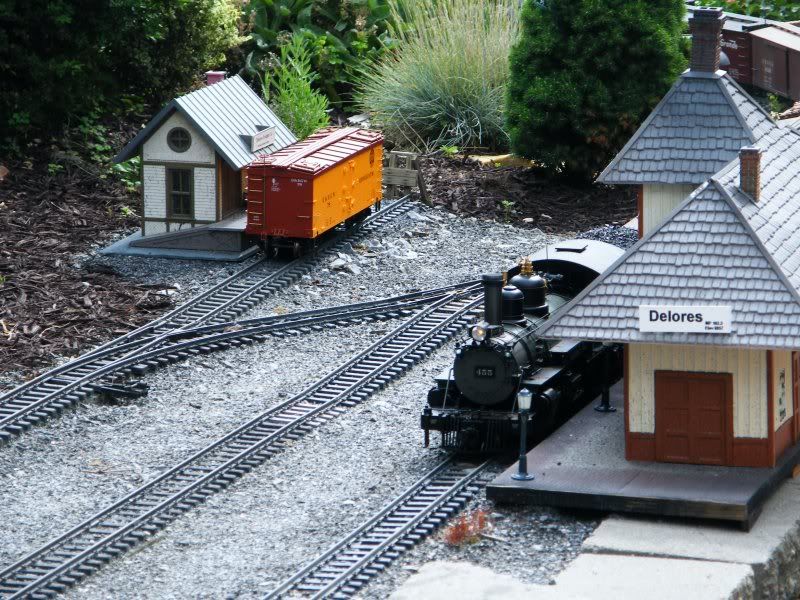

Well, no, not really. They may last a year or two, but the UV spray doesn’t keep the colors from fading. I’ve tried Krylon’s and the stuff Papillo sells and neither one works all that well. So now I just print the signs out in Black on white or white on black. The black ink doesn’t fade as fast for some reason. If I do color sign I print out a couple and when the one fades I’ll replace it with a new one. I looked into UV resistant inks but the cost was way too much.
(http://i253.photobucket.com/albums/hh58/rgseng/K-27/K27007.jpg)
The signs on both these building were done in blue and given about 5 coats of UV spray. Both faded in a year or 2. The black sign on the side of the hotel is still in good shape. As is the “Delores” on the depot…
(http://i253.photobucket.com/albums/hh58/rgseng/K-27/K27005.jpg)
