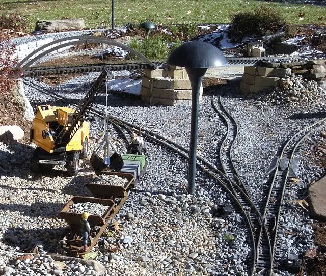

Steve Featherkile said:
You will have to be extra careful of “S” curves, though
and then sometimes a good S curve is a necessary evil -
-Brian

I planned several “S” curves to break up long straights. They weren’t necessary, but make the circuit visually interesting. They haven’t caused any uncoupling or derailment problems for me. Ralph

And if you have room, the S curve is no problem at all. Photos of Jens Bang’s Snake River RR in Spirit Lake, ID
