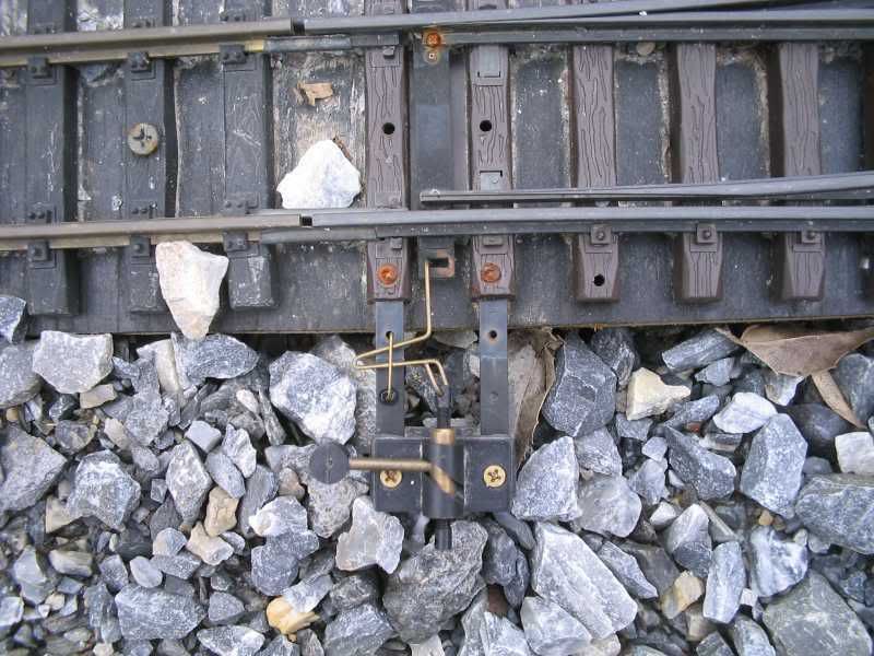

I have some Sunset Valley Switch Stands
[img][img]
I know how to install them but I was wondering if anyone has some tips for how they do it.

Maybe I should rephraise the question.
I read somewhere someone using a springing action in the throwbar to allow some tightness in the switch. But, I cant seem to find where I saw that.
I guess I’m wondering if I should just use a straight piece of wire and hook it to the stand and the switch or should I use a “springing” action type wire.
I usually put a “V” in the wire (1/2" or less), that way you have some leeway if you need to adjust it.
(http://i253.photobucket.com/albums/hh58/rgseng/rgs0010.jpg)
Ah, thats what I was looking for. It also looks like you put a piece of wire to scure the loop so it stays in one place?

Jake, That piece of wire is to keep it flat. With the Temille throws it has a tendency to lift up when the switch is thrown and get in the way.
Gerry, I’ve never tried that, intentionally anyway, but it’s a pretty stiff piece of wire, so it probably won’t. It’s mainly for adjustment purposes.
Jake,
Go over to Sunset Valley’s website and click on the link for switches. At the extreme bottom of that page, there are two small photos of the springs that you make from paper clips. That’s what I use on my SV switch stands.
I use that method on a few switches too.
(http://i253.photobucket.com/albums/hh58/rgseng/rgs009.jpg)
Safety Pins work good too.
