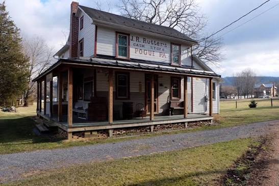

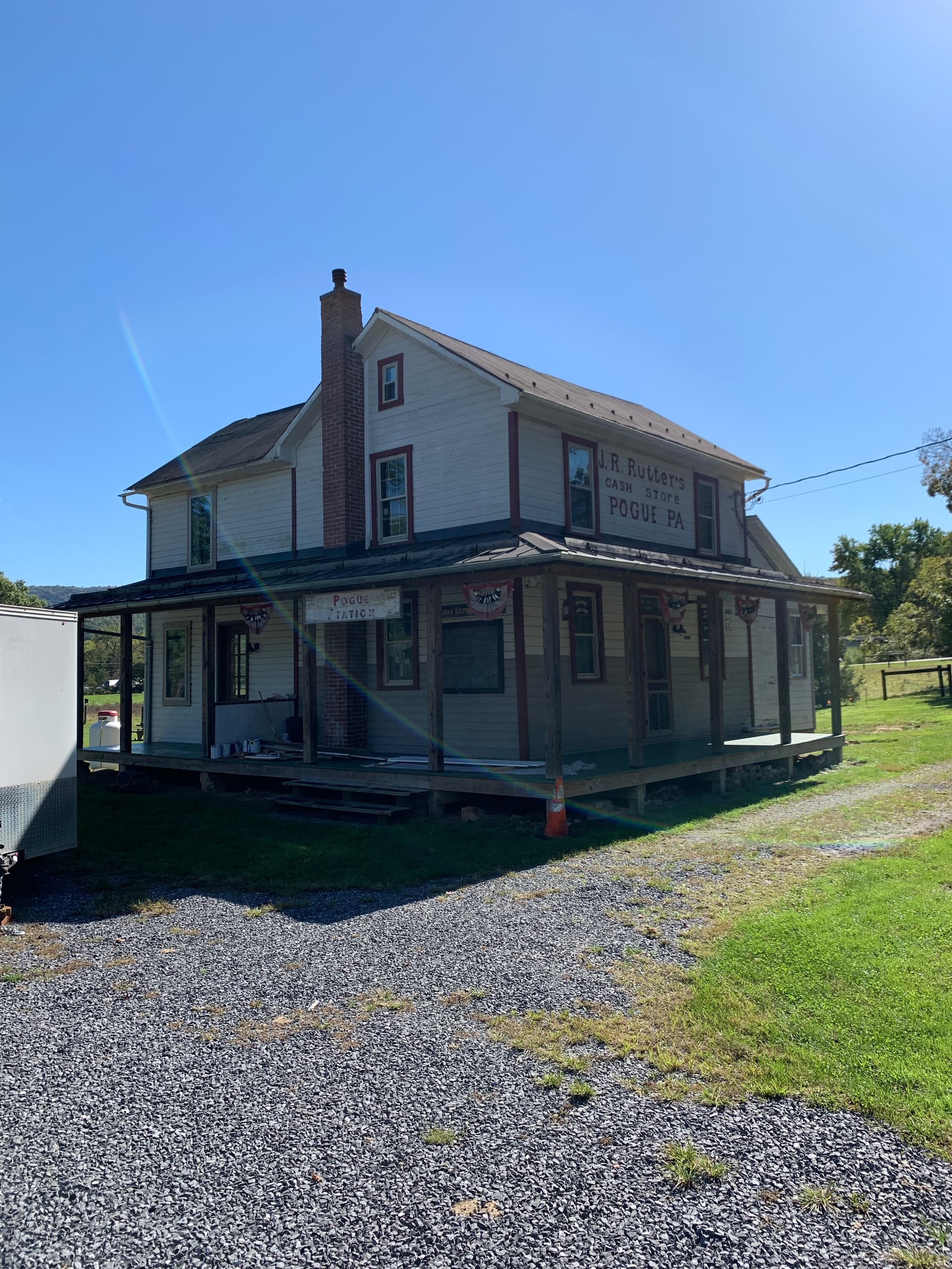

We are finally back at it working railroad south toward Three Springs starting just south of Pogue Station. While it was never a railroad owned station, it was a stop with a passing siding. Located just railroad south of Pogue trestle, the station is still owned by the Hoffman family who’s ancestors worked in the mines. They have remodeled it to include a nice AirBnB and a retail area for future development. The signage has said J. R. Rutter’s Cash Store for many years.

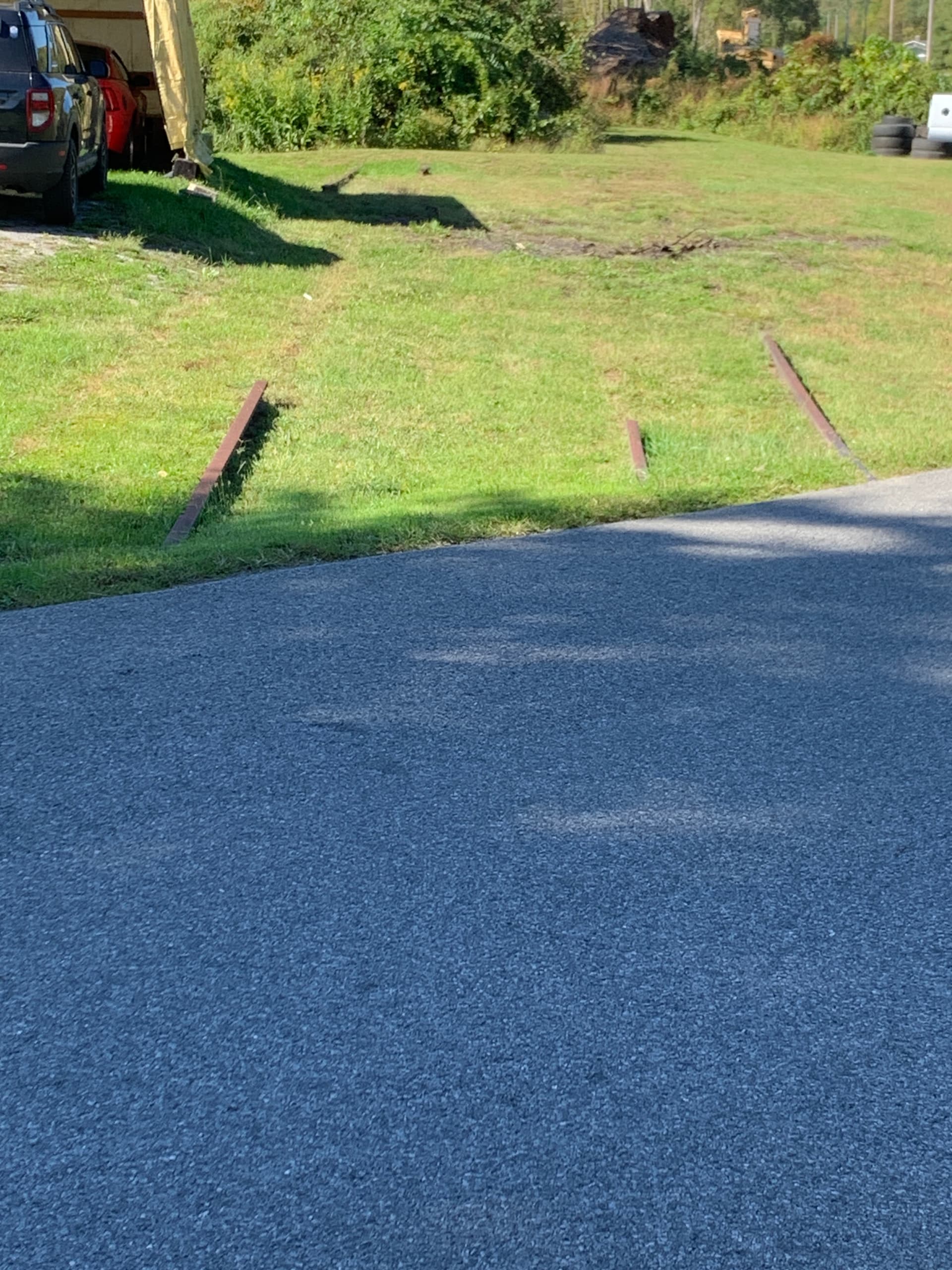

Later in the morning, we traveled to Pogue and began laying track South from the south side of Spring Creek Rd. The old rail here is a bit difficult to deal with as it is vertically bowed. The first stick is attached to one embedded in the asphalt…
Pogue Station in the background. The AirBnB there is now open and one of our crew was staying there…

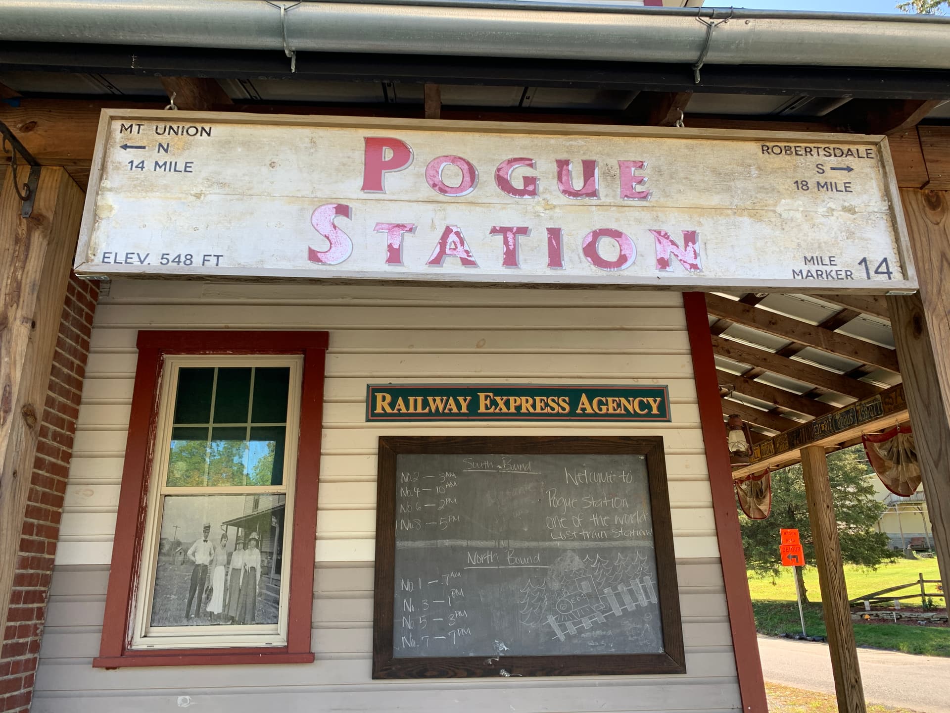

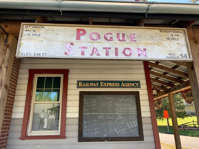

Pogue Station looking towards Rockhill.
Pogue Station looking towards Three Springs.
