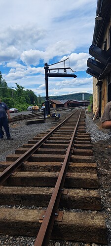

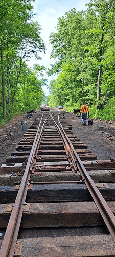

Back to track work: We laid out another 500 feet of track today in Saltillo and much of it was spiked up. Tomorrow afternoon, the first speeders to run in Saltillo since the early 1960’s will happen on the rebuilt track.
Today we finished up a 7 day track marathon (I only participated the last 4 days). When we called it quits around noon, over 500 feet of siding and 300 feet of main line were spiked and gauged.

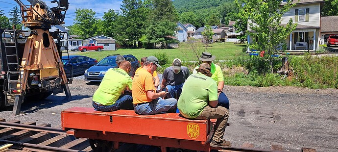

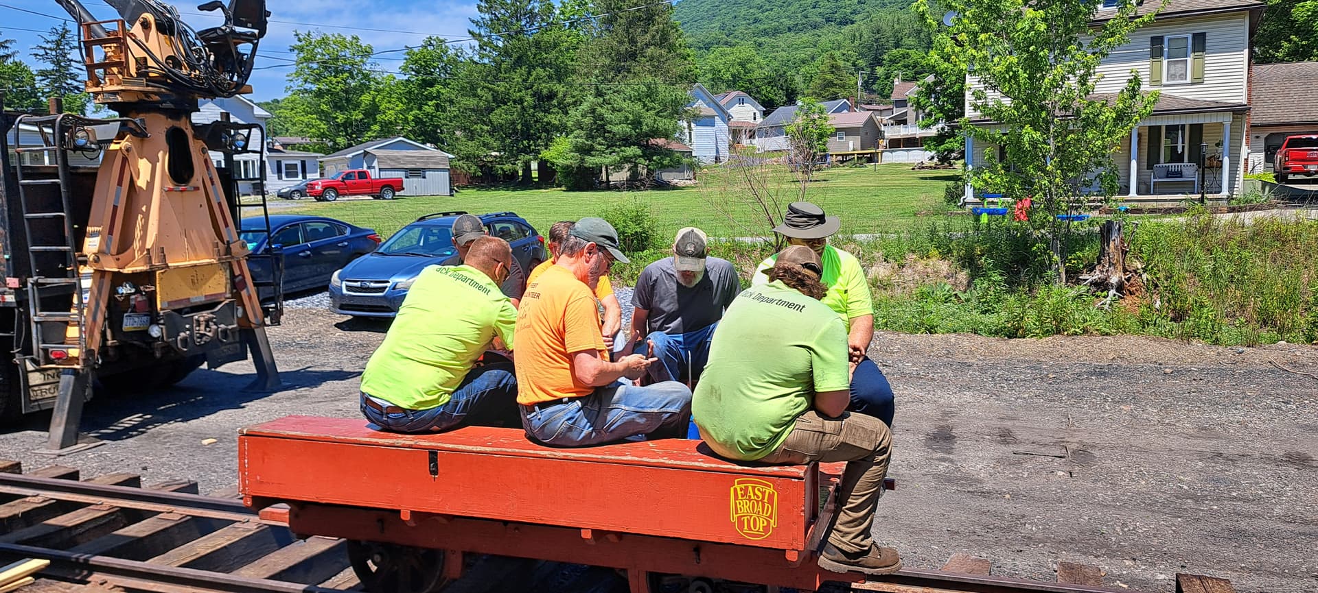

To celebrate, the EBTF Track Foreman brought down the “Flying Devil” speeder for track rides. I was on the first speeder to run at Saltillo since the early seventies/ Train service ended in 1956.

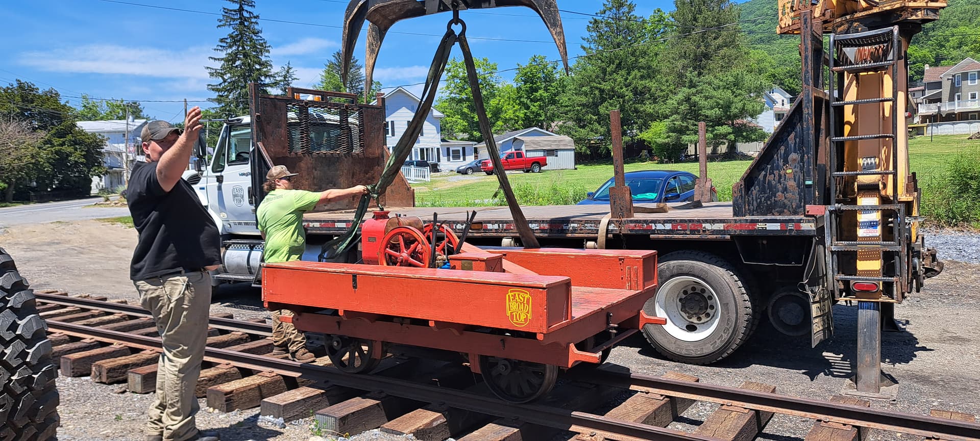

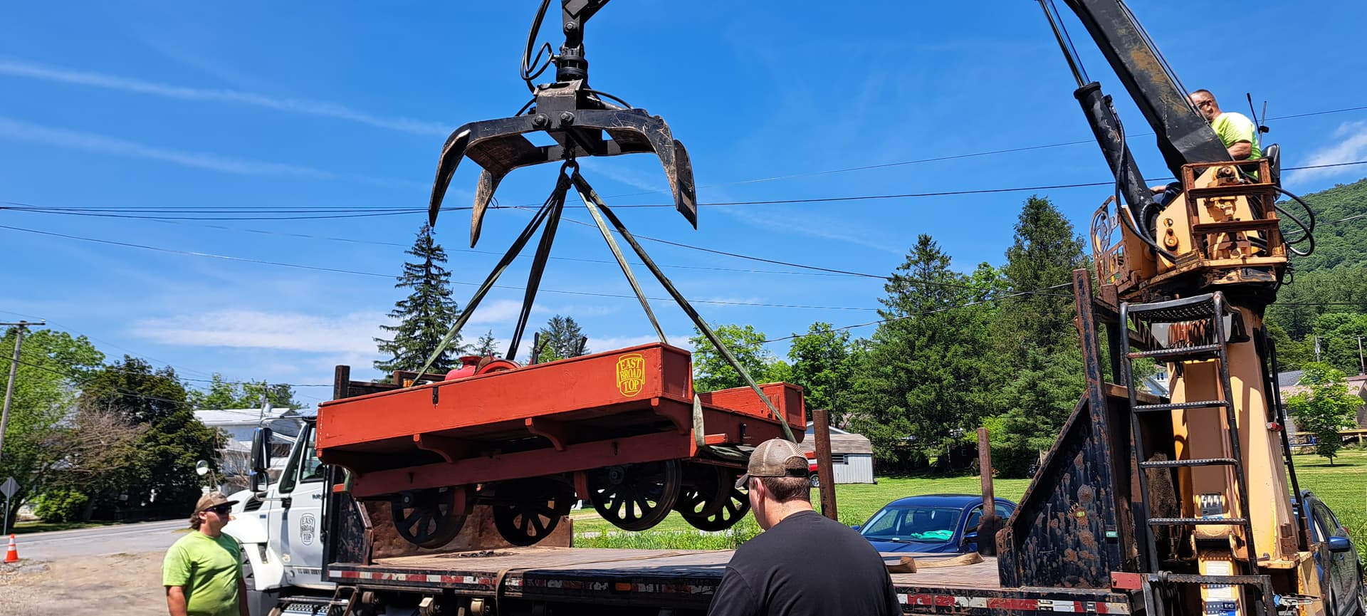

Henry and Zane, the EBTF track crew assisted by Al of the FEBT unload the speeder from the EBT’s Prentice truck…
As part of the crew that built this track I was fortunate to get the first ride on the new track. Here is another group of volunteers taking a ride…

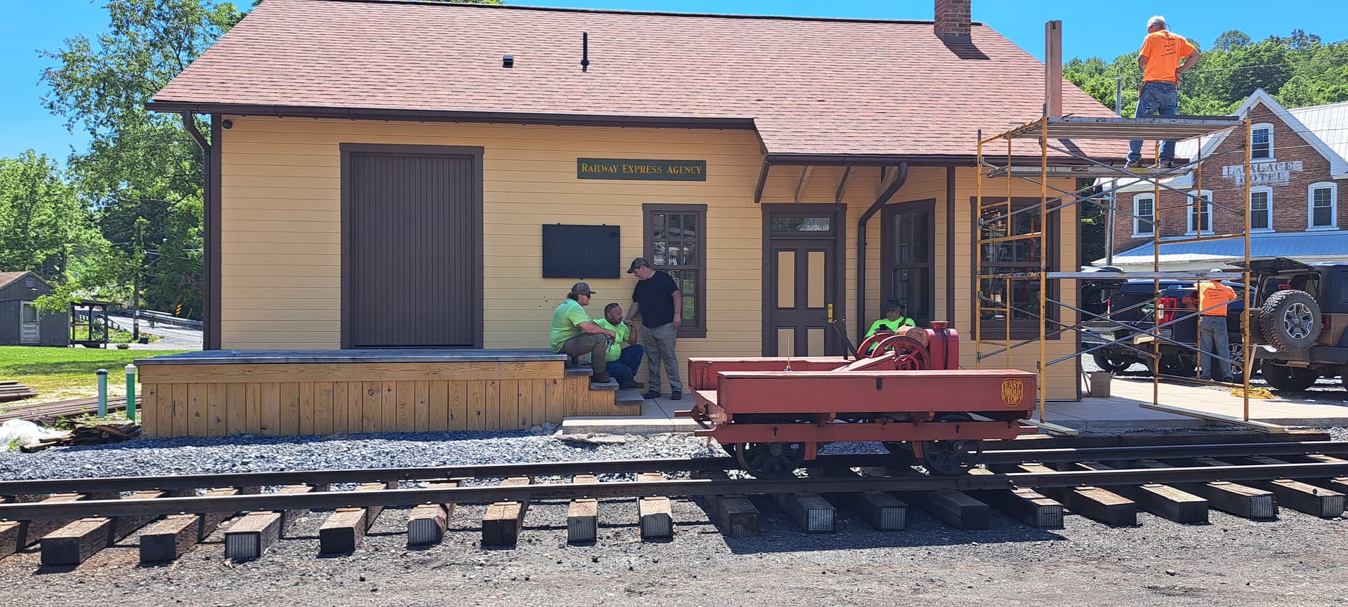

The speeder parked in front of the recreated station. FEBT Volunteers have made great progress finishing the interior as close as possible to the original. Here volunteers are building the mount for the original , to be functional, order signal…

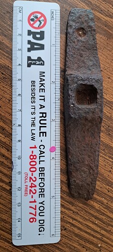

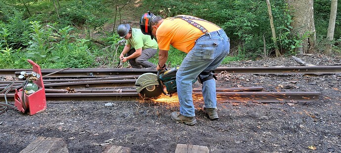

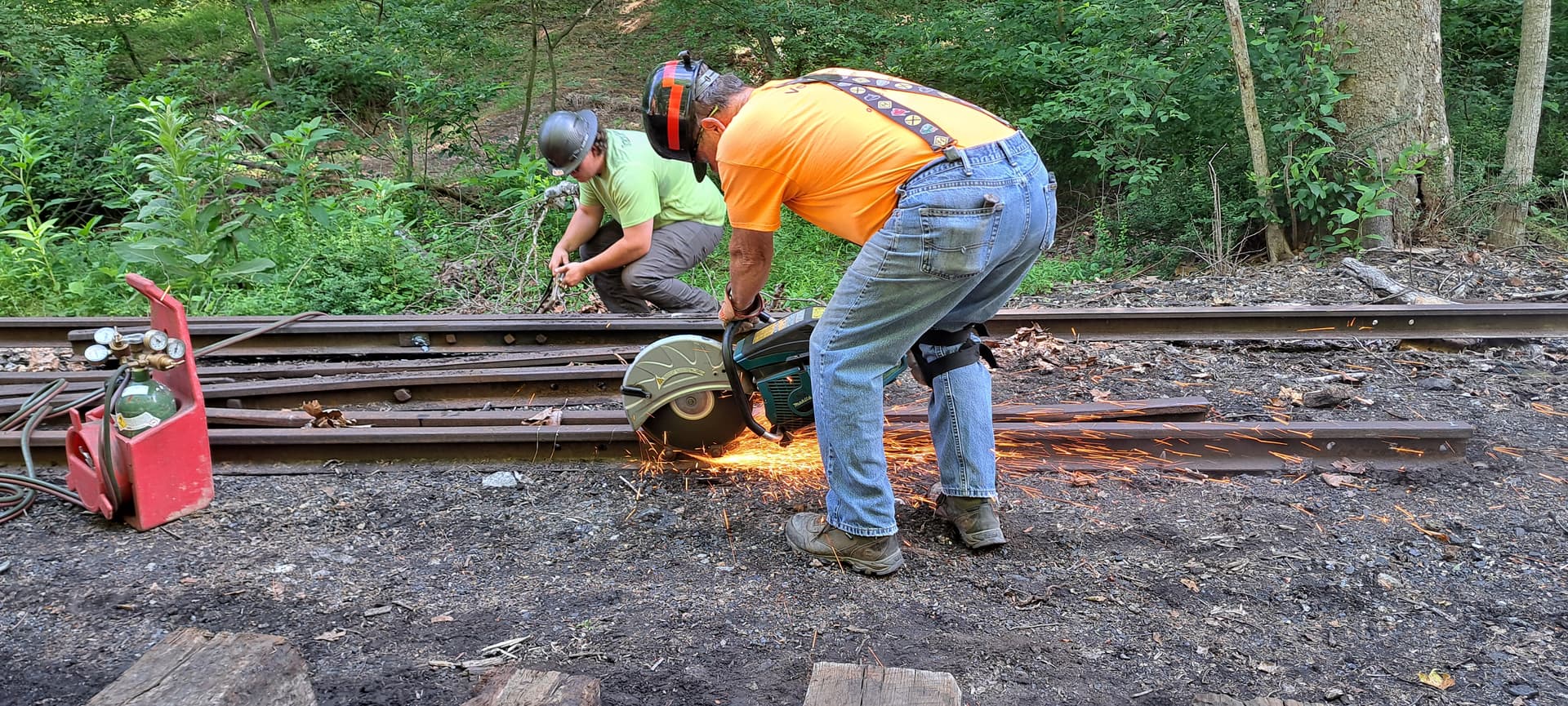

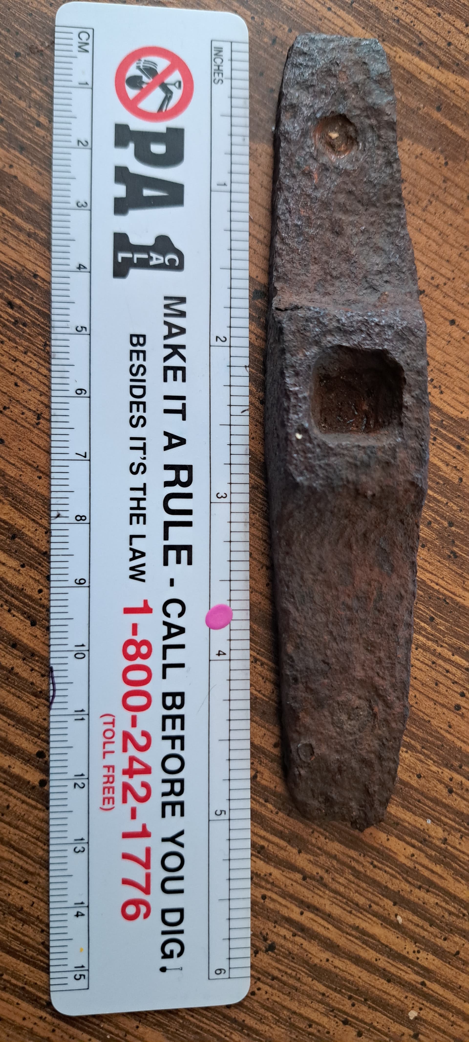

One of the “perks” of doing track work is the ability to collect rusty junk from the old roadbed. I’ve collected old short pikes and lots of nuts and bolts. Last week, we cut off the damaged end of a rail and I was given the cut-off for my rust garden. I also found this unidentified piece of hardware…
No one I showed it to knows what it is. It at one time had at least two holes on the ends. The square center indentation may have gone through, but is now rusted solid. I don’t think it is from any “modern” Siebert era steel cars, but could be something from the earlier wooden cars.
Speculation welcome!

As for that piece with the square cutout it looks like a handle that went on top of a crank valve. (only an example) like the stem valve on top of a fire hydrant or perhaps a brake lever or something of that nature. Could also possibly be a Pennsyltucky backwoods boomerang.
Very cool. Maybe related to a switch stand?
Pretty small for that, but who knows!
I attempted to break the rust out of the holes, but after at least 70 years basting in coal dust, it wouldn’t budge.
A blacksmith told me once that soaking in molasses solution removes caked up rust. Tried it once on an old pin and it cleaned up really nice. Took a month - well, that’s how long I left it…
Might be worth a try?

Were you painting your toenails 3.75" in ?
Cool. It’s going to end up in the garden. I don’t really need to open the holes for that.
For fun, I uploaded the picture to Gemini and asked for identification. At first it thought it was probably a part of a farm implement, but when I explained it had been found on an old railroad grade with rails first laid just after the civil war it changed it’s opinion. Now it thinks it is a rail component from an early switch.

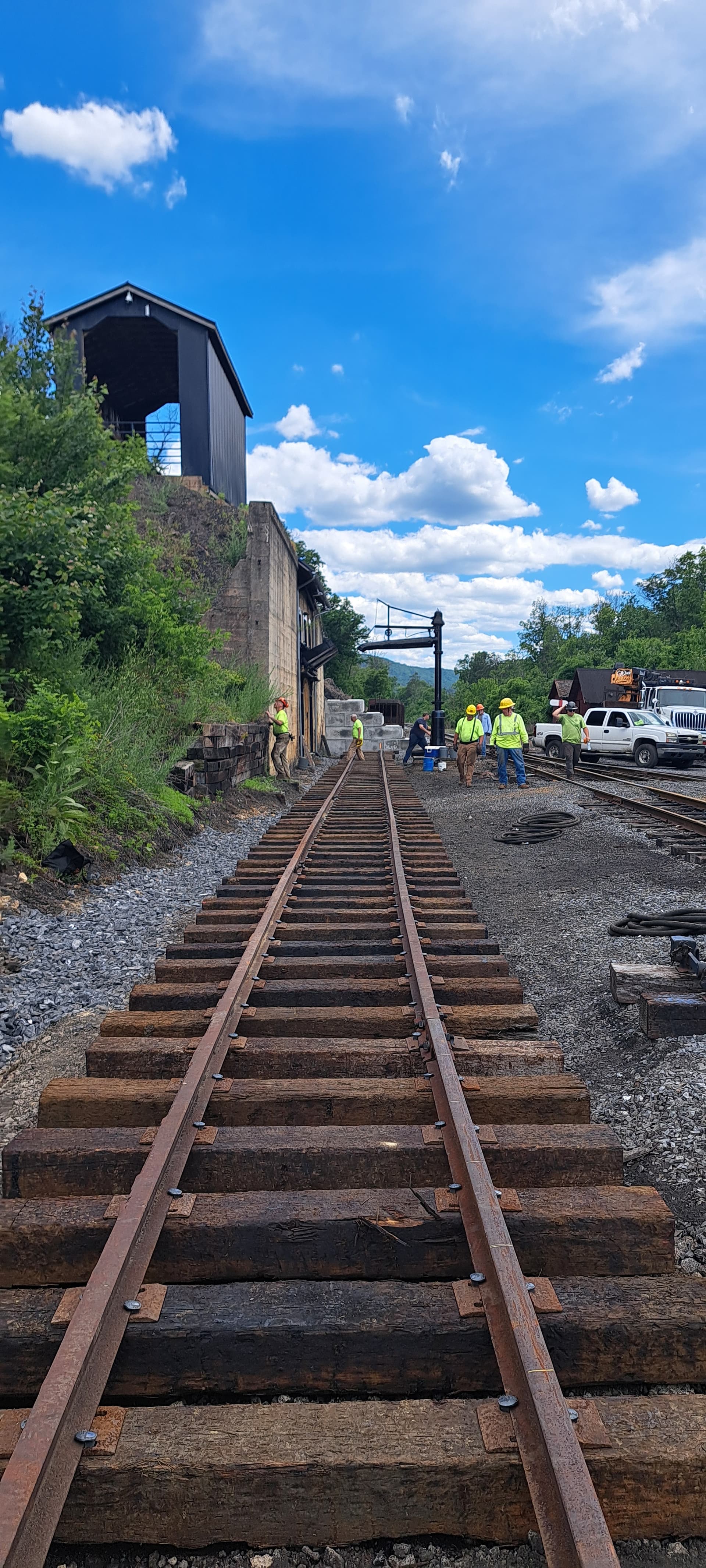

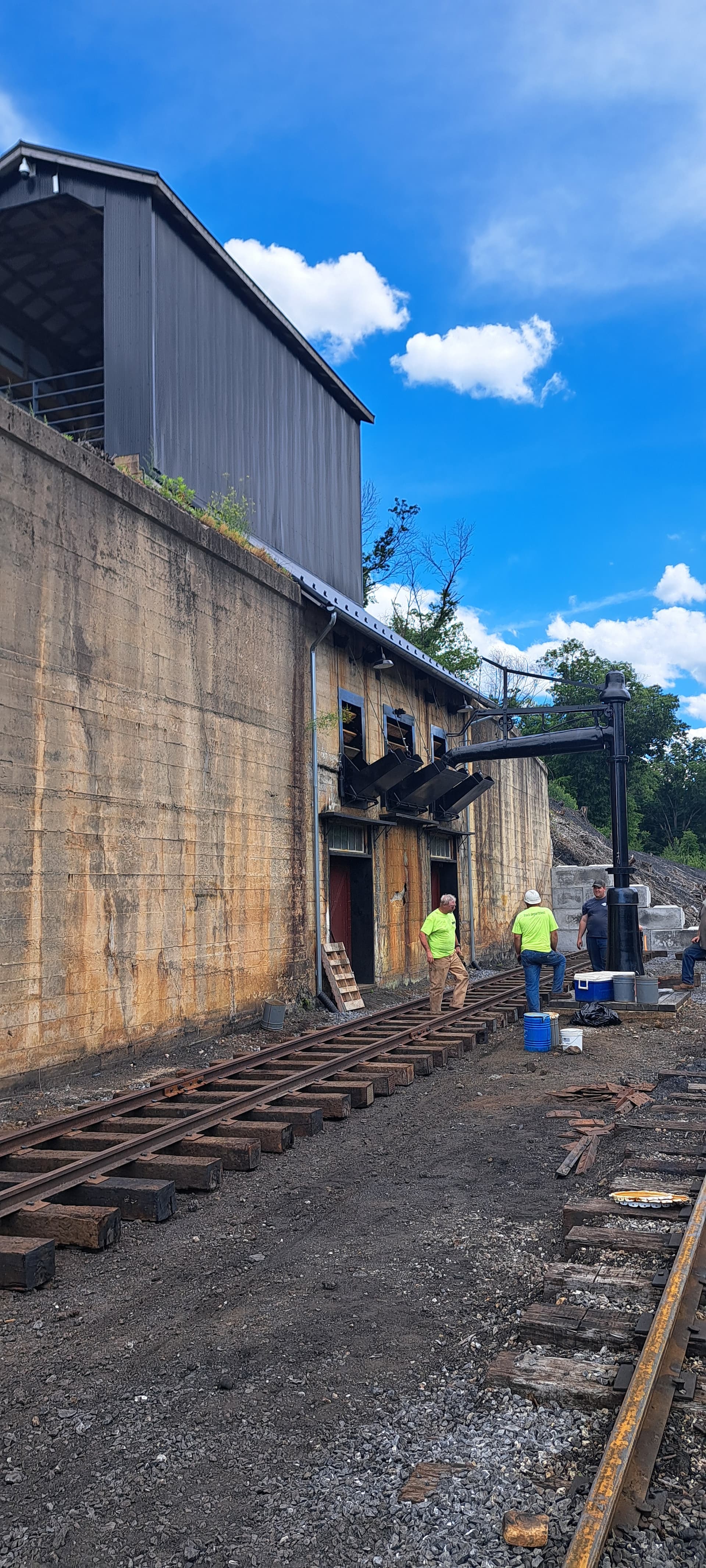

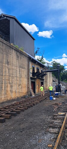

We were back at it today. This time in the Rockhill yard restoring the coal dock lead. Once ballasted and tamped the engine service facility will once again be fully operational.
Next week on Thursday we will be back in Saltillo to build another kit switch.

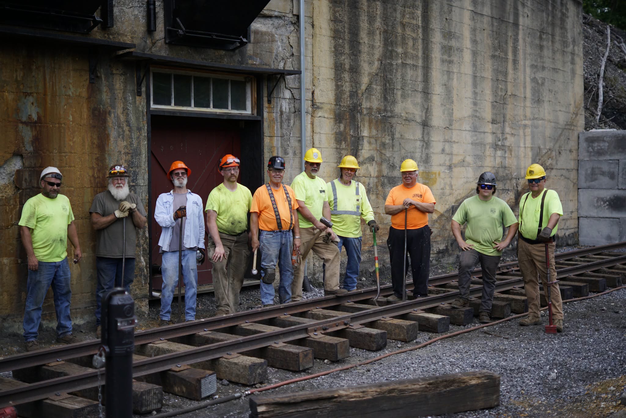

The “official” crew photo…

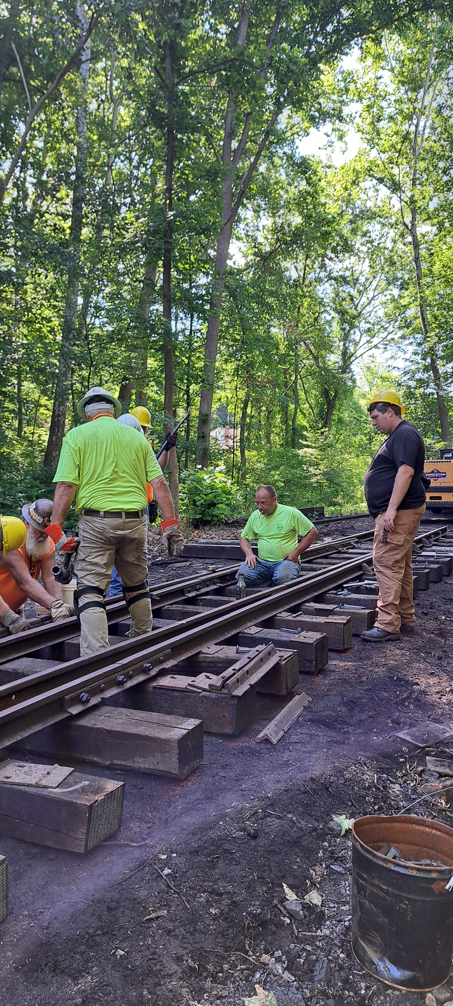

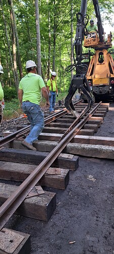

This week we were back in Saltillo building another “kit” switch. This time for the NARCO siding. We didn’t quite finish in an 8 hour shift.
After stettig out ties we start with the two stock rails and the points…

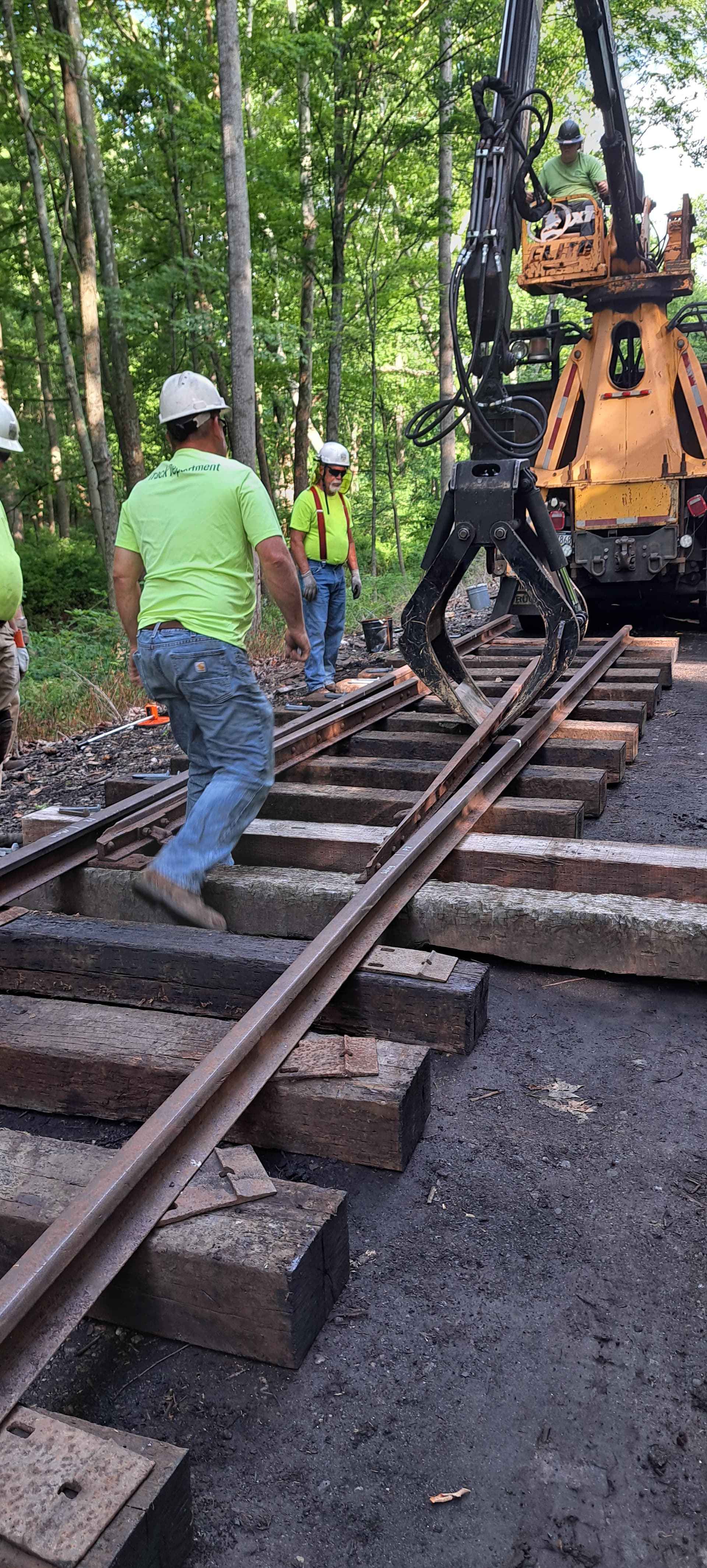

Henry Long, the FEBT Track Foreman, scopes out the alignment as rails are joined…
Daniel Lane cuts the bolts attaching the guard rail while Zane Esposito (EBTF Track Crew) supervises…

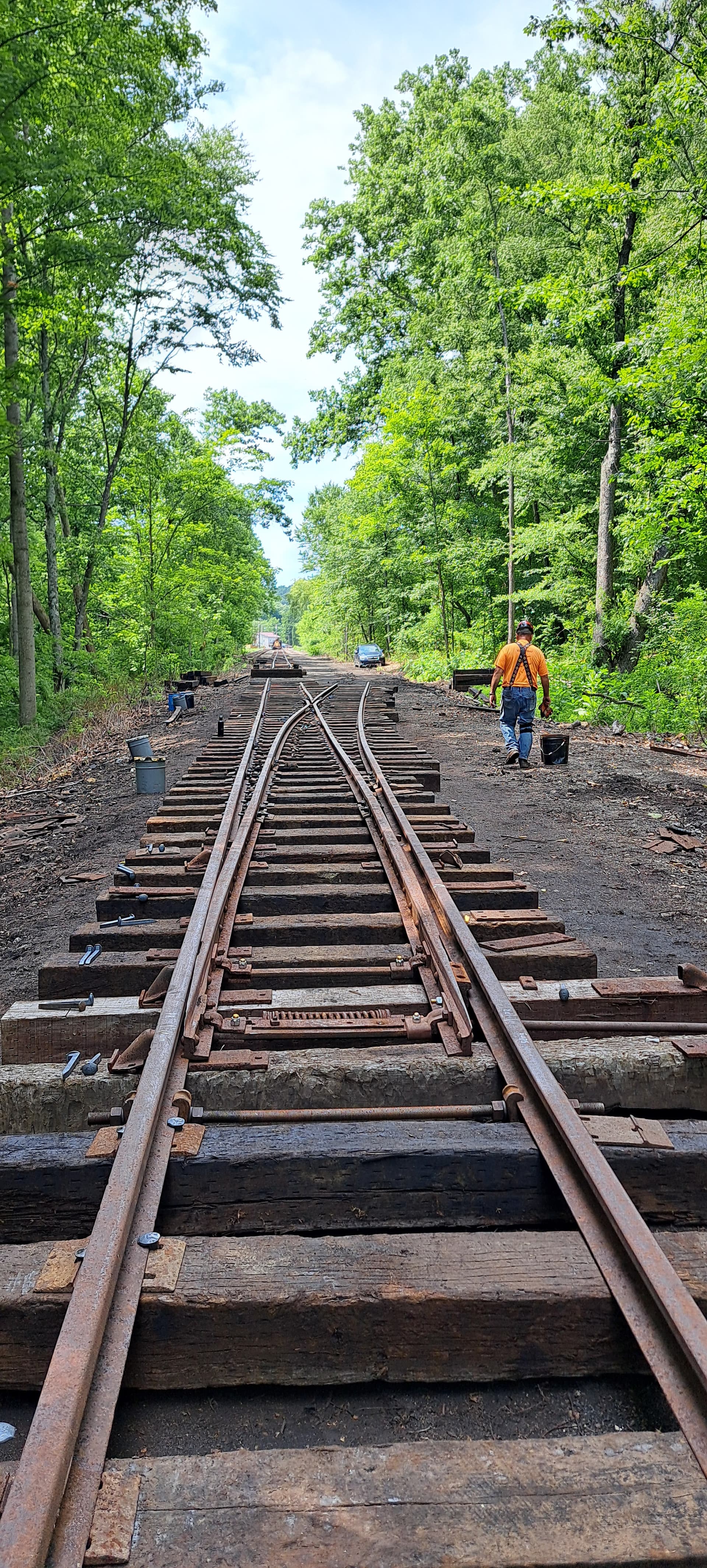

What we had accomplished by days end. Beyond that pile of ties is the main leading to Saltillo station. It will be connected on our next session in Saltillo…
