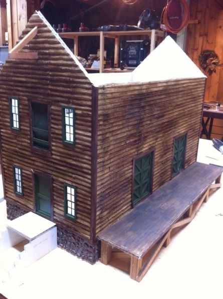

Here is the latest. I’m almost done. I have to install a corrogated tin roof (which means I have to drink more pop) and finish the dock and front porch.
IMG[IMG]
IMG[IMG]
IMG[IMG]
IMG[IMG]
IMG[IMG]
I figured out if I buy the Bud Light Cheilata (sp?) and drink that, I can get more than one scale 4 x 8 piece of tin roofing out of the can. I also saw that Fosters makes their can’s oversized. I might have a few fun nights a head of me. :slight_smile:

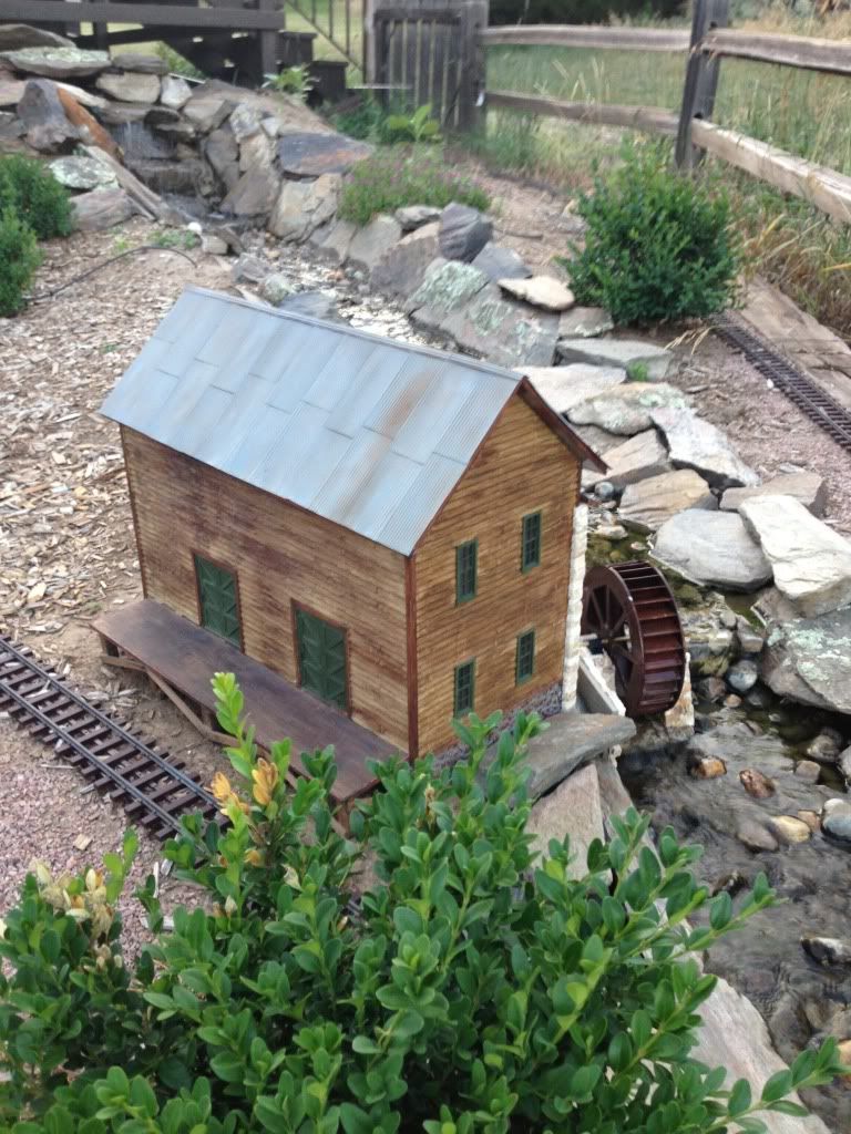

I guess I have been lacking in this build. Sorry about that, its been a busy summer.
img[img]
This is a picture of the building in place. My first one on the railroad, yay!!!
The changes from the last photos are it has a roof on it. That was built using the same material I used on the walls as a base. I then used the paper crimper and pop can technique to get the roofing material. I installed two magnetic cabinet latches to the roof and walls to allow for the roof to be removable. The magnets are pretty strong and I’ve already had a pretty bad storm go through and it couldn’t blow the roof off.
You can also see the water wheel placed in the water. I used that stone tile I had talked about earlier in this build, for the walls. I made a shell of the tile and then poured cement into the cavity so the wheel supports are solid.
img[img]
This from the other side. You can see the water wheel better. I still need to build up around the water wheel to cover the gap between the wheel wall and the building. I’ll probably use some more of that tile. I also need to detail around the building with people and clutter.
Here is a short video of the water wheel working"

Very nice. Great work. I even learned a few things. :slight_smile:
Great looking mill! It fits well in its setting.
The video is terrific with the under shot wheel turning.
Damn nice work Jake!
I love the skewed stone section
