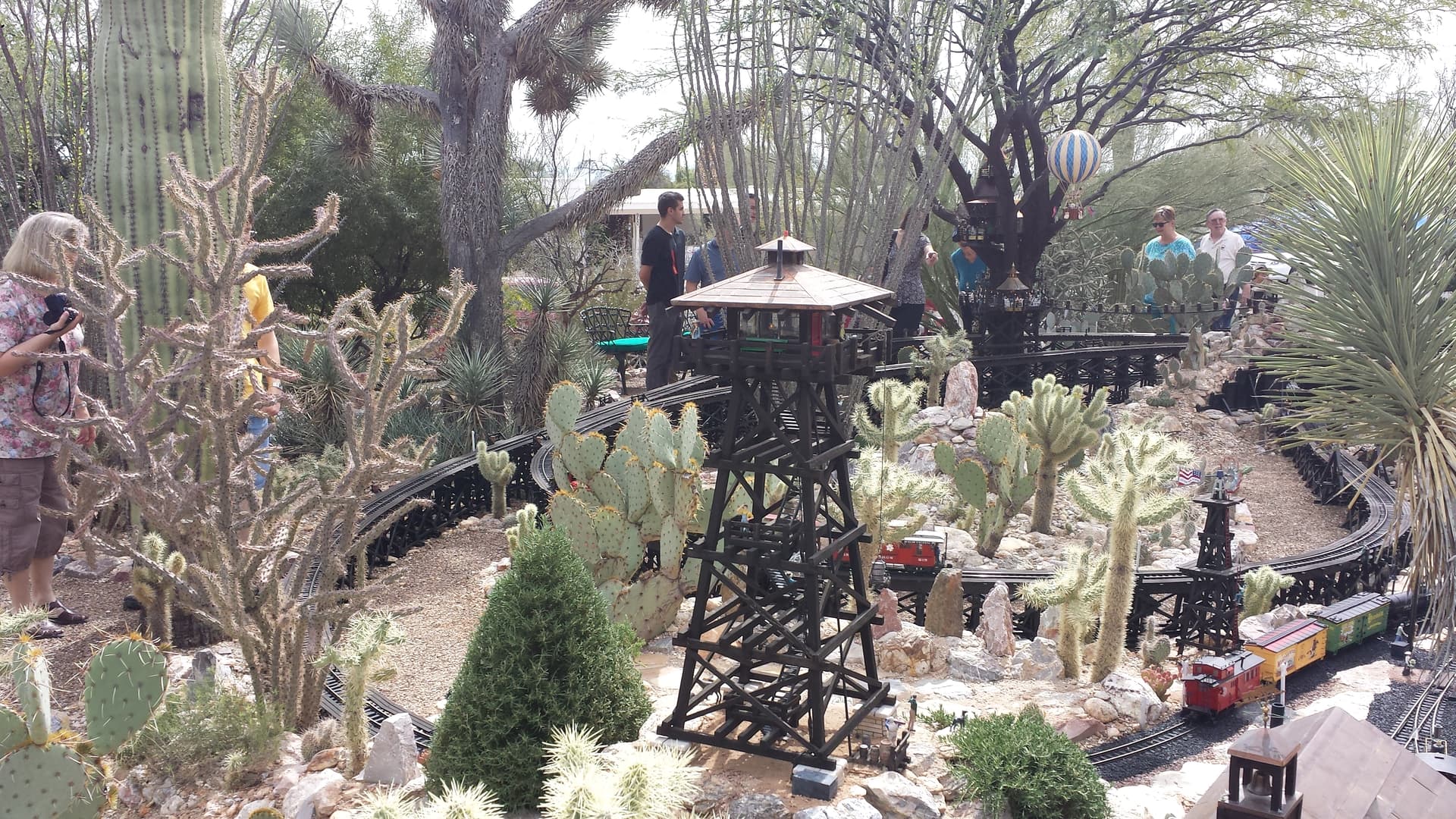

I have been to the Cholla ( for the rest of everyone but me , John Miller, and Boomer,its pronounced Cho yuh not what you are thinking) Patch railroad and the trestle work is immense , huge, impressive, add to that the metal( I think) buildings and all the various cacti
you get an impressive layout in a front yard the lookout tower has a great scene, at the bottom of the tower there is a bloody figure impaled on the barrel cactus with people looking down and I think there is rescue people trying to figure out how to get the dude out
