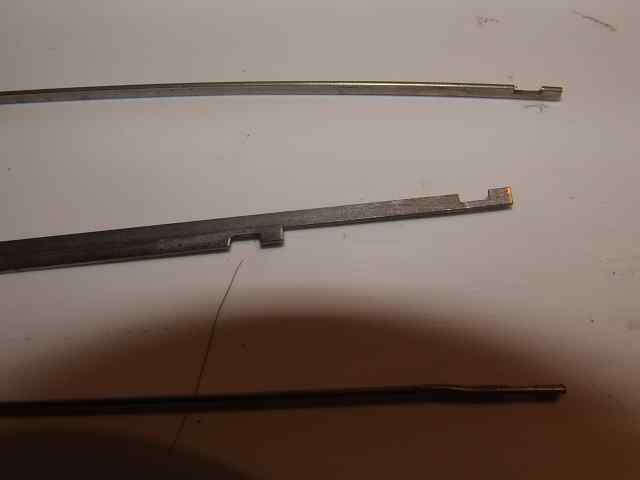

A lot of us that build Ted Stinson’s GR mag plans have wondered where to get this flat-wire that he continually refers to. I think he’s using brass strip, which is sometimes not too flexible & is certainly expensive. I reckon I’ve found the cheapie answer!

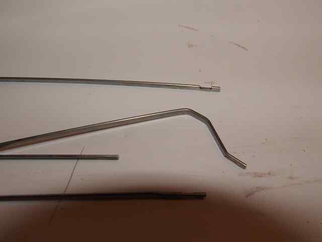

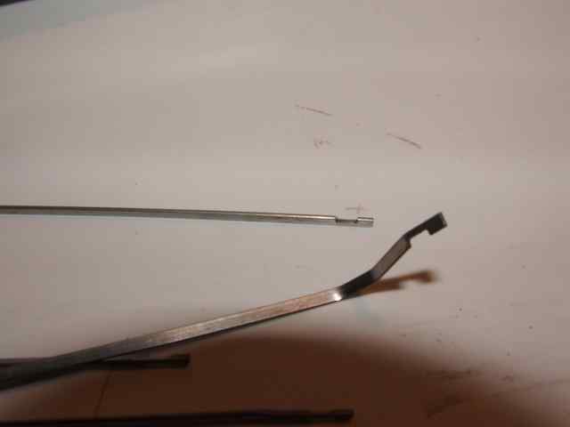

Recognize it? It’s the metal strips out of your old windscreen (windshield) wipers! They bend pretty well…
…& God knows, they’re cheap!
Check the car dept in K-mart etc.
