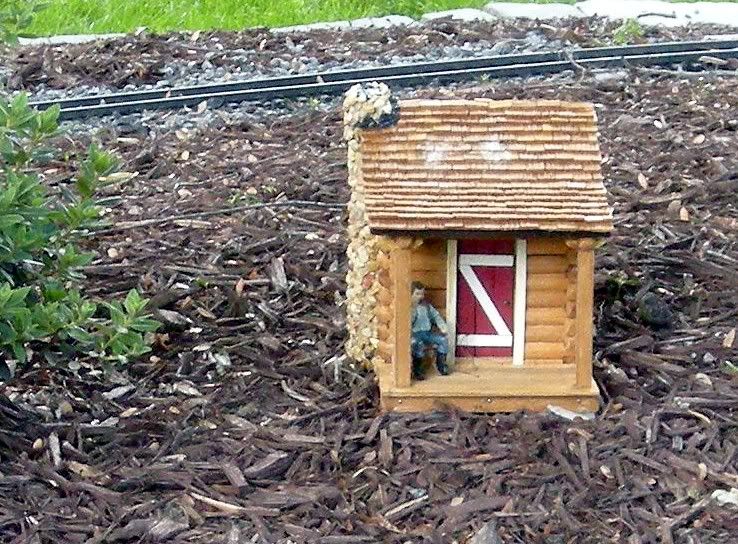

I’m building a Timberline kit with a cedar shake roof but it has a flat-roofed porch. What did they do for flat roofs in the early 1900s? My thought would be a “rock roof” using sandpaper but are there any other thoughts?

Hey Doug, which Timberline kit has a flat roof? The ones I have put together all have a bit of pitch to the roof. If it is supposed to be a flat roof, you could use spray rubber on it to simulate tar. Its usually in with the spray paints in the home box store. I have used it a few times for flat roofs.

Get a piece of the stick on rubber roofing, would look good and hold up well.
The Timberline kit is The Pioneer. I thought that maybe since I’m legally blind that I had missed something in the directions but I don’t think I did. The cabin itself will look fine with the cedar shingles. It sounds like either the spray or the stick on rubber roofing are just what I need. I’ll see what I can get in California.
I have done 2 pioneers. There is a small pitch to the porch roof. The plywood sub roof is angle cut to meet up for the pitch. I cut some support blocks to go on top of the porch rafters to support the roof on the back side closest to the cabin.
