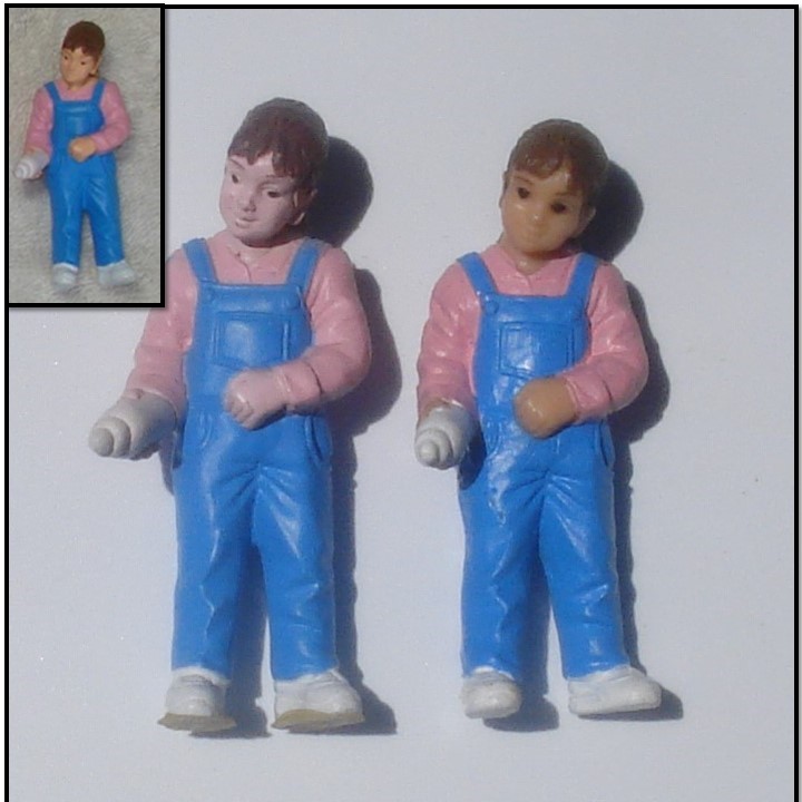

January 1st 2020: End of Project Summary
Well here we are at the end of the year. It has been a brutal New Mexico turn. A below average snowfall and rain meant an above average number of clear sky days with lots of UV and wind. I think a few animals got their licks in as well.

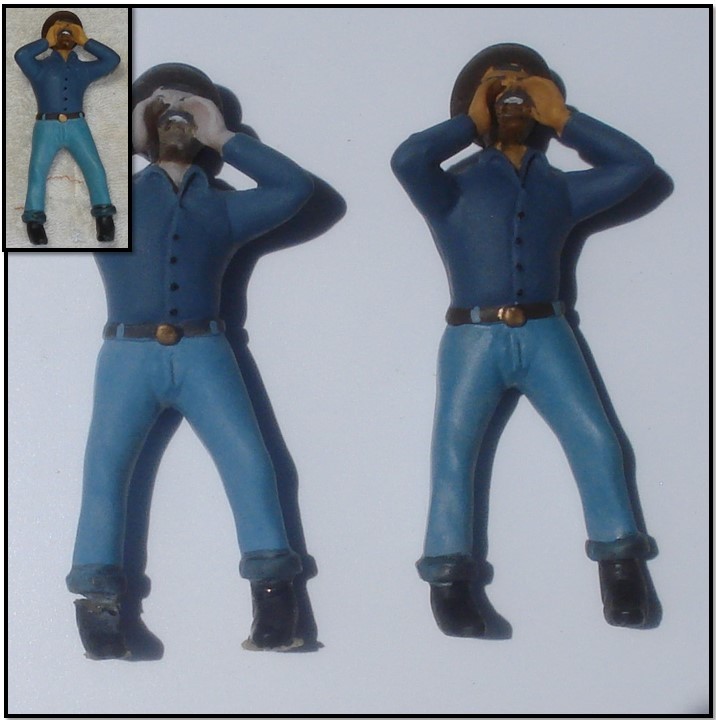

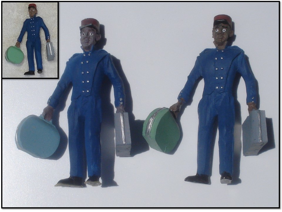

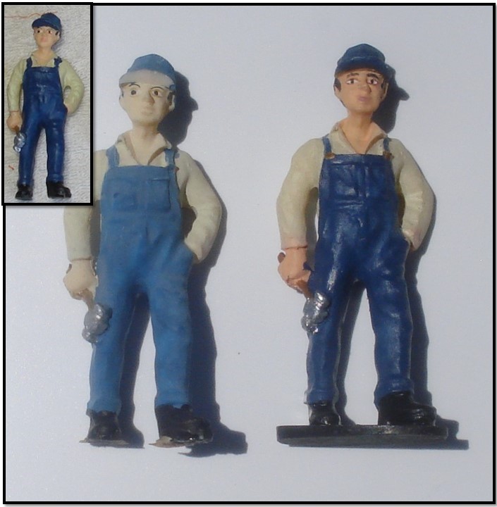

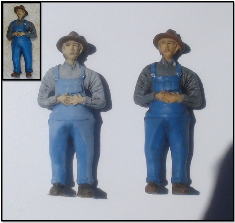

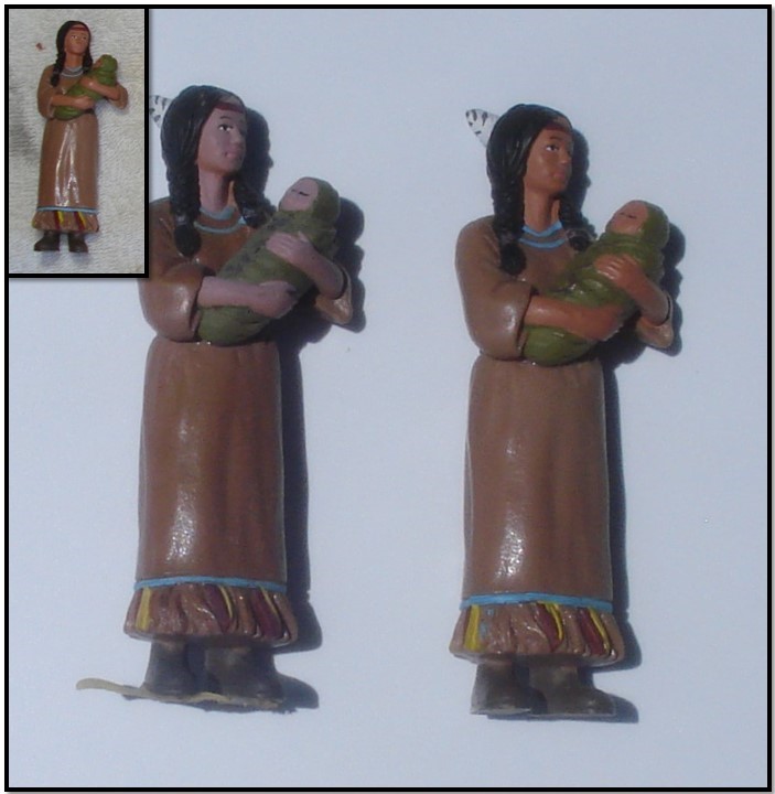

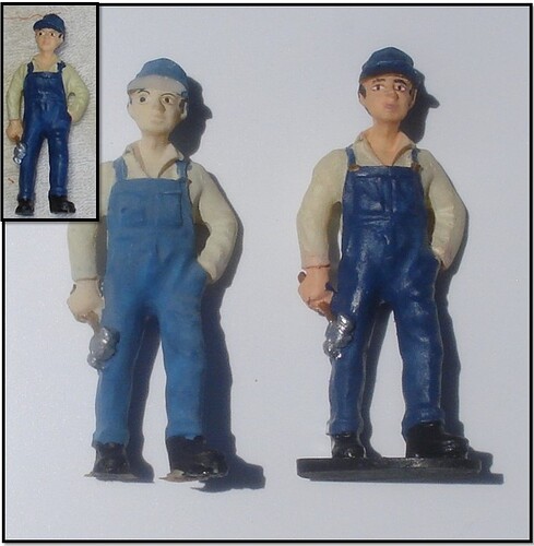

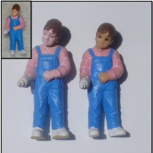

Below you will find side by side (new versus the test subjects) comparisons for six of the figures. I could not find new versions of the other two. The most telling damage is from UV. The broken pieces are from meteoric hail strikes and not deterioration. Note that all test subjects are on the left. The inset picture is the test subject in original condition.
My observation is the most durable figure was the Woodland Scenics baggage handler. His blue uniform, red hat and dark skin are still very close to their original colors. Only the suitcase in his right hand faded significantly. The only damage of note is the bill of his hat.
In second place is a tie between the the two vinyl figures. I was surprised at the amount of oxidation on both figures even though the fading was slight. You can see it distinctly on the Mojo Indian girl. Note that the Schleich figure test subject had painted skin. I could not find one like that so I went with a molded skin color version. Nice thing about these is they don’t break. The line however is mostly 1/24th scale with few choices for 1/20.3
In third is Fun and Games with a mostly intact lumberjack. You can see that the paint held up well except for notable changes in the face and hands. This figure is epoxy like most of the others. It suffered a lot of damage and seemed to be exceptionally brittle. It was glued back together several times.
Next we have a workman from Just Plain Folks. With this one you kind of have to hold your tongue just right. There is so much variation in the production of the JPF figures that not all of the change you see is from the test. The most notable is the fading of the blue clothing.
Last place goes to Railroad Avenue. Everything on this guy faded severely. You can see their is also a weird discoloration in his crotch where it looks like the figure exuded something.
In addition to the UV fading several of the figures have whitish oxidation on them which I suspect is lead oxide. These are all made in China (except for the Prieser and Cheaple figures) which has been found to still be using lead in paint and children toys as late as 2018. Probably should not let the kids or pets chew on them.
One comment on the Cheaple figure. I cast and paint these myself. It is not really a commercially available product although I have sold a few on E-bay. The paint I use is Vallejo Acrylic Enamel, which is a commercial product and a damn good one. You will notice that this water based hobby paint not only held up for a full year without peeling or flaking but it did not fade much either.
I guess the best advice is “do not leave your figures out for extended periods” but if you do I recommend a location shielded from hail and shaded as much as possible.
