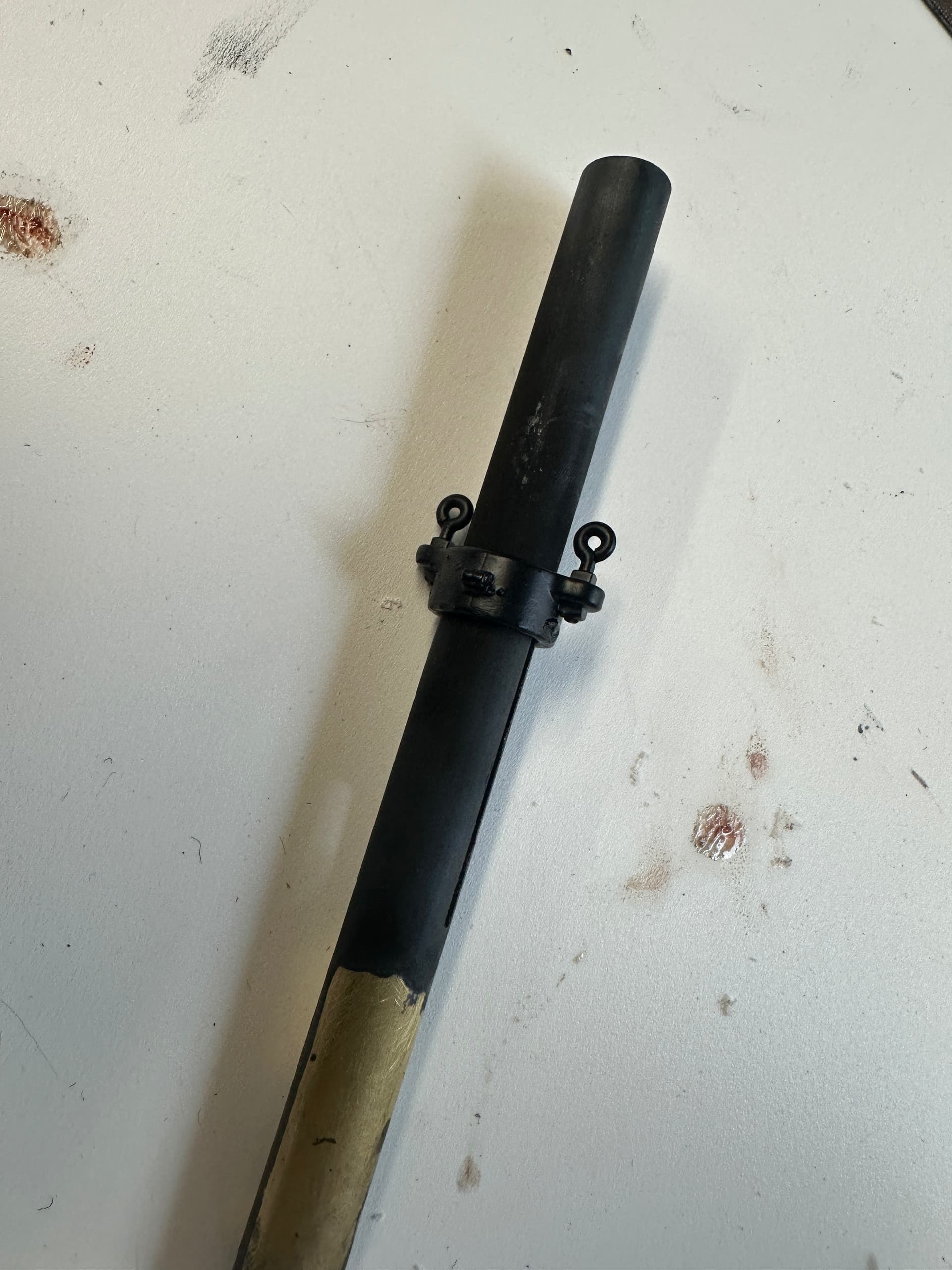

Column sub-assembly assembled. This tried my patience, getting the slot, the hole in the counterweight, and the holes in the outer ring all lined up. But its a neat design.

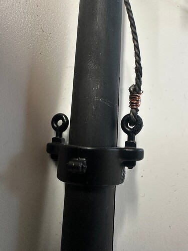

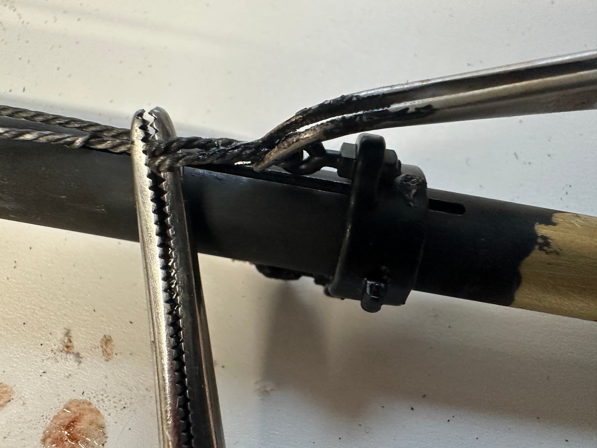

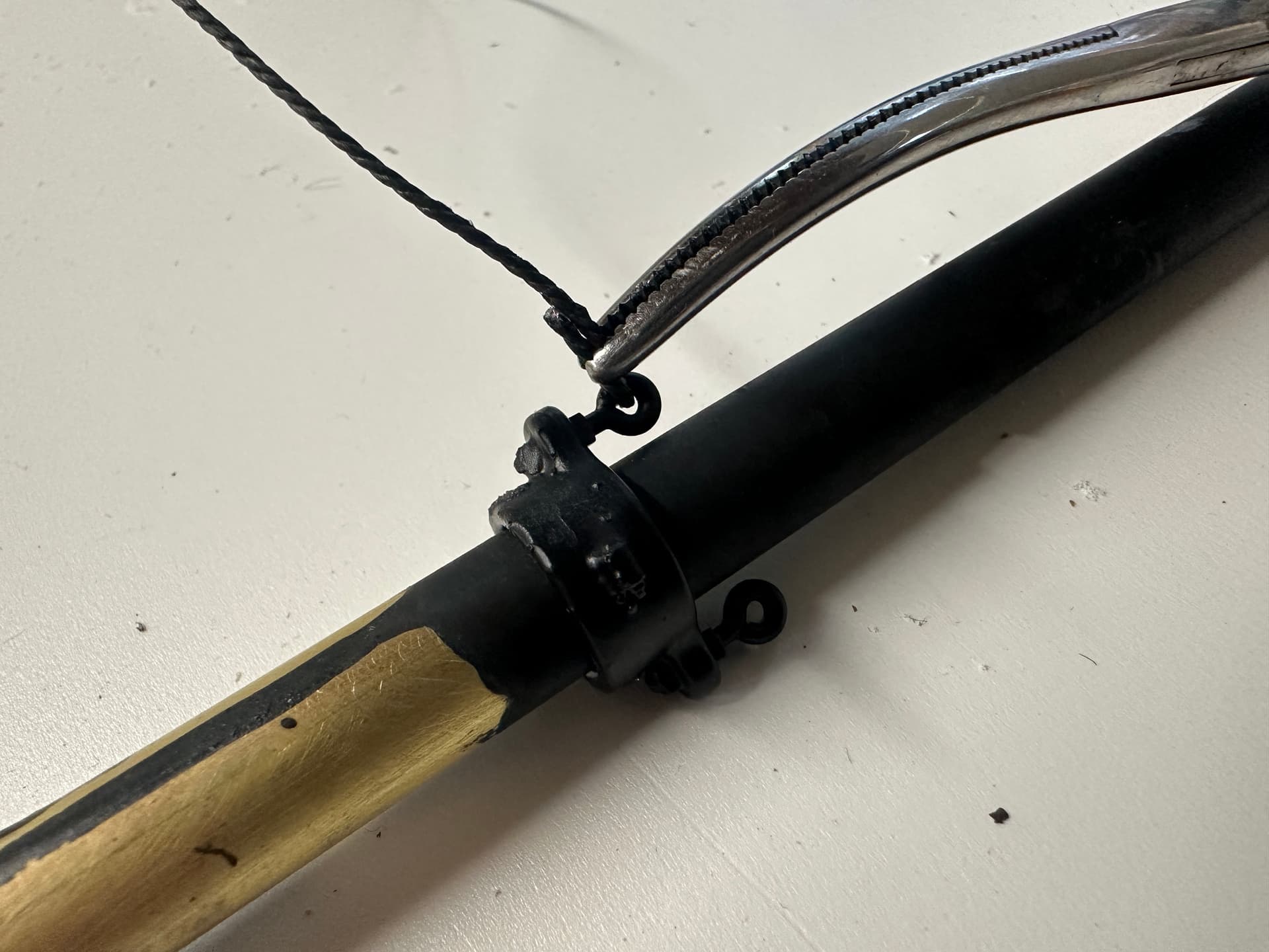

Adding the weight cabling. You attach it to the outer bracket for the weight, up over a couple of pulleys, through an eyelet on the spout, back through two more pulleys, and attach to the other side of the outer weight bracket.
Forceps and some ACC get the cable bent correctly, then some fine strand copper wire wrapped and tied around the cable makes for a tight fit.

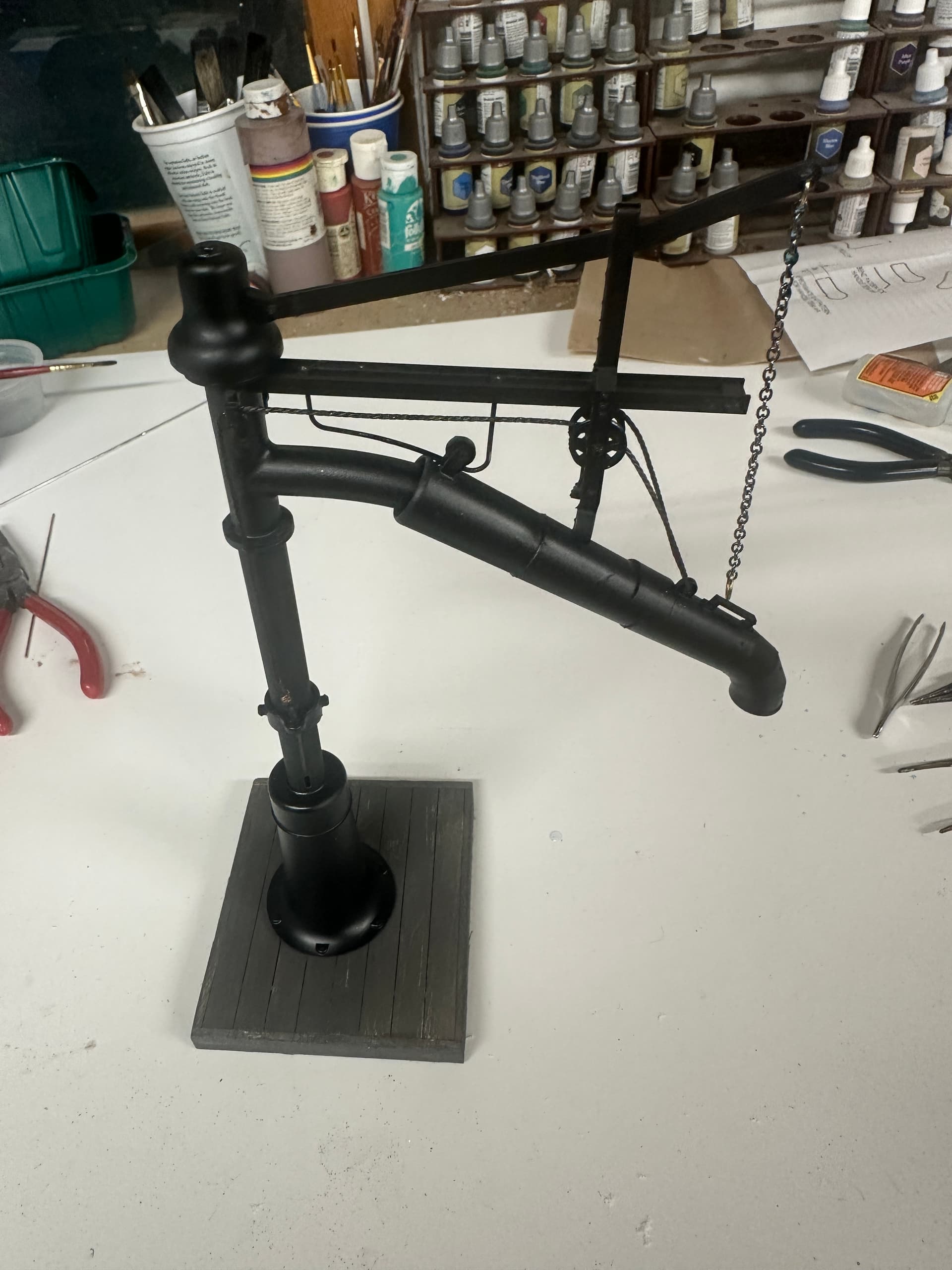

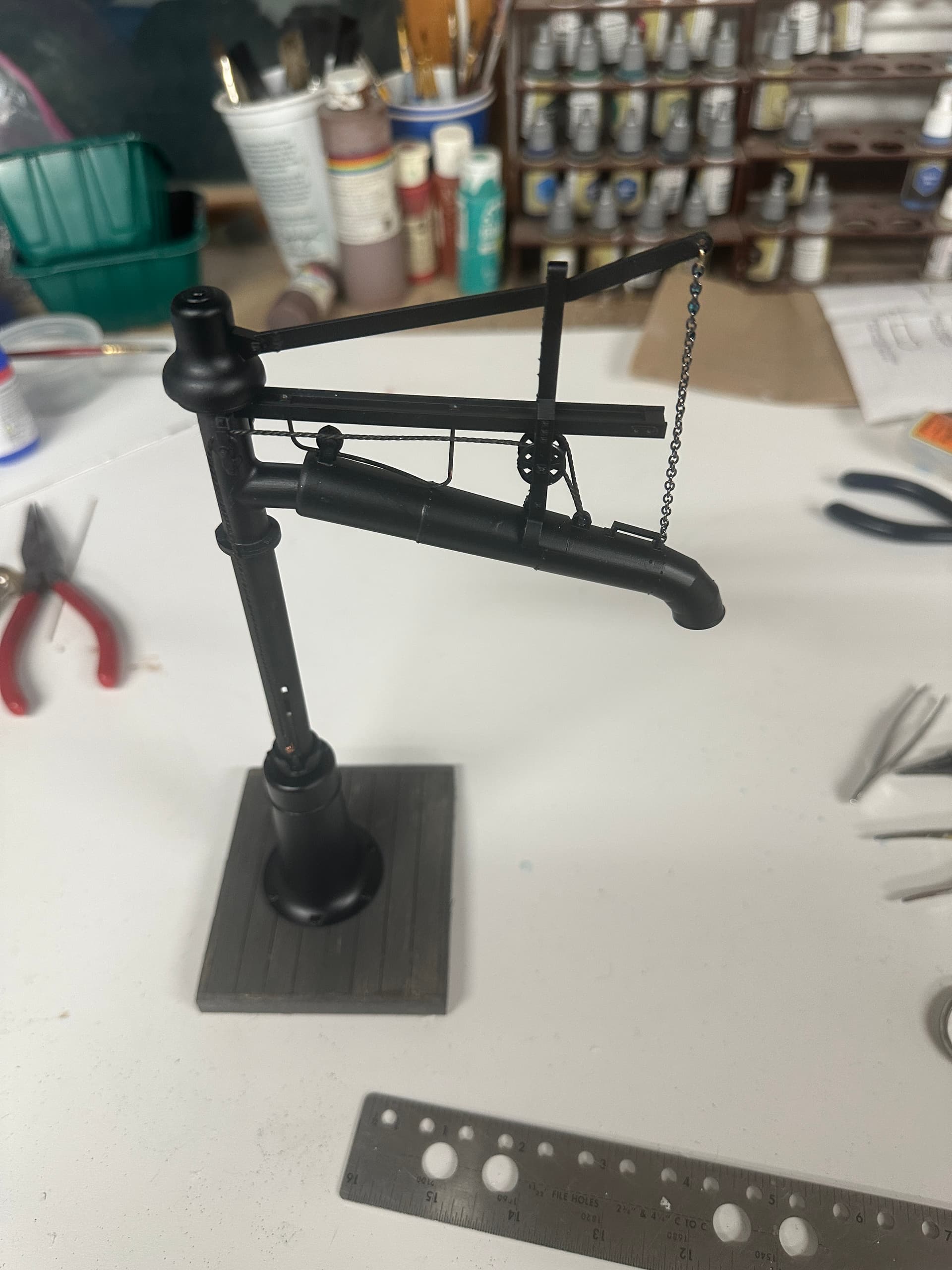

And, done. A fun little kit.
